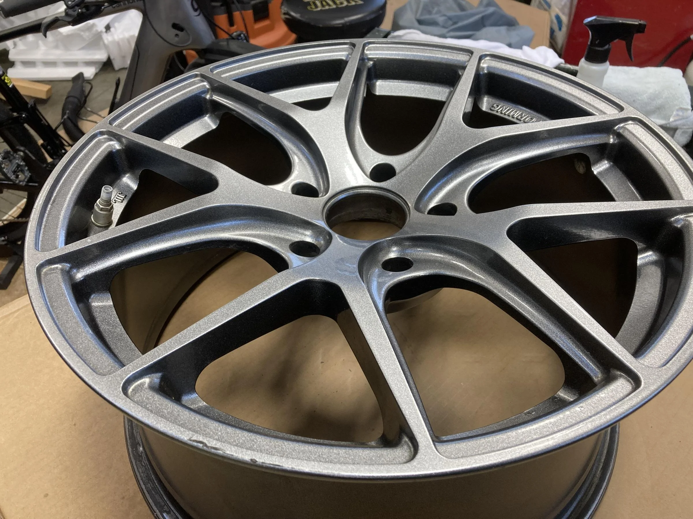

THANKS.You can continue to use the stock tires on those wheels. Most critical is that the wheel diameters are the same. Wheel width is a bit more flexible. In any case, you're fine with these 18"x8".
Those are nice looking wheels, but as I've posted before, I don't like wheels that have two sets of lug holes (notice that wheel has 10 holes). There are 5 holes at the bolt circle diameter for your Mav, and a second set at a different diameter. This is so they can sell one wheel for two different applications. But I find it annoying when doing a wheel swap (I change twice a year; summer/winter tires). I will buy only wheels with a single set of lug holes.

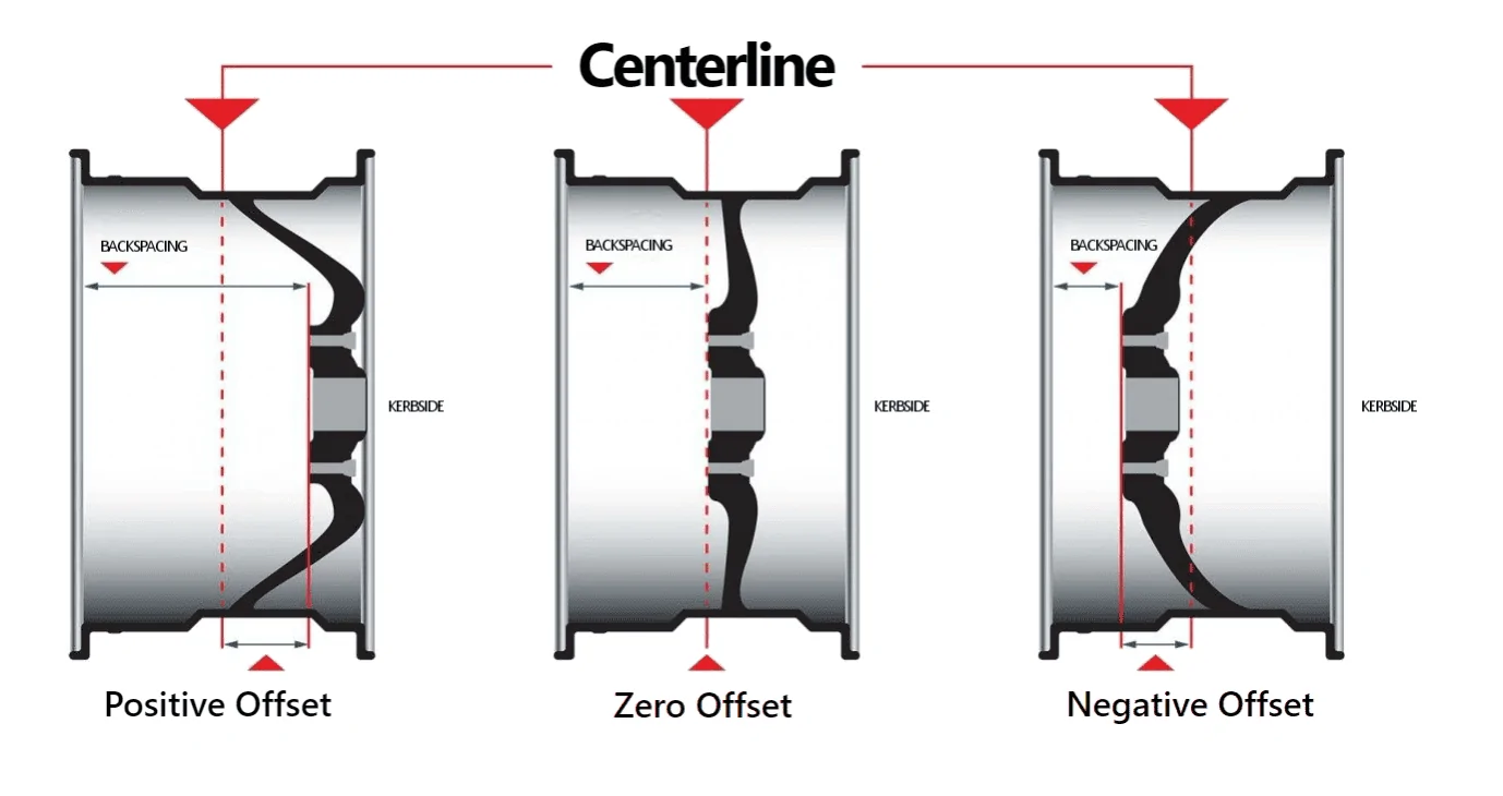

I saw the extra holes. I said to myself, that's weird and I'm not sure I like that. And then you confirmed what I was thinking. I figured if I stayed close to the 18x7.5 with the 18x8 it would work but I didn't understand the +40MM Offset. I'm not sure I understand what that is or how it affects the tire size.
