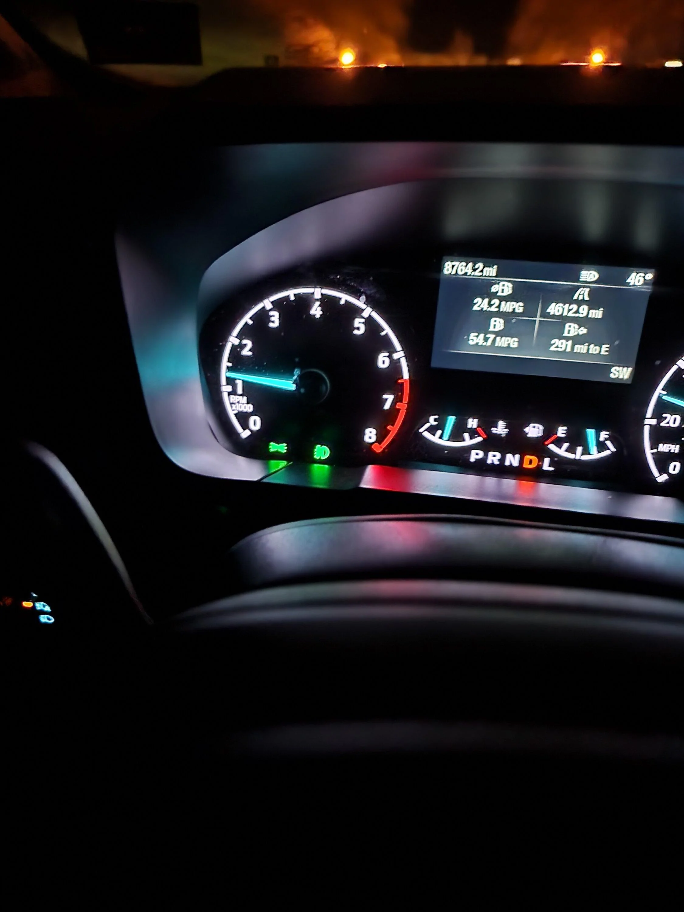

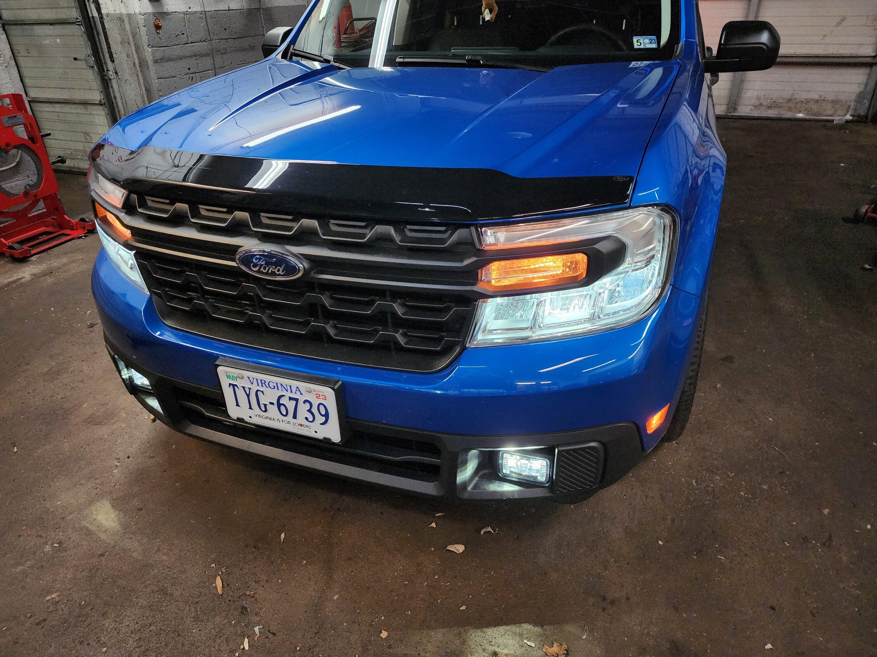

Update drove 45 minutes to my house they worked like factory.
No problems what so ever. Wires where all good. They will work with automatics lights too and they will turn off when you turn on high beams.
