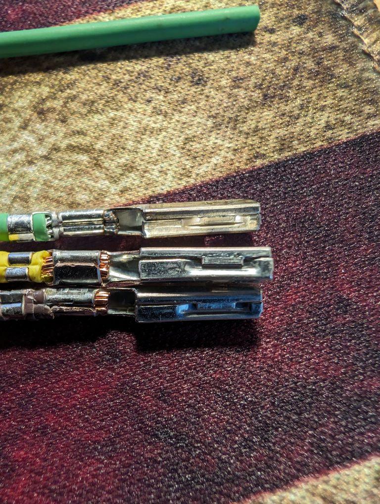

Just sharing for anyone who might want to crimp their own terminals on the BCM side instead of using the Ford repair parts - I believe I found the correct pins. They are Molex MX150 part number 33012-3021. They are about $0.15 each at Mouser: https://www.mouser.com/ProductDetail/Molex/33012-3021-Loose-Piece?qs=8%2Bu/V6/T1OrugG5hu7z58A==&countryCode=US&currencyCode=USD
I need to practice/figure out my crimping. Obviously the Ford is done perfect (on top). Here's a quick comparison pic of my first practice attempt:

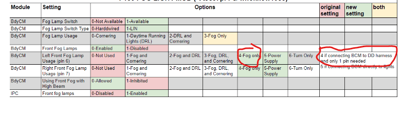

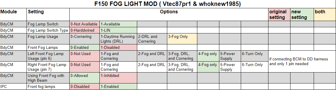

So one last thing, I was putting together all the forscan changes so that I could be added to that master list thing on another thread. This is more just curiousity but any guesses on What the DRL and Fog only modes are for the lights? Cornering is suppose to be for turning the wheel and turn only is suppose to be when the turn signal is on. As far as I can tell, DRL at least on the lariat never turns off unless I turn it off at the knob and I've got no clue what fog only actually represent.
edit: Thought I had it finished. changed all the setting, symbol on the dash working, but no fog lights. Not getting any voltage out of my wire from the bcm so im going to have to trace down that gremlin and see where the disconnect is happening.
edit 2: found the gremlin, adjusted forscan settings to #4. Everything is working fine. updated this chart for the forscan settings

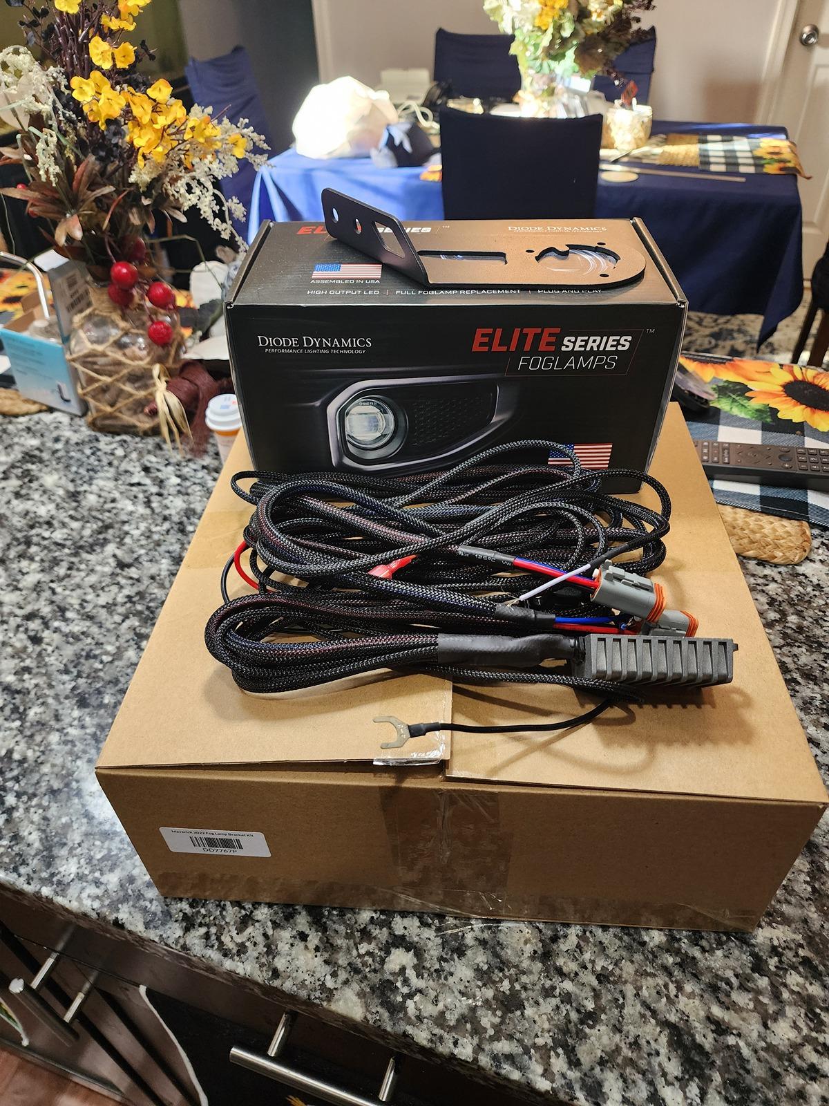

If anyone its interested i have a full kit of Diode Dynamics fog lignts for sale. Im asking 250 for it with out shipping.
