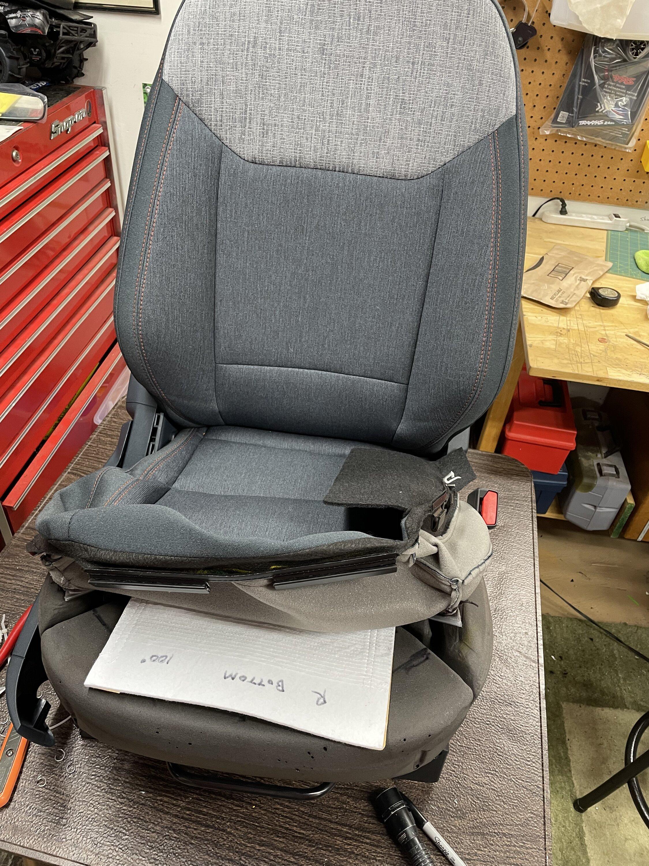

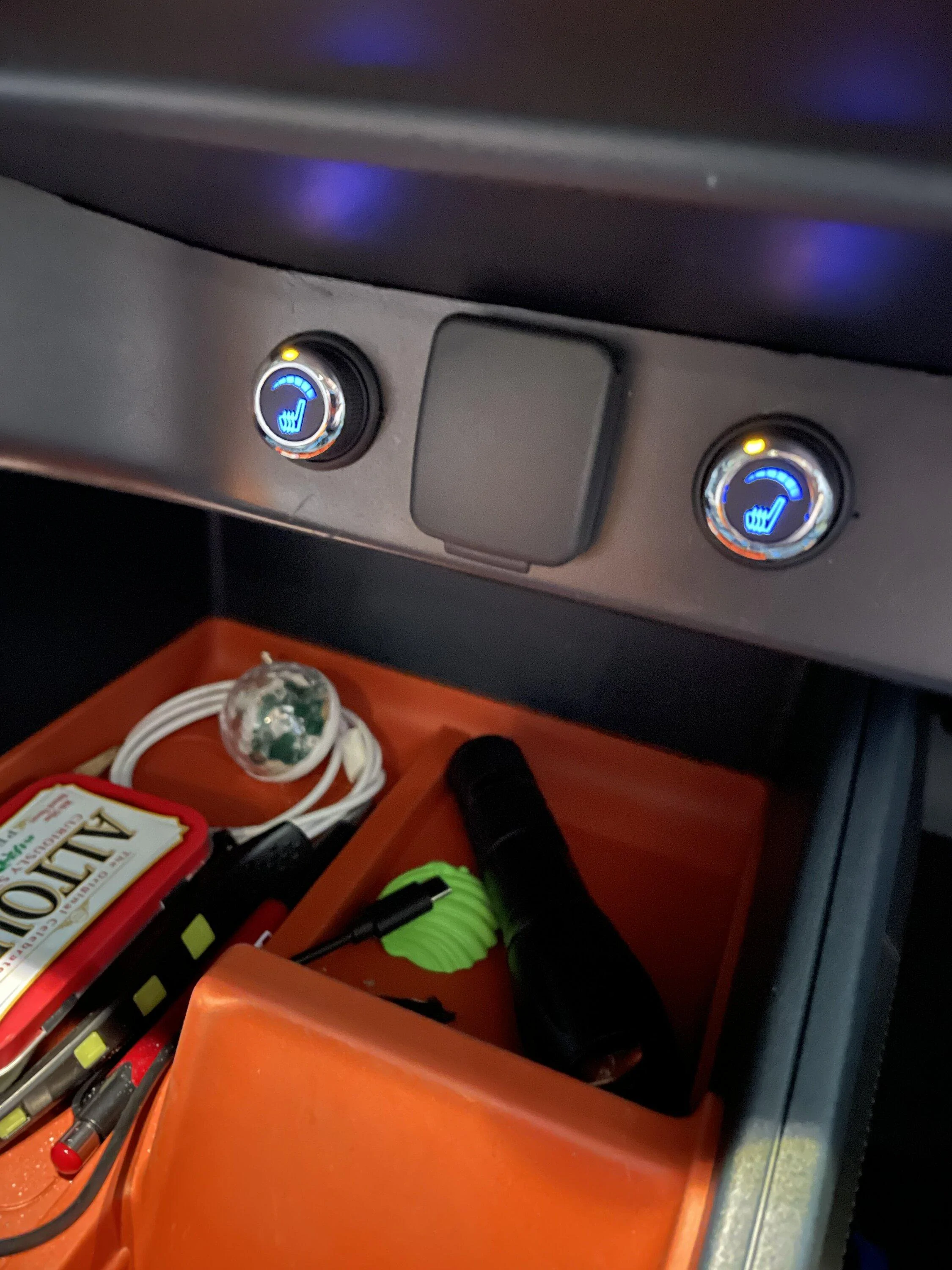

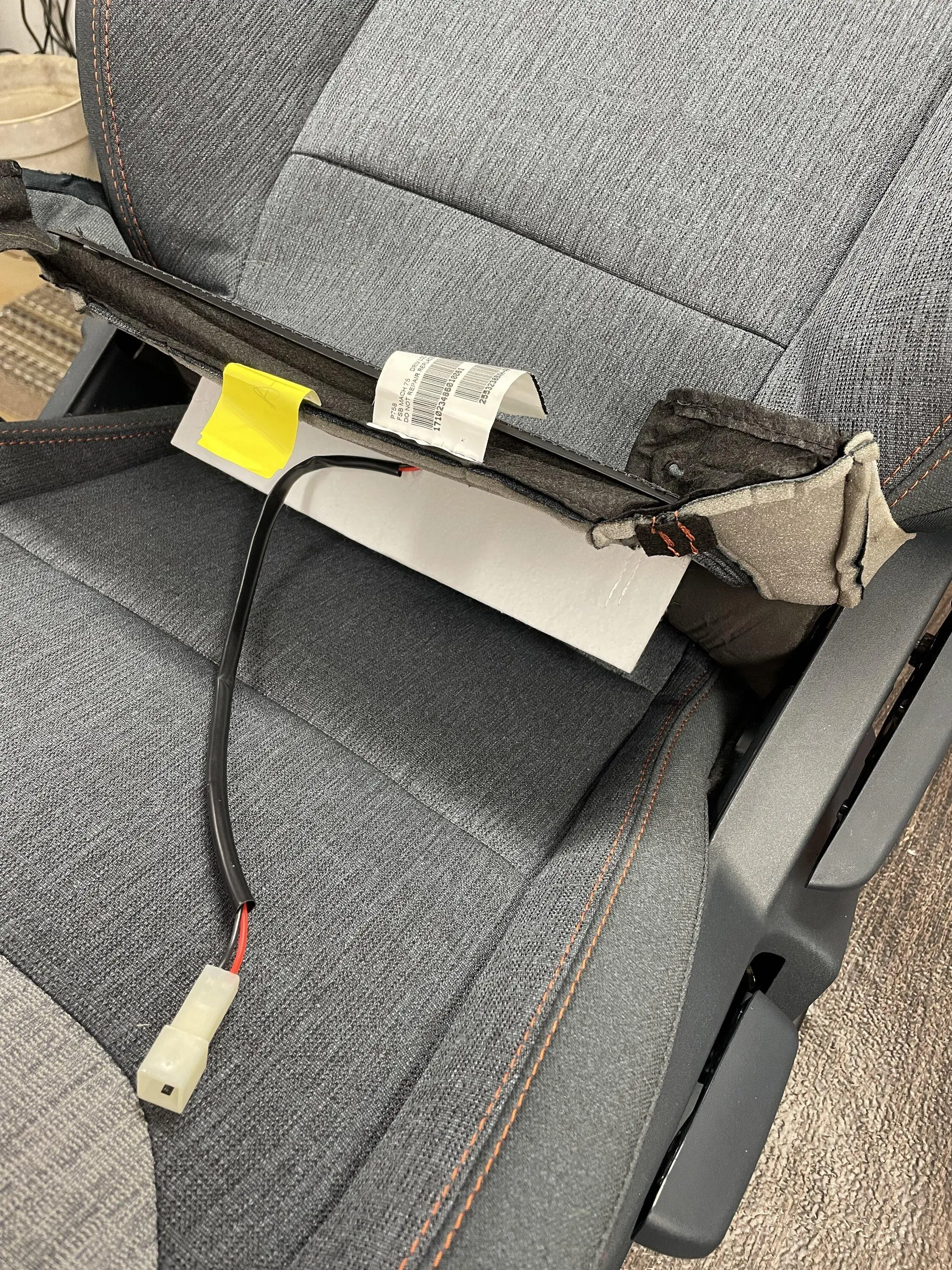

I installed seat heaters in my 24 XLT . Not easy but worth it .I’ve done this same process on 4 other vehicles so it’s kind of second nature being a retired mechanic. Replacing the metal hogrings with nylon zip ties for the upholstery is the most intricate part for me . Wiring is straightforward process. Pull the seats out because it’s only 4 bolts and one plug.
