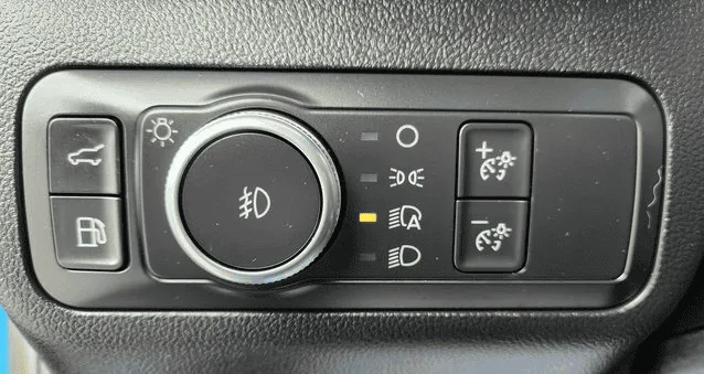

The real question is if its somehow possible to combine the guts for the foglight center button to make it workable with the hybrid and its extra button for the fuel door.
Why not just use the module from an Escape Hybrid with fog lights? It already exists.
5,728
7,247
Sure, if you don't mind (and assuming the BCM interprets it properly as) your cargo area lights having the Escape's tailgate open icon.

Although I suppose transferring the button face might be easier.
Good point.. I'd have to imagine that's an easier thing to work around, though.
Wouldn't a module from an F-150 PowerBoost with fog lamps be the best option, then? Those have the pressurized fuel tank with electronic release, with the fuel door release button below the cargo area light button.
This should work since pins are all the same you should try it and let us know lol i dont have a hybrid to test this and my fuel door its manual
