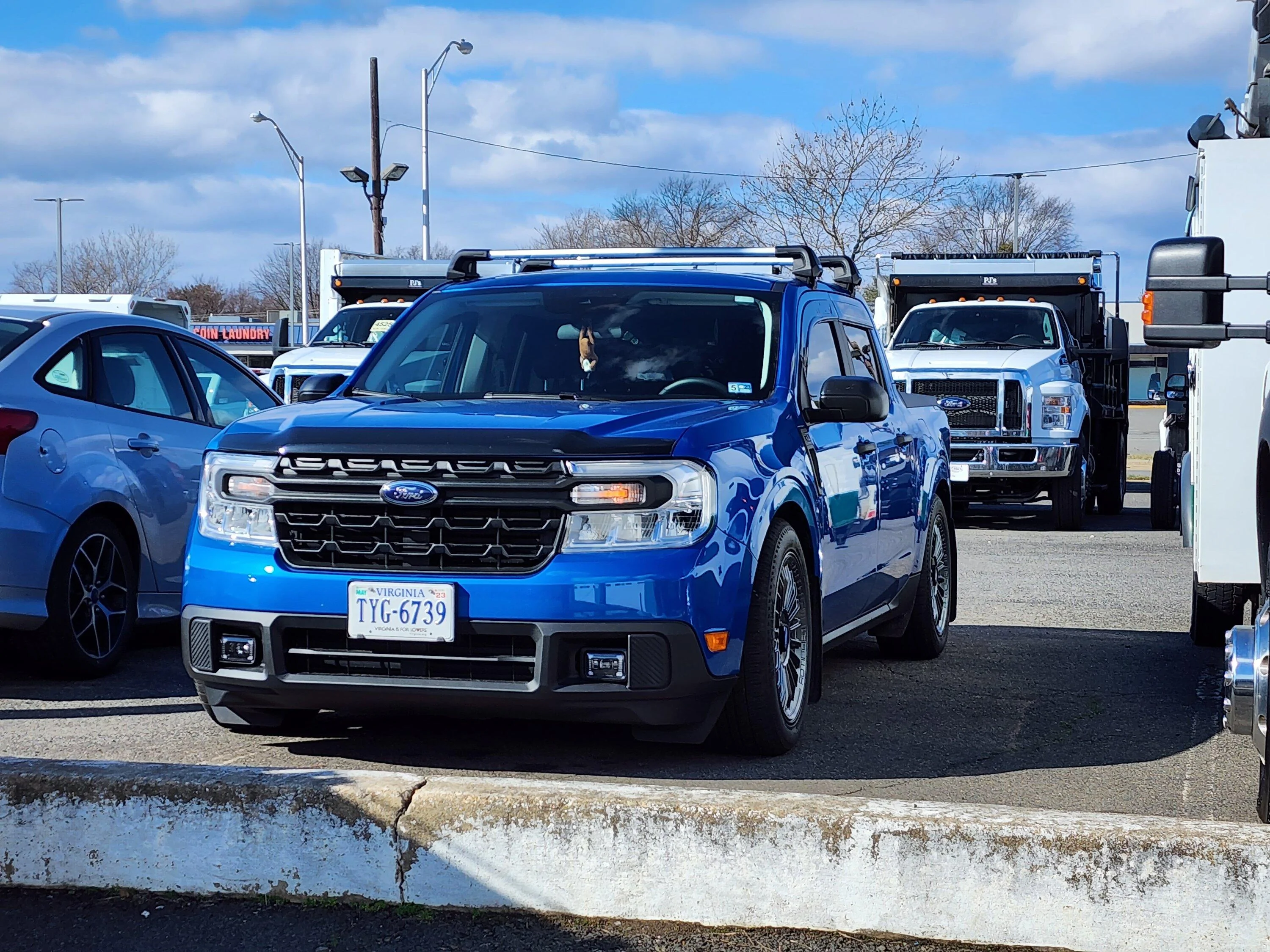

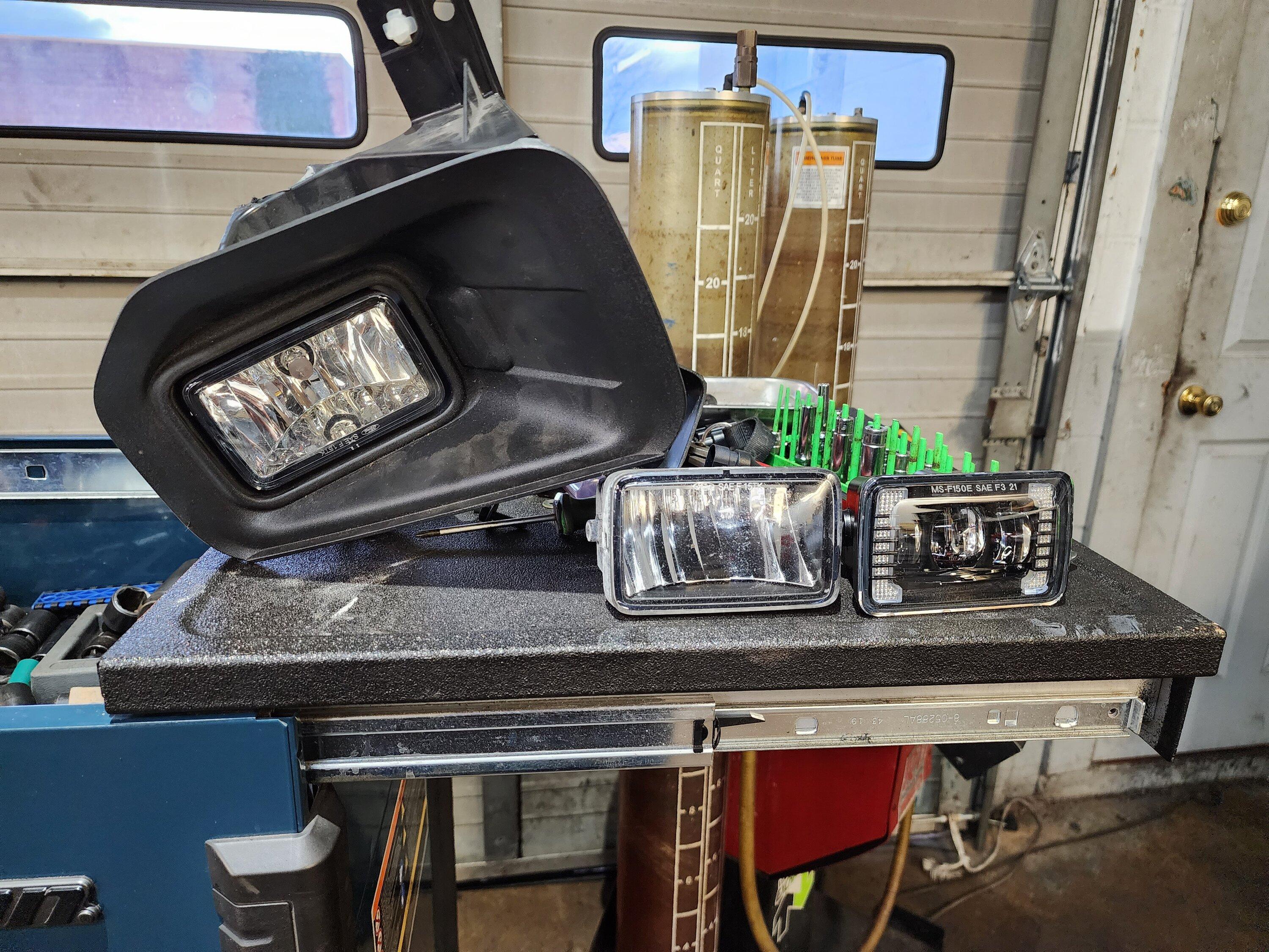

Ford f150 Factory Fog Lamps and base. Year i think its from 16 to 2021
Love this post! What are the differences between the lights in the photo? What is actually on your Maverick? How did you secure the lights to the bumper?
