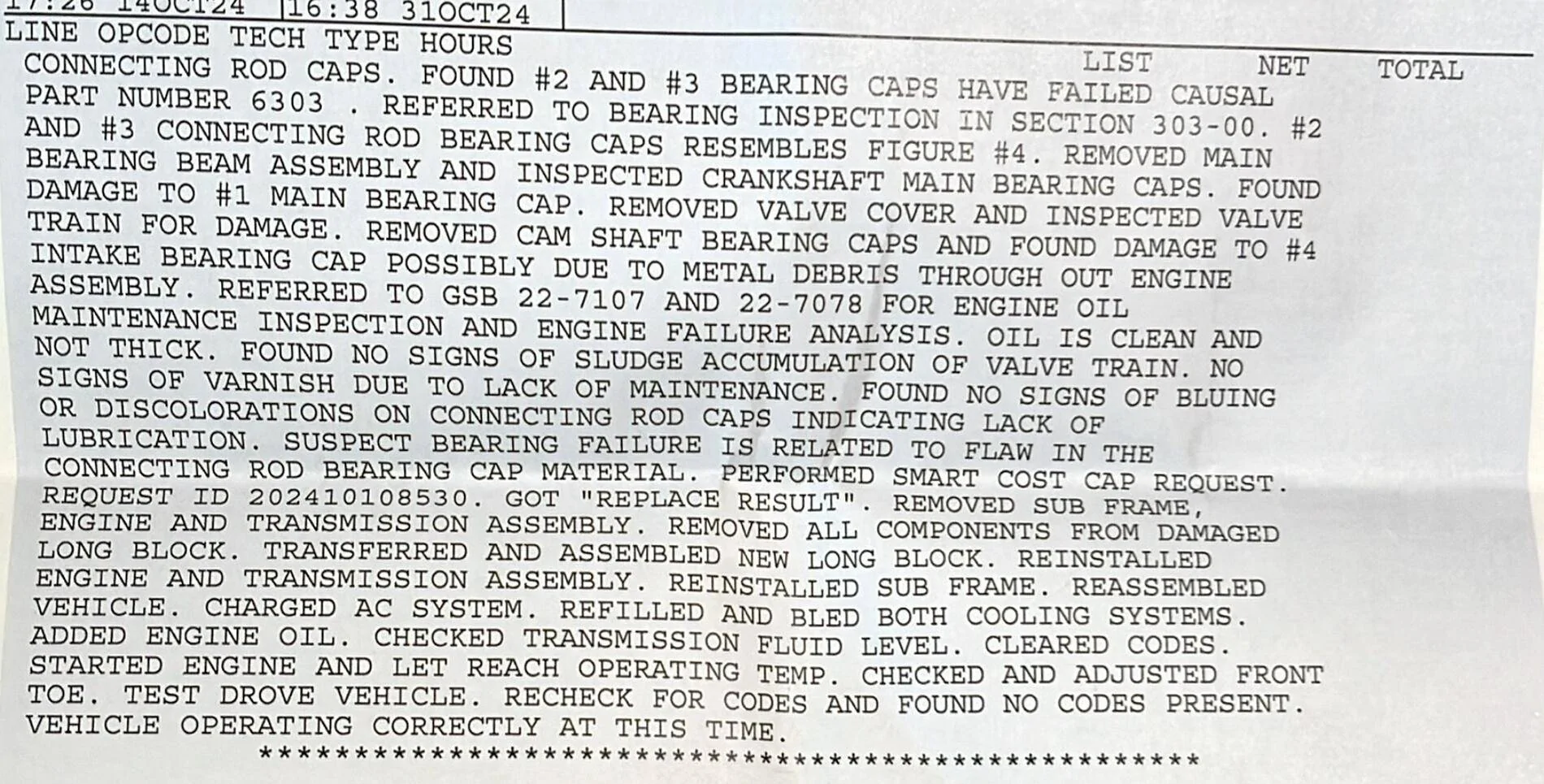

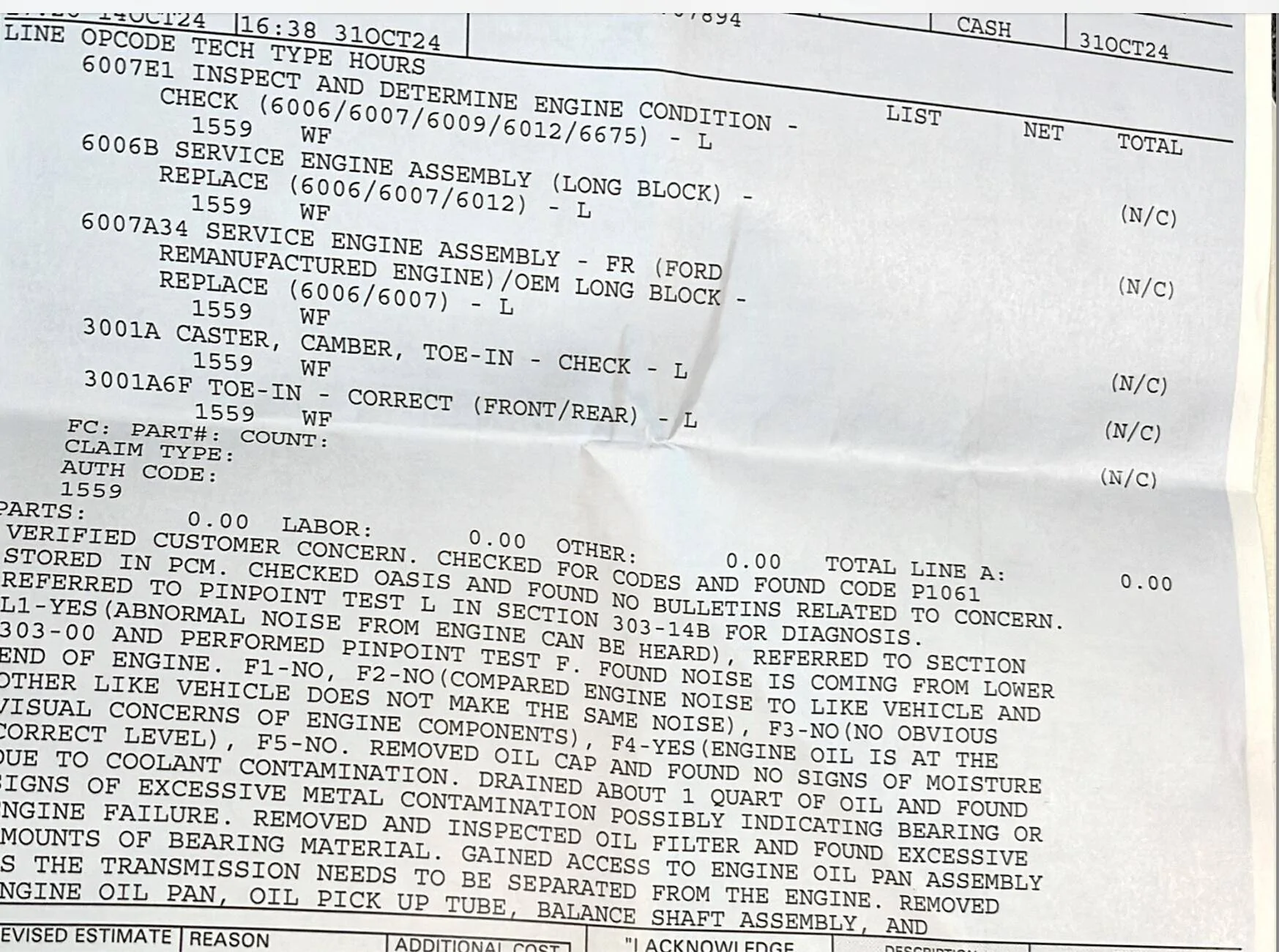

I just had to replace the engine in my 2022 Maverick with only 38,000 miles! It was quite a shock, especially since I’ve only had it for less than a year after buying it from a friend at a great price. I had just hit the freeway when my truck went into limp mode, struggling to go over 30 mph, and I barely made it home. I ended up having to tow it 77 miles to the Ford dealership—thank you, AAA!
The dealership was really helpful, and I got my truck back sooner than I expected, thankfully without any cost to me. This is my first Ford, and with my basic warranty expired, I’m not feeling too confident about the future of my beloved truck. The dealership mentioned they hadn’t seen this engine issue before with a Maverick, but most of the ones they work on don’t have as many miles as mine. They alluded to that more trucks from earlier model years with similar issues might be on the way. I just hope this doesn’t happen to anyone else!
Has any one else experienced this? If so, with how many miles?

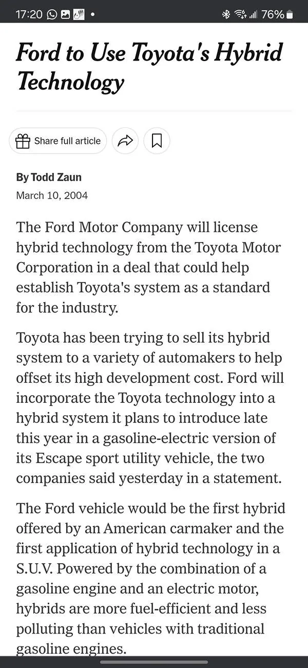

Ford broadly licensed the conceptual technologies for a Hybrid patented by Toyota. The only specifically "Toyota" element was the eCVT was produced by Aisin, their subsidiary drivetrain company. Ford took over producing the eCVT assembly themselves starting with 2013MY vehicles.
