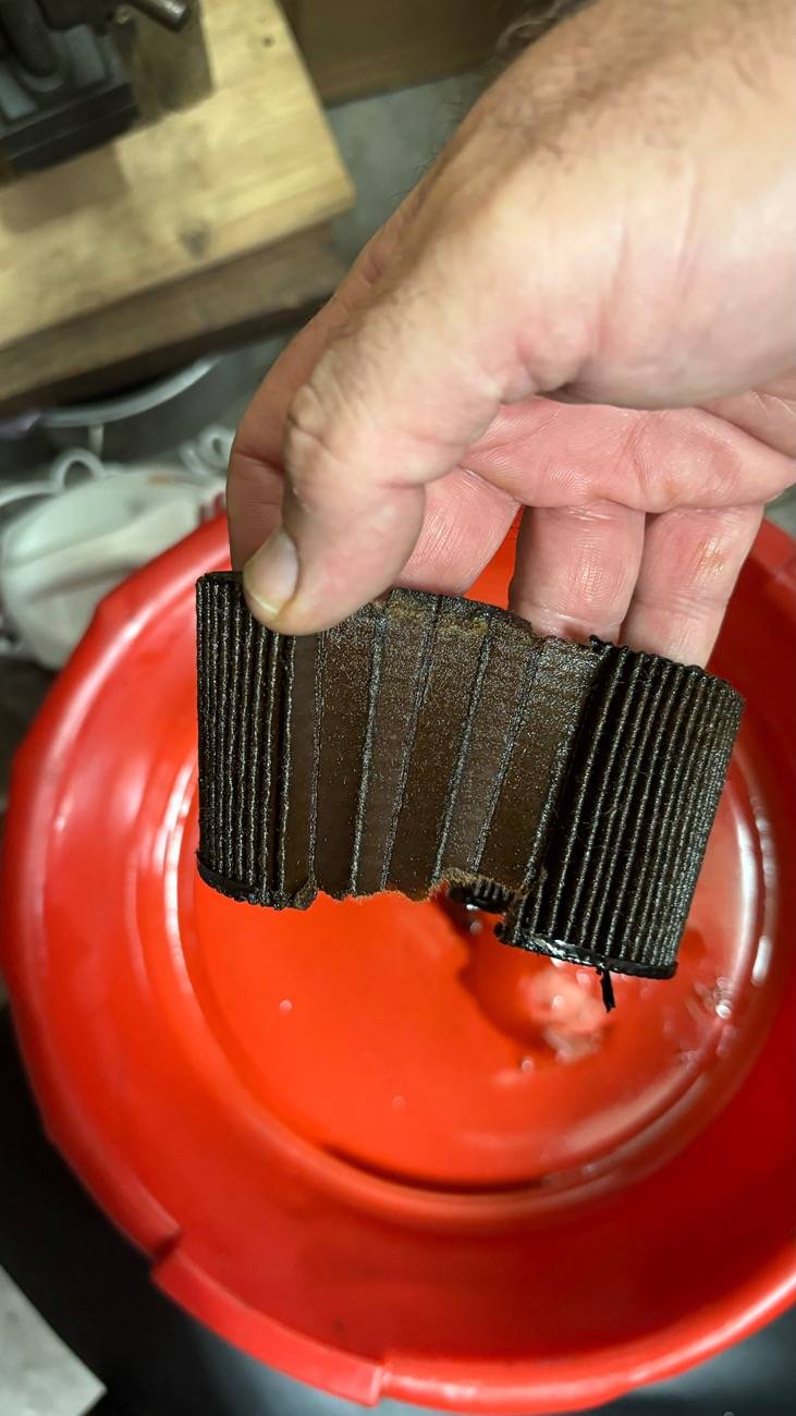

I sent my factory fill oil for Blackstone analysis, I did it at 50% oil life which was around 6000 miles with typical new engine results. I just did my 3rd oil change and sent my second in for an analysis, it was at 19% oil life and just over 9000 miles. I decided to cut open the oil filter to see in there was any "stuff" visible in the pleats, and despite being on the recall list my filter was super clean with basically no visible metals. Ford factory filter.
new Blackstone oil analysis the first one was the factory fill. This is from the second oil change same as the filter pic above.
