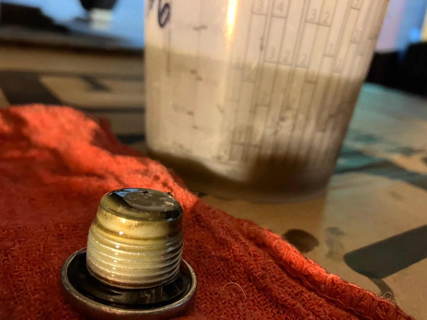

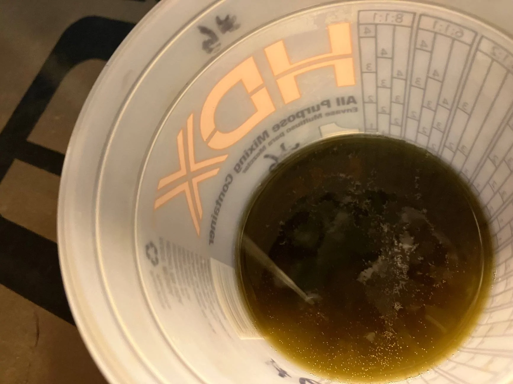

Another instance of under filled PTU, with some break-in wear evident at just 1100 miles.
10 oz came out. About 18oz RedLine 75W-85 went back in.
