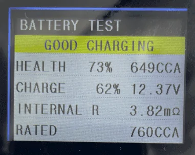

My second EFB battery won't charge more than 65% or so. Maybe the third battery is the charm...
Might stop by an auto parts store to see if they can test it for me.

While I test the battery myself, you had a good idea, and will take it to a parts store.

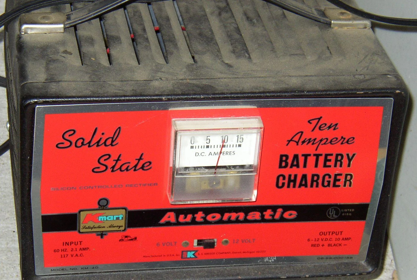

I have an old charger from the 80's and directly charged the battery at the terminals overnight.
From this video I now know that is the wrong way to do it.
I did charge overnight so maybe the Ford failsafe caught me doing the charging incorrectly and had the BMS software update because of that.

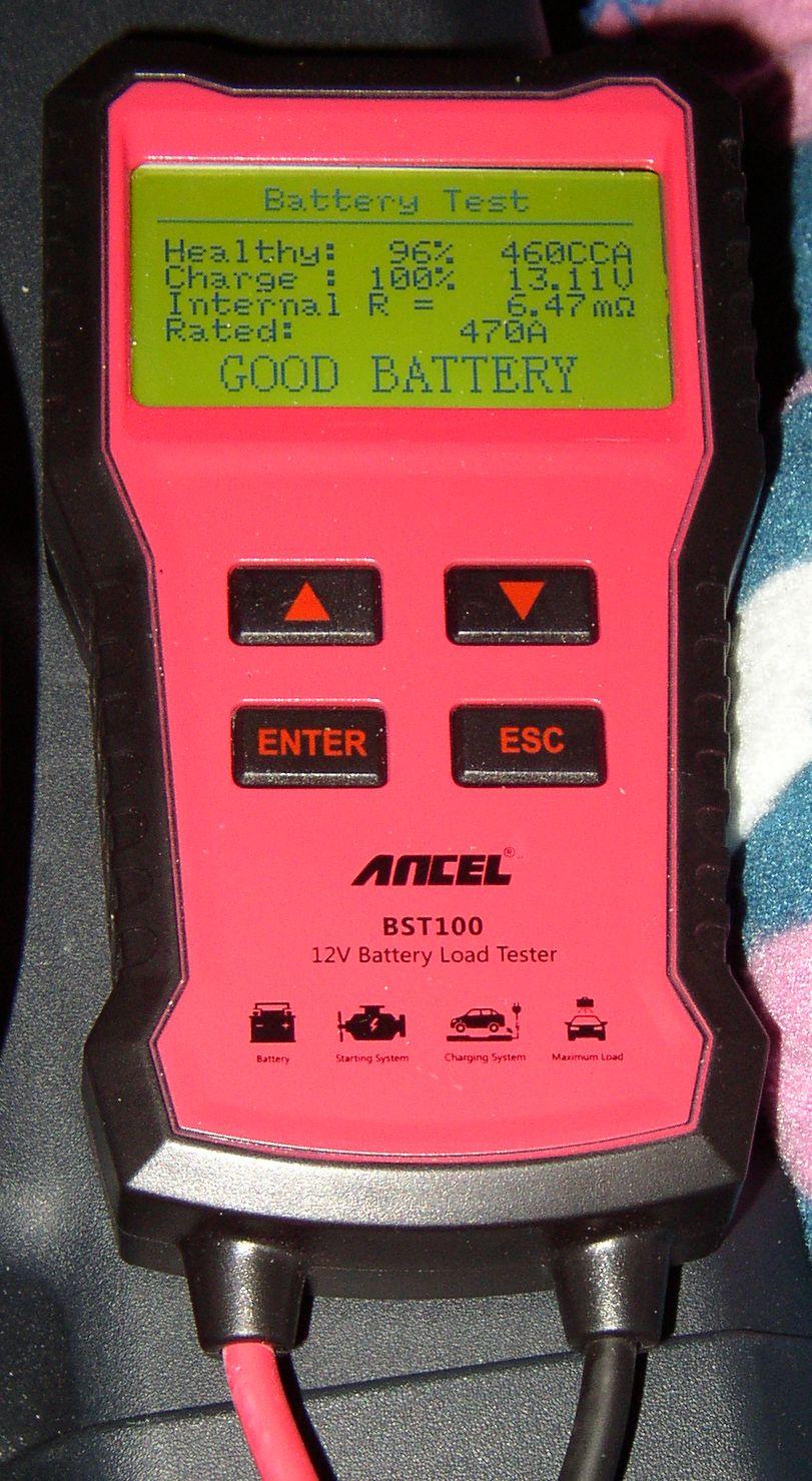

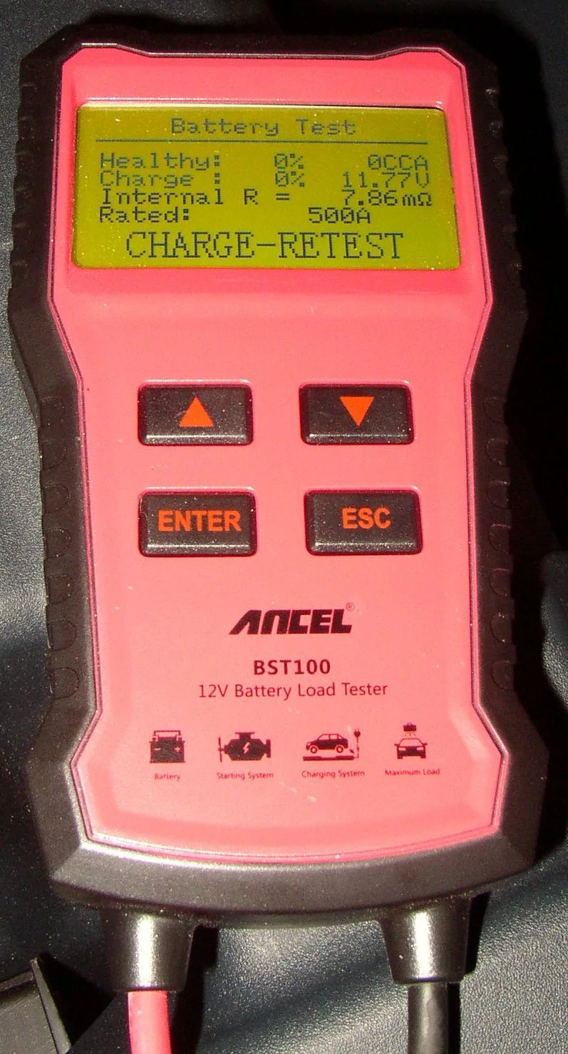

Here are some photos I have from my 2022 Maverick Hybrid showing charge states, charge tester and charger.
"Deep Sleep" warning and Ancel Tester showing 0% Charge and 0% Health with 11.77 Battery Voltage
Ford Maverick EB 2.0 battery replacement... 2023-01-25
After overnight charging: 13.11 Volts and near 100% charge and health

Very old Kmart Charger
Ford Maverick EB 2.0 battery replacement... Kmart Charger

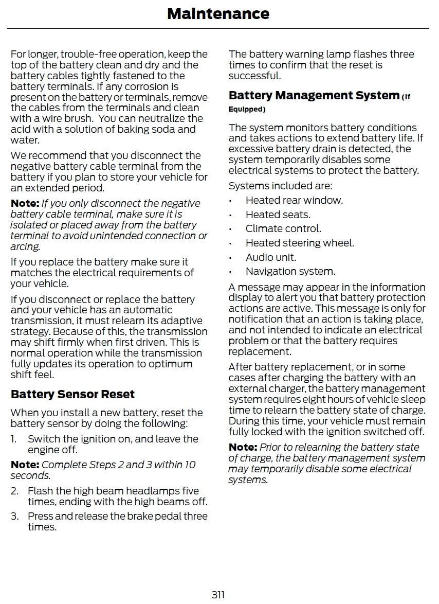

Being lazy today, NFL Sunday, etc., how do you reset the BMS manually?
Thx...
Thx...
Ford Maverick EB 2.0 battery replacement... Battery Sensor Reset and BMS Syatem
