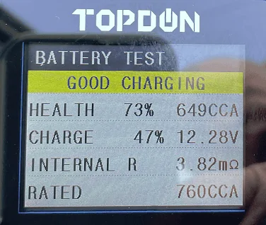

Friday cannot come fast enough, the charge level looks awful:
Ford Maverick EB 2.0 battery replacement... 1699386390944
The ambient temperature is unseasonably warm today @65°F in two in the afternoon. Hopefully, it will start Friday morning for taking it to the dealer....

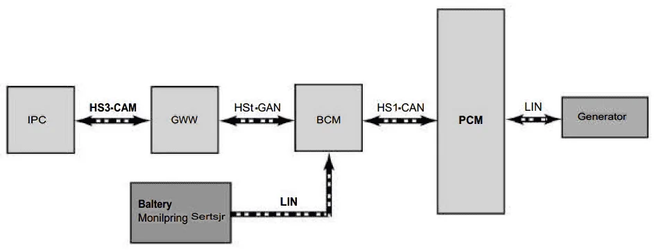

Ford Maverick EB 2.0 battery replacement... 1699800118709
The Power Control Module (PCM) controls the output of the alternator, based on the engine efficiency and may lower/disable alternator output to shed its load on the engine. For example, the alternator charging is disabled during cranking/starting the engine. The ABS sensor is used by the PCM to monitor vehicle speed and adjust the charging system voltage level. If this charging system has an issue, like mine and others in this thread, it doesn't matter if the battery is OEM, or from a third party in my view.
