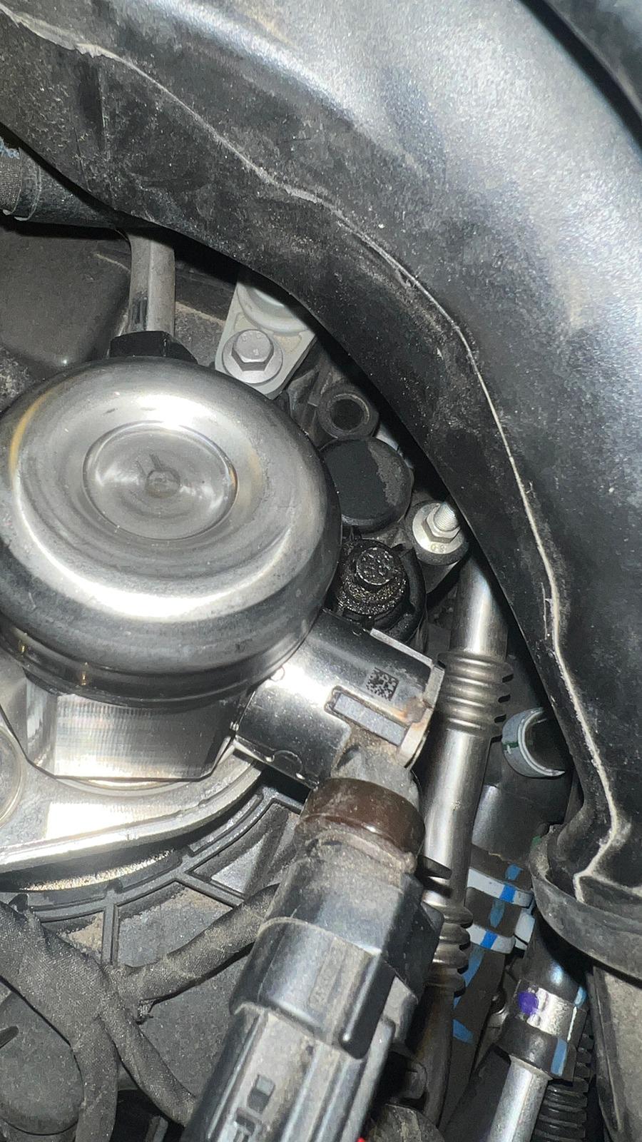

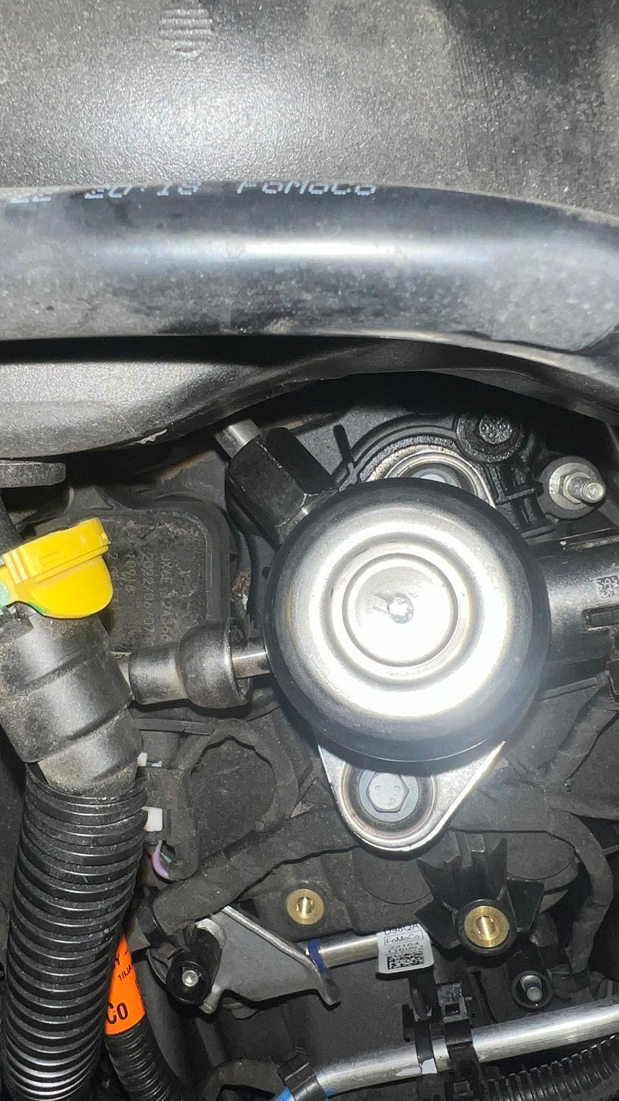

Hi Everyone,
Just a quick update with dealer's response. Upon checking the HPFP, they claimed that the noise was normal, and nothing was fixed. A few weeks after that, once I removed the HPFP cover, I noticed that there are some oil residuals around the area. Now the dealer wants to change the HPFP, and the gasket seal. I'm not sure if they are doing the correct thing tbh.
Ford Maverick EB 2.0 High Pressure Fuel Pump IMG_4412
Ford Maverick EB 2.0 High Pressure Fuel Pump IMG_4413
