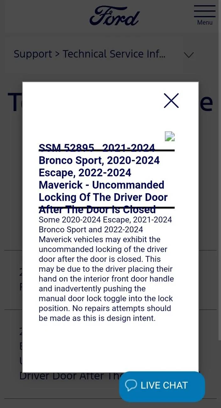

In their service of bulletin Ford implies it is human initiated.
I would like to prove Ford wrong.

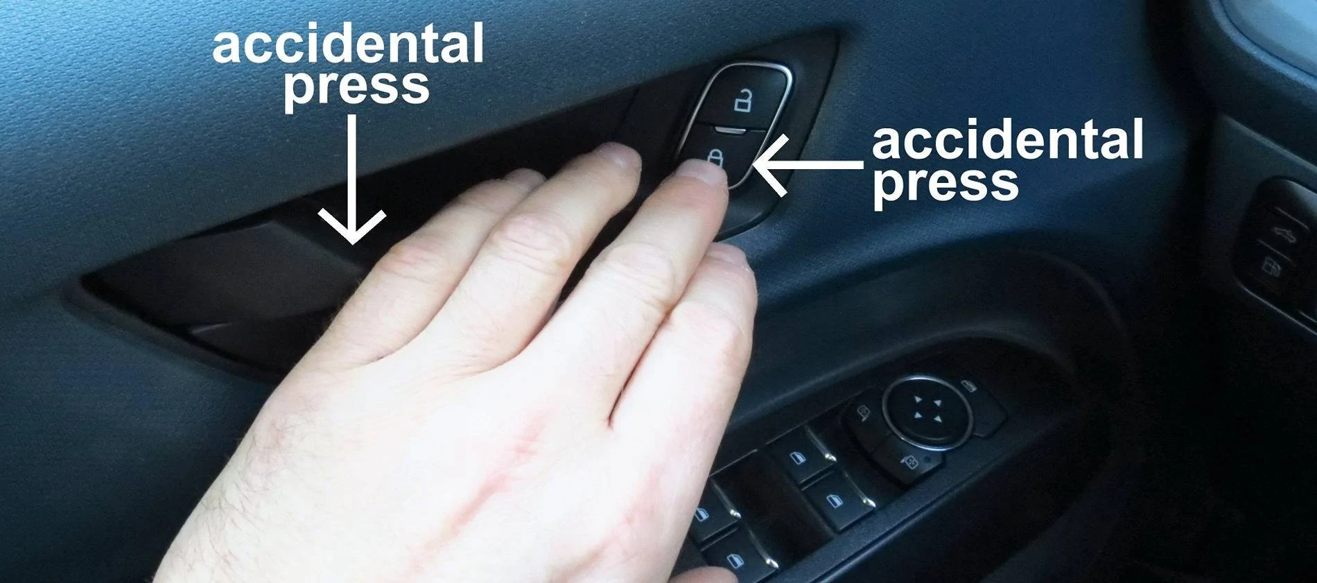

I've had the locking happen to me more than once, and I'm pretty sure it occured 2 ways. Regardless, the accidental door locking due to the design/layout of the controls bugged me so I did something about it.
When gripping the door lever and opening the door, the side of your hand can accidentally push in the mechanical lock lever and a fingertip can accidentally press the elec lock switch. Aargh!

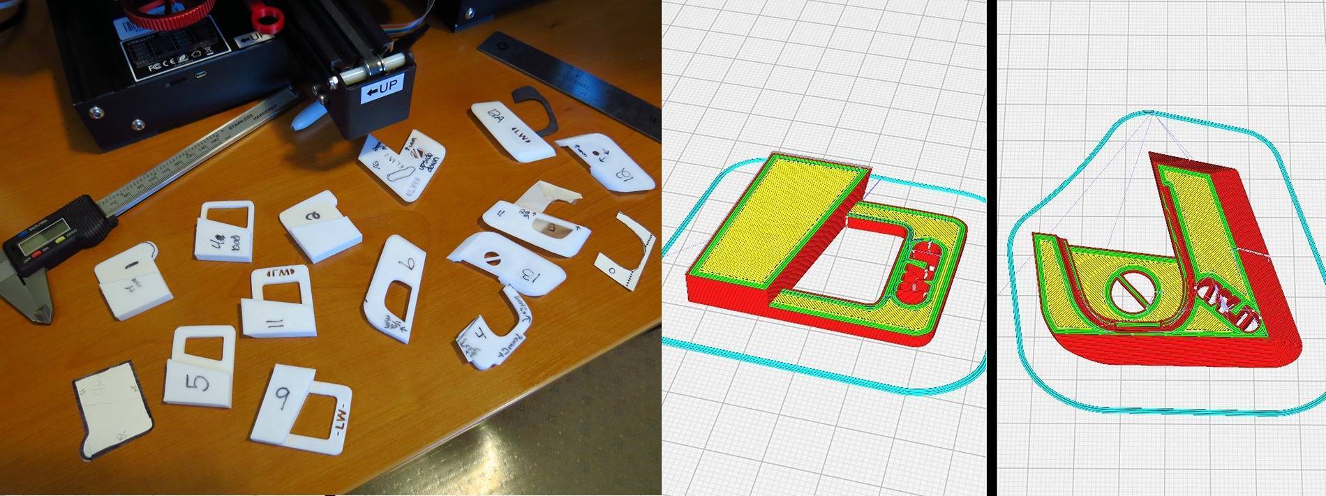

This ended up being a good excuse to finally get familiar with 3D printing and come up with something useful. Bought the cheapest and most neglected 3D printer I could find on FB Marketplace and spent some time watching YouTube tutorials on the design software.
Measure, draw, print, fit, and repeat. Lots of trial & error involved but I ended up with a simple 2-piece solution that works well in preventing accidental pressing of the lock lever and button.
