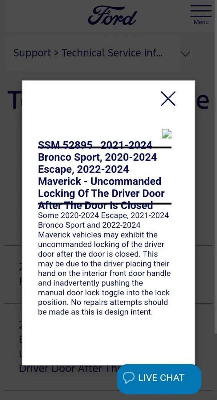

Appears to be human error. As I demonstrated the possibility of in my earlier video.
Here is the Ford service bulletin.
Ford Maverick Driver's door locks automatically on exiting 20240925_070002
To those folks, that insist it happens automatically.
To those folks I say. Please take a video of it. It can only bolster your claim.

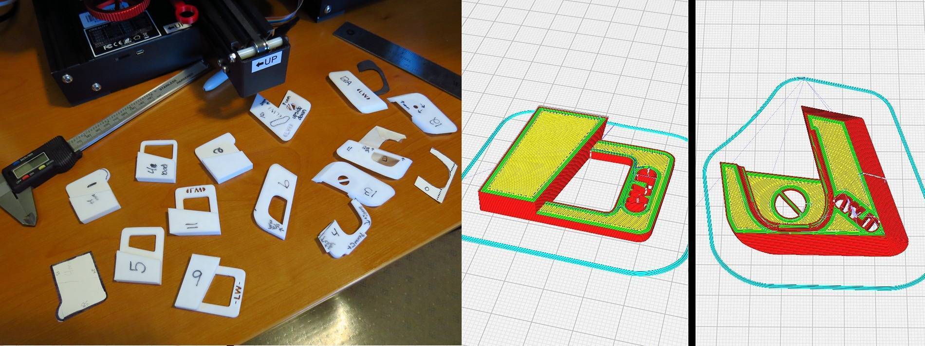

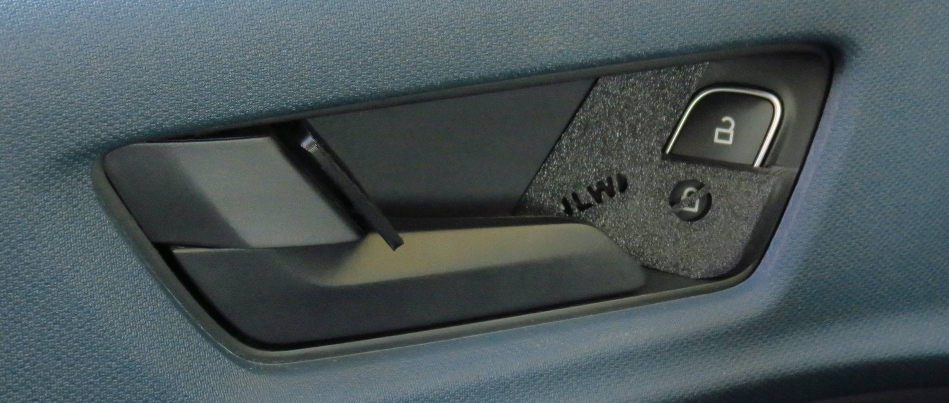

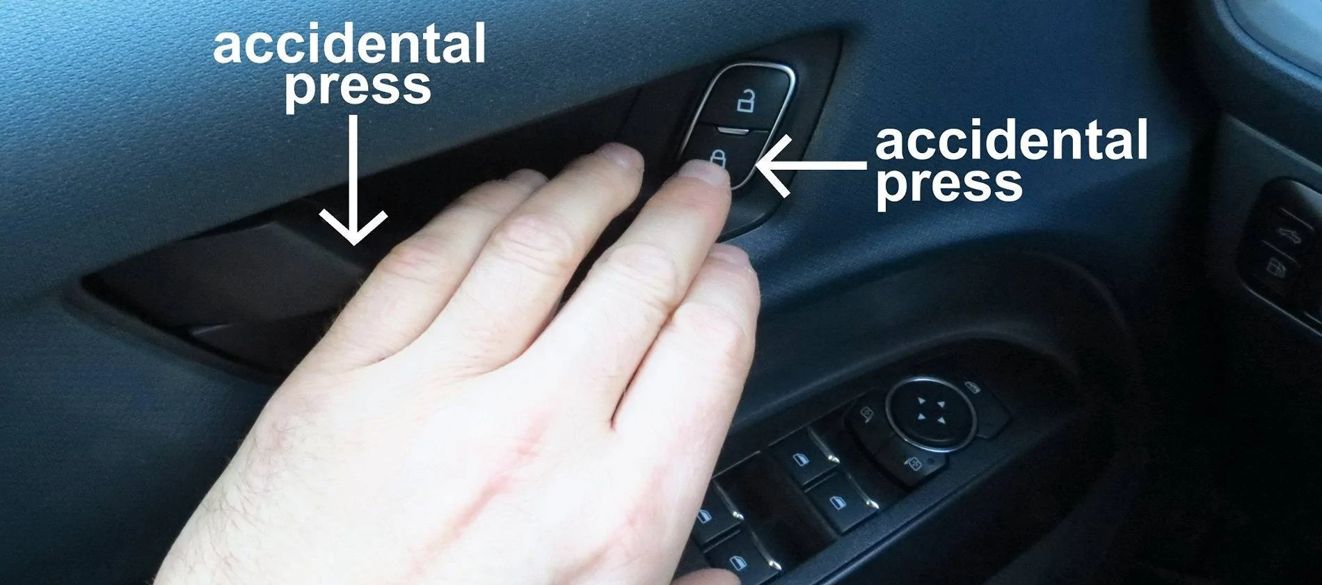

This has happened to me too, more than once, until I got super aggravated at the repeated accidental door locking due to the design/layout of the controls.
When gripping the door lever and opening the door, the side of your hand can accidentally push in the mechanical lock lever and a fingertip can accidentally press the elec lock switch. Aargh!
Ford Maverick Driver's door locks automatically on exiting lock_button_problem-jpg-jpg
This ended up being a good excuse to finally get familiar with 3D printing and come up with something useful. Bought the cheapest and most neglected 3D printer I could find on FB Marketplace and spent some time watching YouTube tutorials on the design software.
Measure, draw, print, fit, and repeat. Lots of trial & error involved but I ended up with a simple 2-piece solution that works well in preventing accidental pressing of the lock lever and button.
Ford Maverick Driver's door locks automatically on exiting lock_guard_design-jpg-
Final version:
Ford Maverick Driver's door locks automatically on exiting img_3579ab-jpg-
Read more about it here. They're available If anyone else wants a set.

Original Post as in the first post. As in, it said nothing about opening the doors from the outside.
Well - that SSM says exterior door handle, and not opening.
So ya, from the outside.
So if this issue is occurring, a driver should be able to open one of the other unlocked doors if already unlocked - look at the lock on the driver door - and see it's still actually unlocked.
Doesn't say if the handle won't pull out due to this lock, or it just won't engage the normal open mechanism.
And how is the inertia feature gotten past since it doesn't say?
Does one have to do the Unlock all from passenger side, or pull the door handle from inside?
I'm thinking back, and I can't recall anyone that said the other doors were unlocked, and how they opened the drivers door back open. Of course doubtful anyone noticed the state of the lock on the drivers door.
