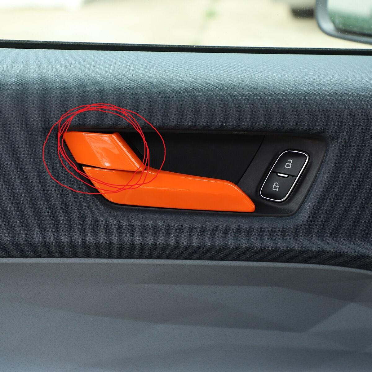

Do people not see how easy it is to "bump" this and lock the door when opening it? This isn't some big mystery folks!

It isn't bumping the button. It is bumping the actual pointy plastic manual lock lever that is "out"/not flush when unlocked and "in"/flush when locked/bumped with a hand pulling on the door handle. Bumping it pushes it back flush with the rest of the door handle and locks the door. I'm not sure why so many folks are like "IT IS SO MYSTERIOUS....IT ONLY HAPPENS TO THE DOOR THAT A HUMAN IS EXITING AND NONE OF MY OTHER DOORS WHERE A PASSENGER DIDN'T TOUCH ANYTHING.....SO WEIRD!"

Ohh I agree, crappy design for anyone with hands larger than a baby. I have had it happen to me maybe 2 or 3 times, but I have small hands. By the third time it happened to me, I realized it was happening in real time and pulled it back unlocked before I closed my door.
Reports of this issue date back almost to the first Maverick deliveries (and other models before then). And yet, has a single person claiming the vehicle locks only the driver door all on its own, ever actually heard the power locks activate uncommanded? Haven't seen a report of that yet.
If you pull the handle, release, and then push the door right there, you could easily push the lock in without noticing. My preference/reflex is to reach down lower for the grab handle/armrest.
