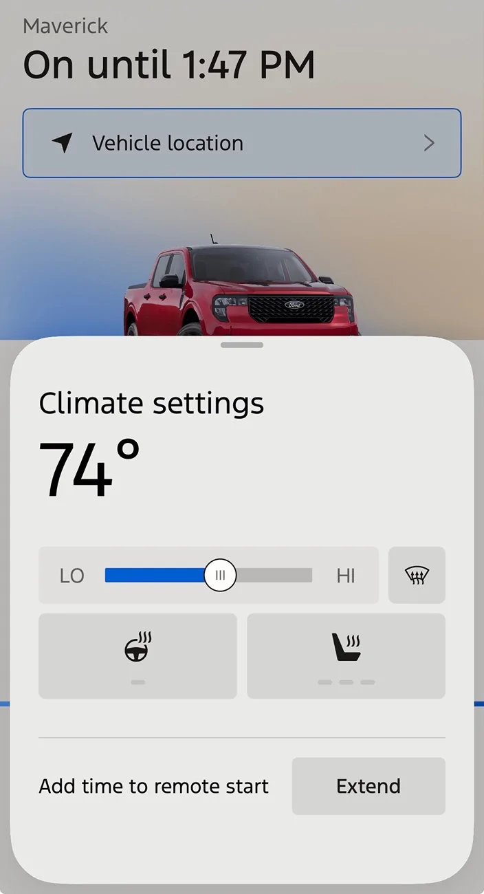

I find the fact that I can’t regulate the temperature from the Ford app so I can pre-cool my car in Arizona truly annoying. I know that I can leave the air-conditioner on high and when I start the vehicle with the app, it’ll come on high, but I should be able to alter it like every other manufacturer allows with their auto start features. Come on Ford.
Maybe I should ask not ask too loud They’ll offer it by subscription for 20 bucks a month
When I remote start through the app it shows me the current temp setting and allows me to change it.
I have a 23 lariat hybrid. My app does not allow you to change the temperature, and I don’t think they put the hardware in to do it. I guess they’ve changed that in later models if you have something different.
I think it's new functionality they just added in the last app update.
I’ve updated my app, but the function, isn’t there
I don’t think they have the hardware in anything but 24 and later models
