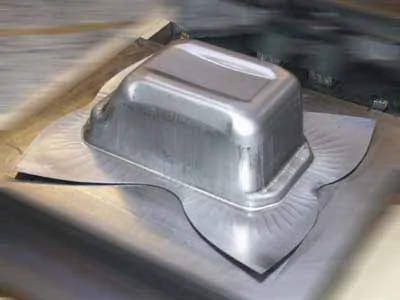

The photo below shows an exaggerated view of what these disruptions are and look like.
The flange area of this drawn part is in the cut-off (scrap) area and these "fingers" are clearly visible. Obviously, you don't want these in a finished part. They normally show up in around areas where the geometry changes (e.g holes, depressions, protrusions and so forth) which is why they might show up around a handle area of a vehicle. Like I said, these are very pronounced:
Ford Maverick Door handle area panel wavy (poor quality ?) fingers_1
When these occur on a finished part, it is typically due to a die or lubricant issue within the draw-press operation.
Yup, this has nothing to do with it being a cheap truck. It's simply lack of process control at ford. I bet some are better than others and unfortunately some get the short end of the stick.

OP, yes, I see them. Annoys me too. I have always walked around a new car before I sign the paperwork just to look for these type of things, I pretty much only buy black cars so you have to be extra careful. Our Mav has some slight waviness by the handle part which is from the stamping as others have mentioned. I have seen a couple Mavs from 22 model year with terrible waviness, I think this is in the steel, not from the draw of stamping, I worked in auto and steel , coils of metal are not perfectly flat, they call the waviness steel "shape" and when they blank out the steel they try to correct the shape with leveling rollers. Keep in mind its wound in a big coil like a giant roll of toilet paper so you have a curvature that must be flattened which is part science and part operator skill in running the equipment. This curvature is called "coil set" I was okay with the Mav that Igot and probably would have passed on the sale if not. I traded in a Silverado and it had some waviness too, most noticeable when you saw the reflection of the truck in the side view mirrors but not really noticeable looking at the truck, like you said, must look at it just right. The steel industry had specifications for what is acceptable and it is a combination of height of the wave and distance between the waves. I do not know what Ford deems acceptable but certainly the Mav has some issues here.
