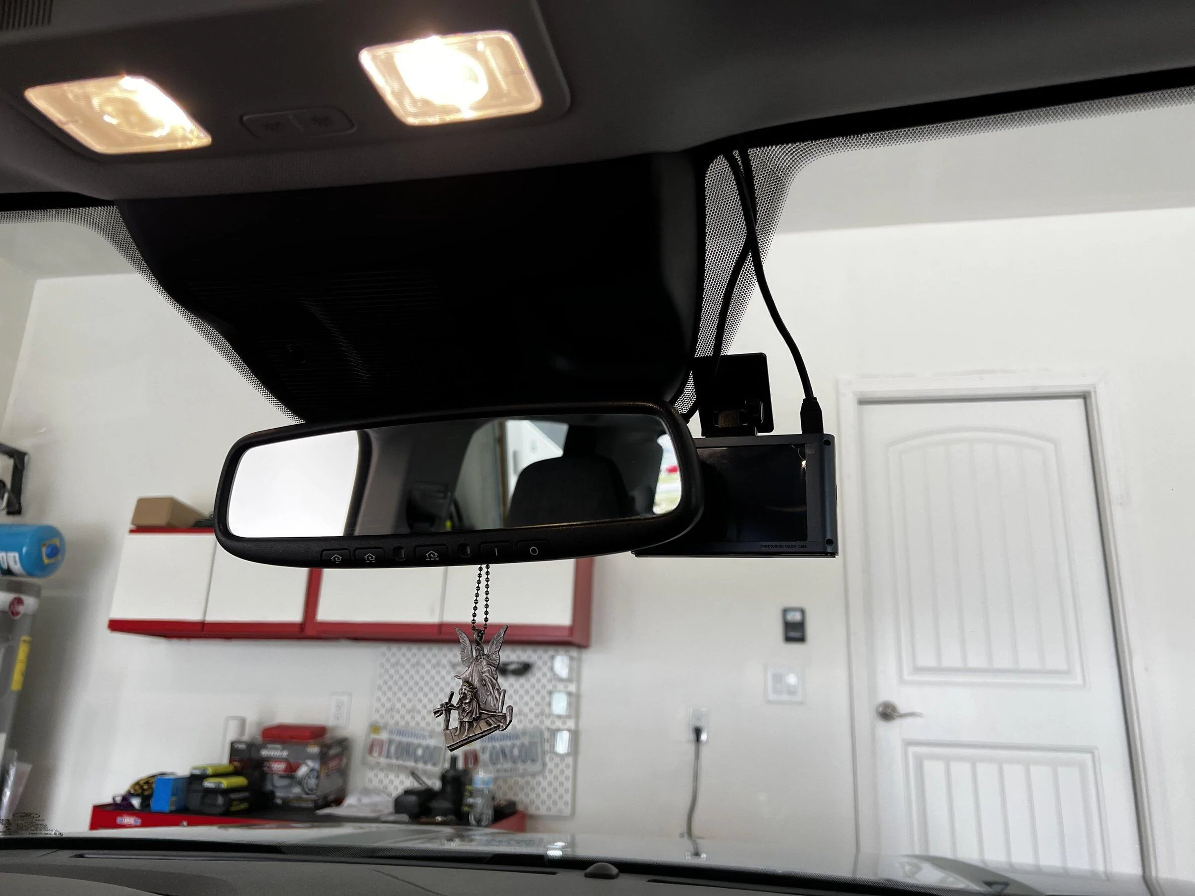

Installed my dash cam and mirror today! Thank you for the help @clavicus it went smoothly because of your guidance!
Awesome! Did you do a rear camera as well?
Yep! Routing that cable behind the rear trim was the hardest part of the whole process for me. Holy cow some of those roof liner tolerances are tight…
Did you route along the top liner for the rear camera rather than the lower door trim?
Yea which is why I think I ran into more issues… but it worked!

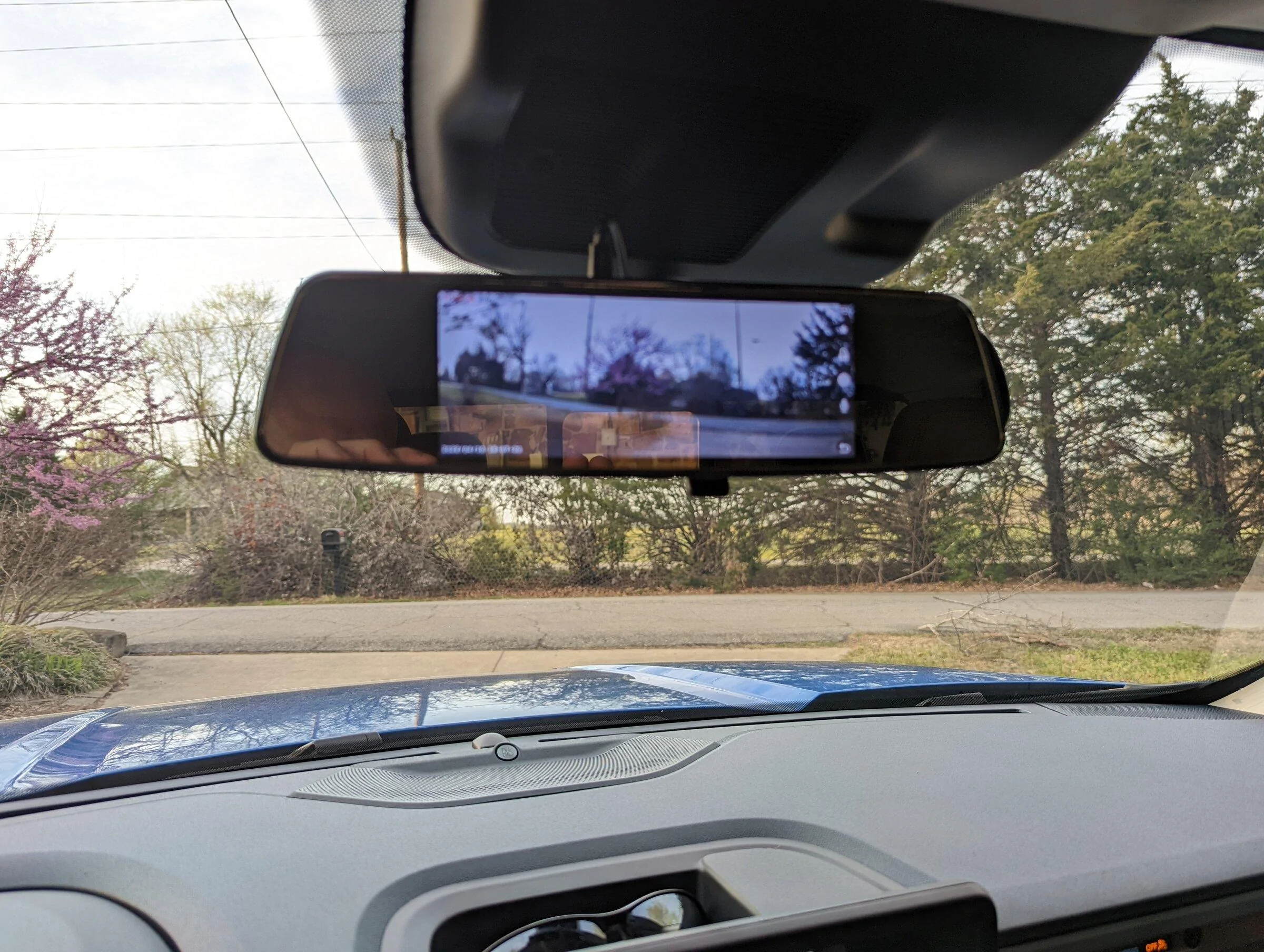

Yes. Just installed mine last night, took about 15 minutes. I had it in my Sport Trac for about two years and love it. Jeemak 7" touchscreen. Hardly noticable and gives a larger view than stock mirror. I did not install the rear camera yet, and may not, just the built in front camera.
Looks like they are around $55 on Ebay.

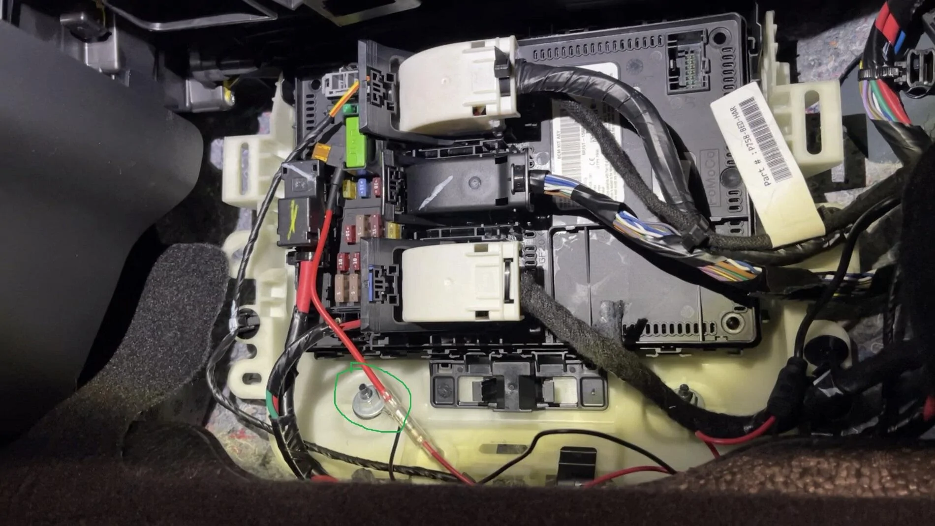

Hmm. I also wired my 7" Touchscreen dashcam to fuse 3 and have not had any issues with it turning on. I used this kit Amazon.com: MEKNIC Dash Cam Hardwire Kit Mini USB Dash Cam Hardwire for Car Dash Cam 12V-32V to 5V 2A Mini Car Dash Camera Hardwire with Battery Protection 11.5FT ,4 Fuse Tap Cables : Electronics
Not sure on the ground? I used the spot I circled in green for ground.
Thanks for the response. I also used that ground. Some people previously mentioned (here or another thread) that they did not trust that as a ground point and wanted to use a point near the passenger door on the frame.
Good to know that your setup is how I have mine. Maybe I just have a bad connector on my dash cam mount. That did change as I did not pull the adhesive off of my old car.
