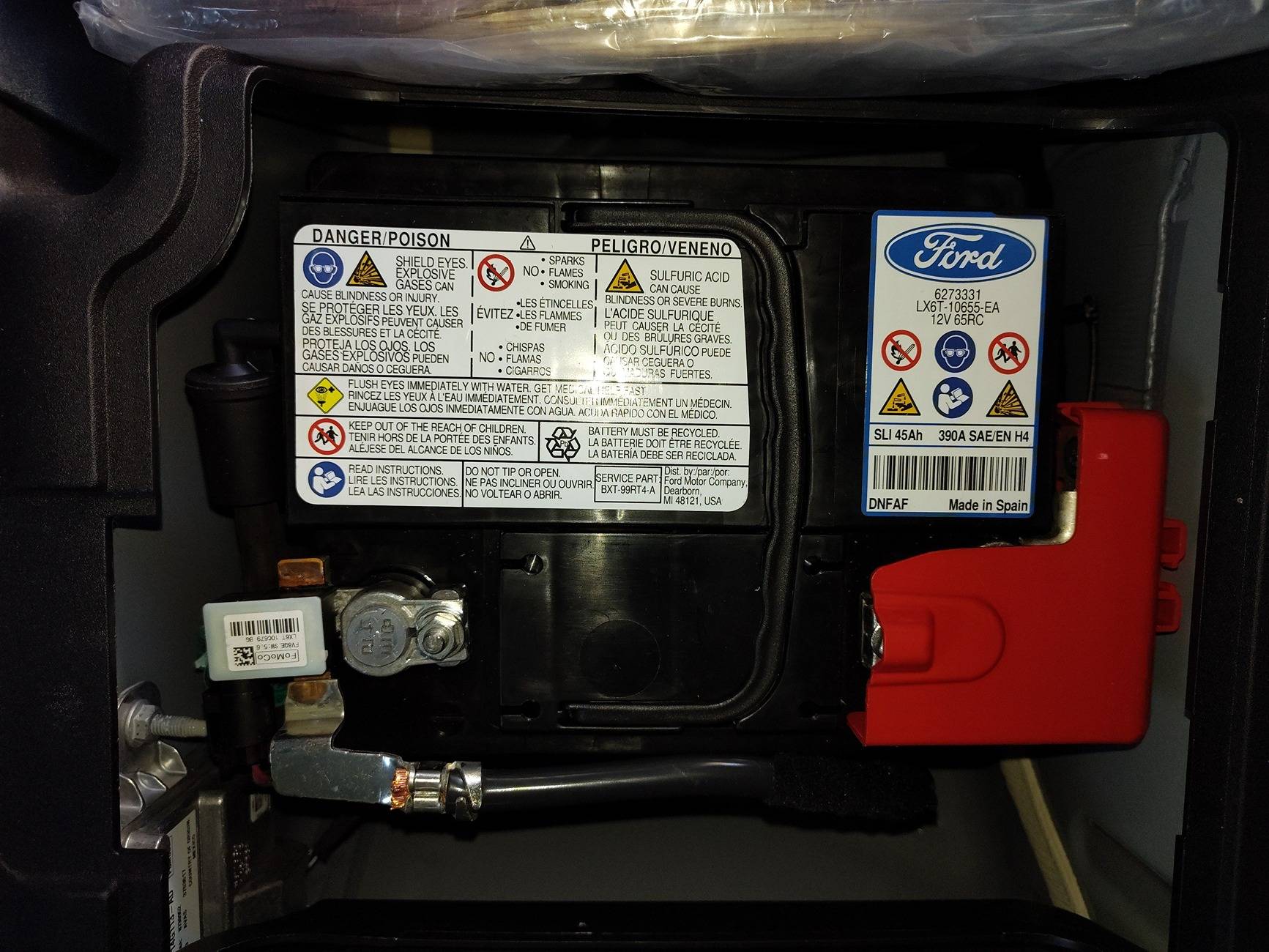

An H4 is about 3/4" taller than a group 99 size, so it would remove some of the air space above the battery....
Despite the label being the spec OEM 99R/T4, the Spain made OEM battery is H4 which is usually used on AGM types.
Plenty of space.

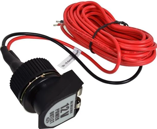

I suppose you could re-purpose something like this and run from the trickle charger to your bed.
Ford Maverick Deep Sleep temporary fix using trickle charger Screenshot from 2025-02-27 06-34-22
