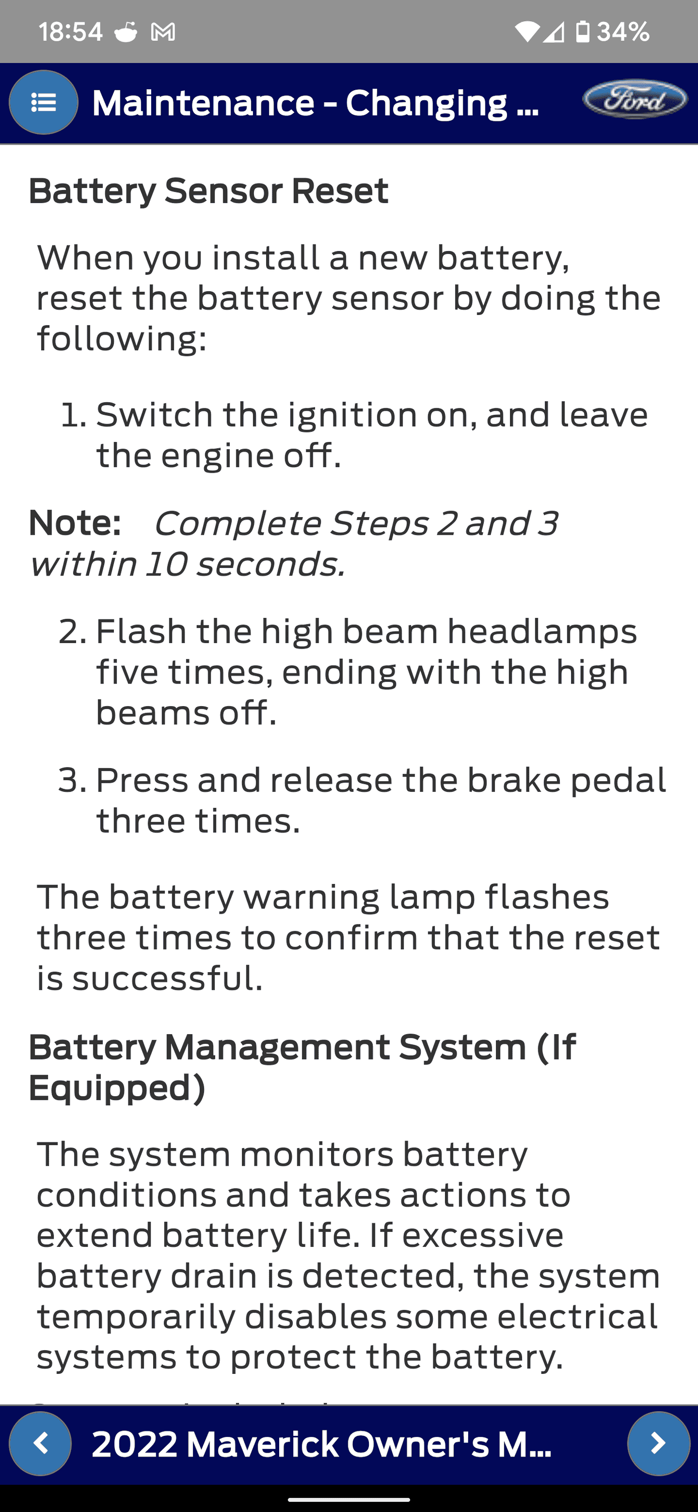

I'm trying to determine if resetting the BMS fixes this problem.
I reset mine on Jan 16th and have not gotten the Deep Sleep message since. Wondering if its coincidence or not.

Has yours done the Deep Sleep recently?
its so damn random. It did a few days ago but hasn't since - trying to understand the deep sleep issue is somewhat like trying to understand Ford's allocation and scheduling builds ...... LOL
