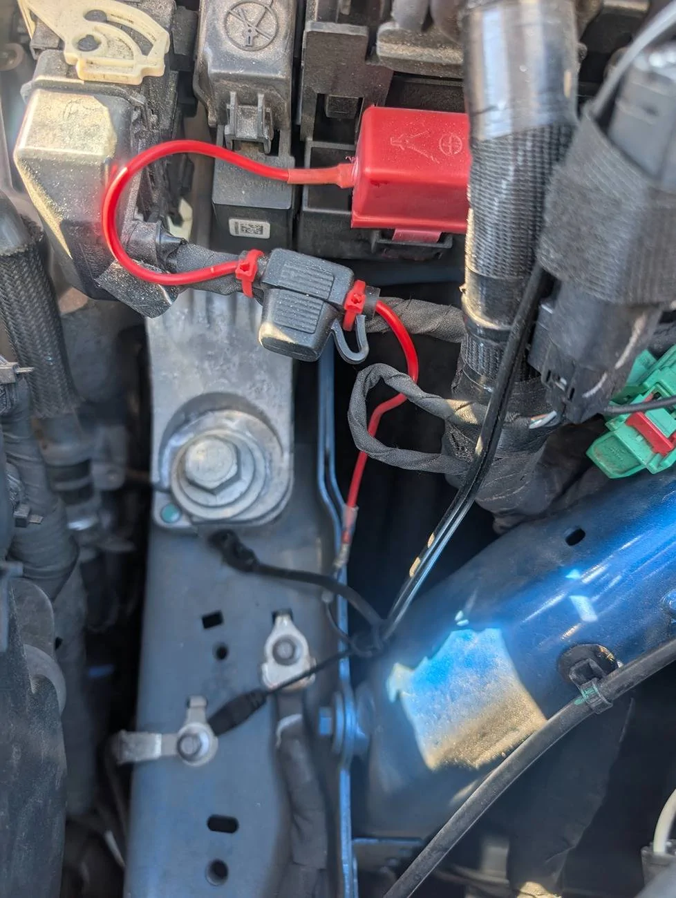

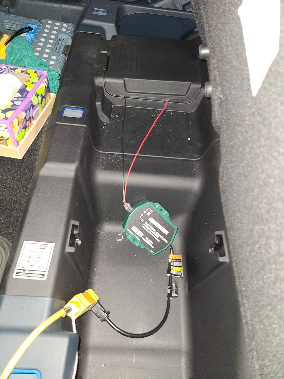

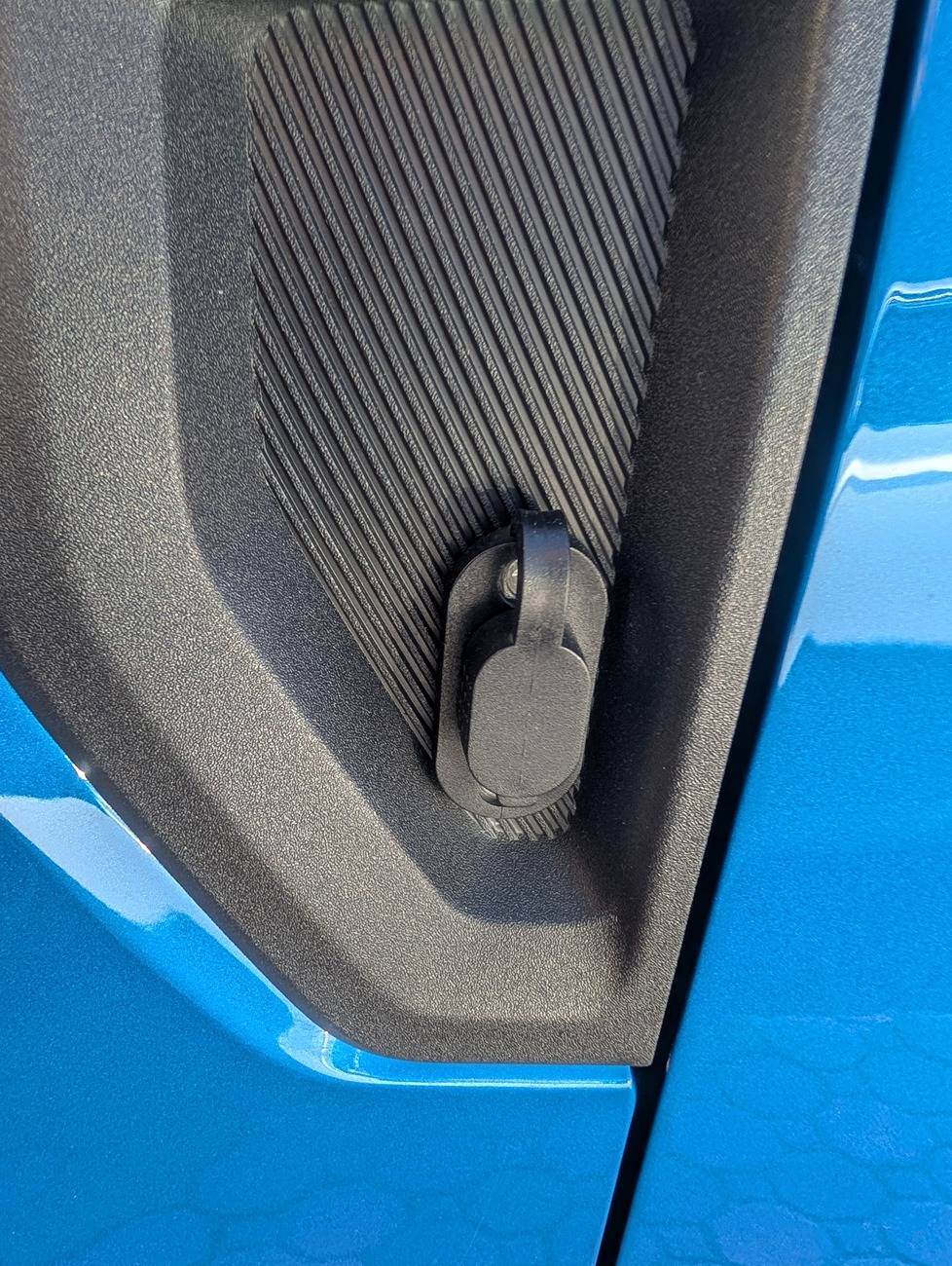

Here is my solution. I installed it many months ago and I use it almost every night to make sure when I come out to use my truck, the battery will be fully charged. I have had 4-5 times when the battery was completely dead. I installed a port in the plastic panel that shows the trim level. The wire runs inside and the negative connects to the frame and the positive attaches to a terminal with a red plastic cover. The positive wire is fused. The trickle charger plugs into and outlet just inside the garage door. the truck parks about 5 feet from the door. Attached are 4 pictures. this makes hookup very fast and easy and goes through the BMS so the truck is aware of the battery charge level. Has worked perfectly so far. When I hook up the charger, It always shows that it is charging, even after I just drove it. By morning, it shows full charge.
