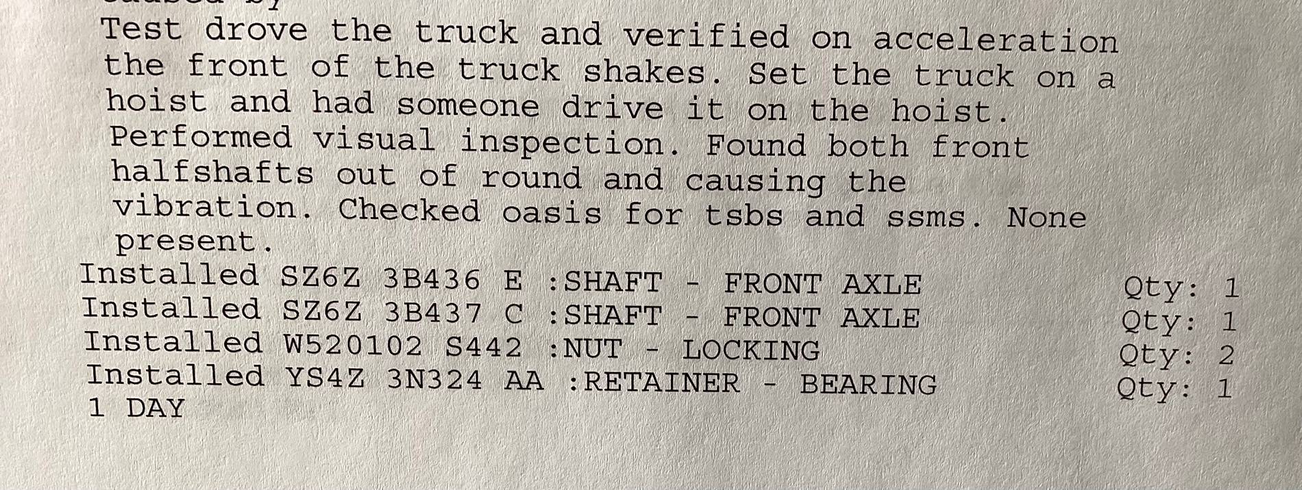

Started noticing vibration around 25K.
At 27K I took it into the dealer, just got it back One day turnaround, no waiting for parts.
They replaced the axle shafts with the new part numbers.
Everything is fine now.
Ford Maverick CV axle fix MIGHT be coming soon IMG_1505

My EB started to vibrate a few months ago. Dealership wouldn’t cover under warranty because of my 1” leveling kit. I paid up for Tremor axles. As a goodwill gesture dealer took $150 off labor and gave me another $160 in points.
Although it cost me money I’m much more comfortable having installed the Tremor axles.
Year, make and model?
