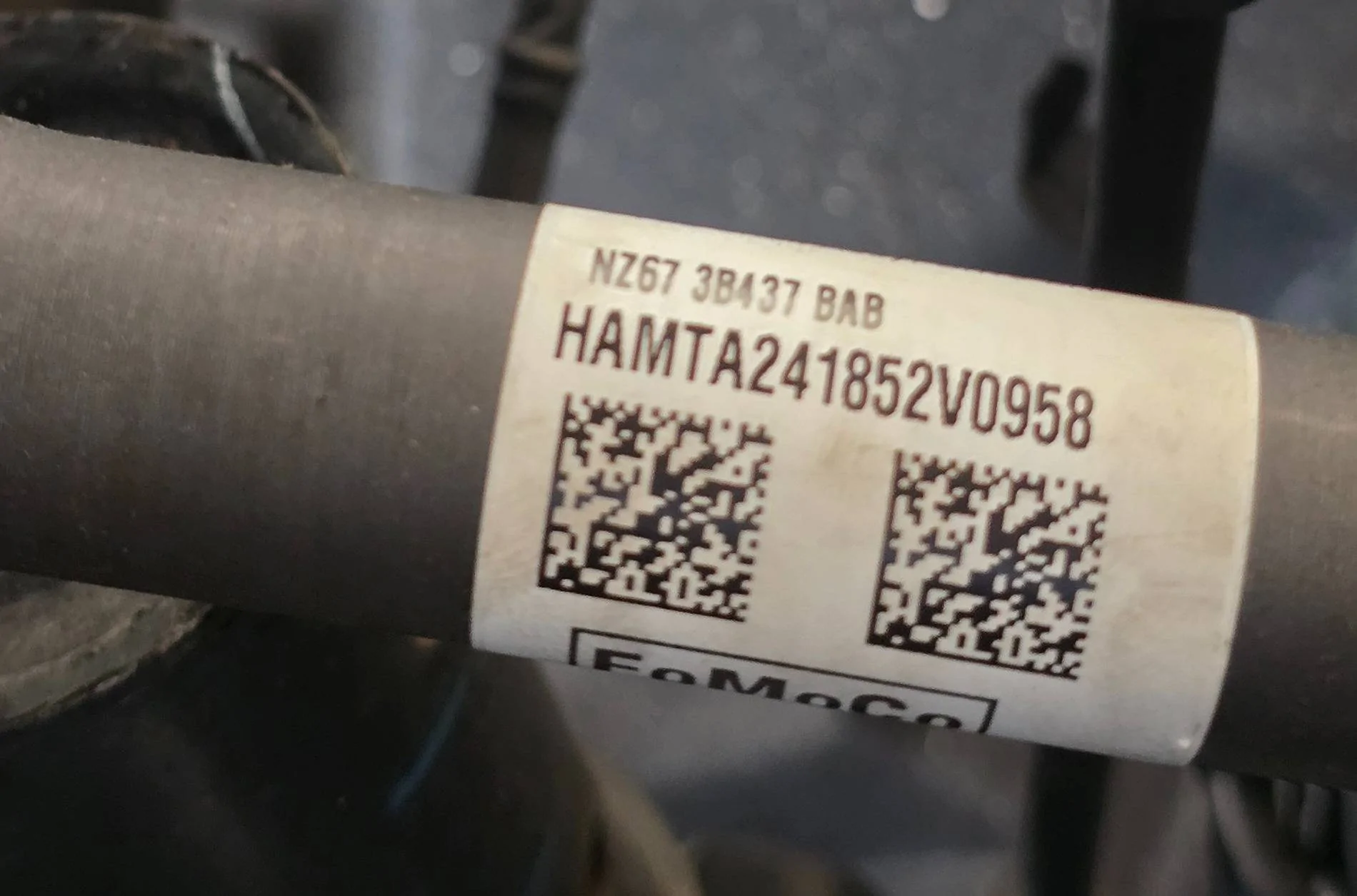

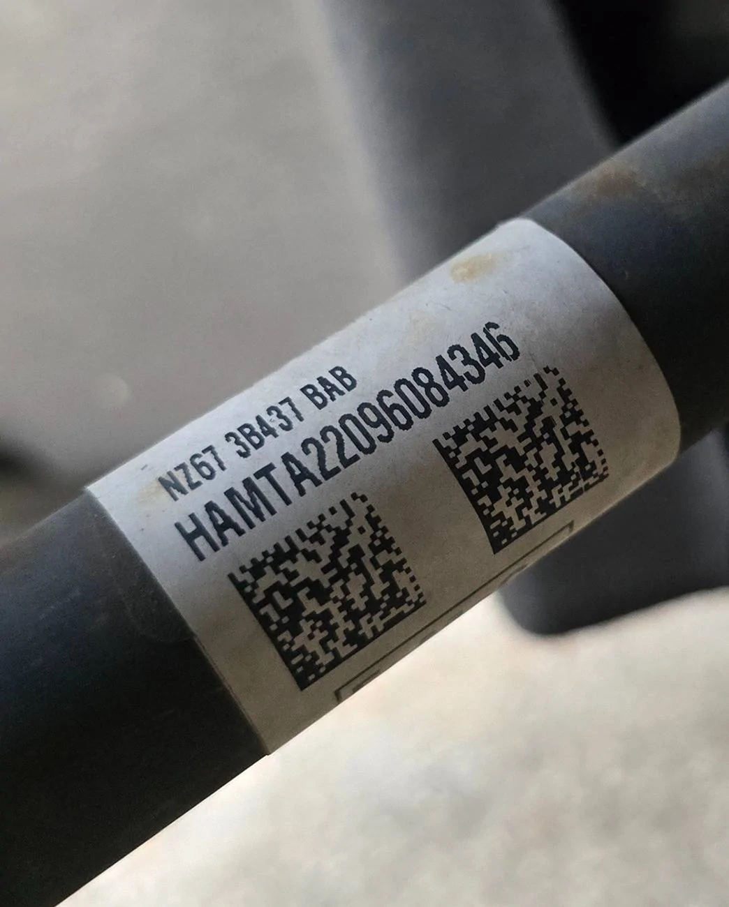

Below are my old CV axle and the new one. The base part number is the same but the number underneath it is different between them. Top is old. Bottom is new.
I'm guessing the lower number is just a batch number, and since they are the same part number they aren't changed at all? If so, that is disappointing. How do they feel though? Any visual differences?
Big number is serial number.
old made probably 9th week of '22.
new made probably 18th week of '24.
Rest is probably a batch number, and then unique serial number.
HAMTA probably means same model.
Of course the part number is the same.
Much like the FLA battery has the same part number put on it - to make it easy to know it's a replacement. Despite several post pictures showing differences shown in CA, CCA, RH, and made in country.
Same distance of shaft between boots?
I recall that being different from another thread.
