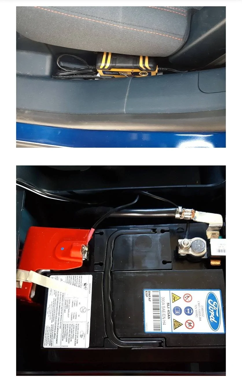

Fortunately, I have never had the dome light not come on.
🤔 A few instances in September, I had the interior lights not come on.
At that point, I installed a charger.
I ran the cables directly to the battery terminals. I charged the battery overnight. The next day, I pulled fuse 11/12 and did the battery relearn. I turned off as much communications as I could. That means no Ford Pass for me.
I haven't had a problem since. The charger leads are still directly hooked up to the terminals.
Anecdotal at best but it has worked for me.
