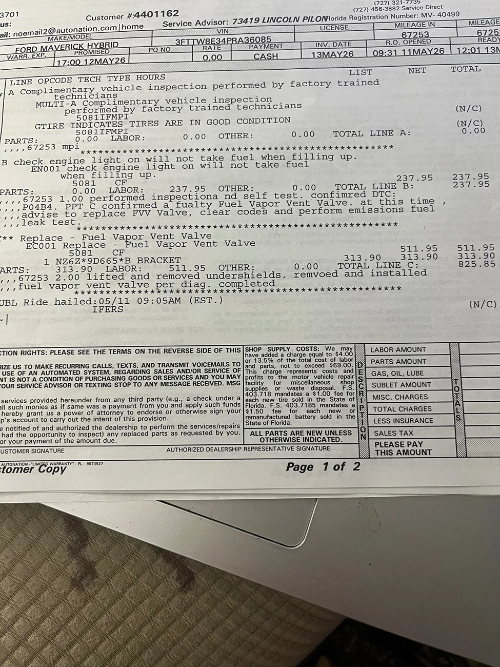

Last week I was going from Indy to St.Pete and stopped for my last fuel stop. The fuel door refused to open and a message came up on the dash saying it wasn't opening. It finally did so I started fueling. The nozzle shut off in the first 30 sec. and continued to do that several times. I tried to slow feed it but it still would back up and shut off. I squezzed enough fuel in to get home. The other day I noticed my CEL was on. Who knows when that happened. I haven't tried to refuel yet, but tomorrow I will go to ORiellys and get the code. In three years and 67K miles I have clicked the nozzle 2 or 3 times.
Most likely a problem with one of the evap system valves. The fuel door doesn't open until the tank pressure is zero. The valve is likely sticking causing the pressure not to drop in a timely manner. That's why your fuel door wouldn't open

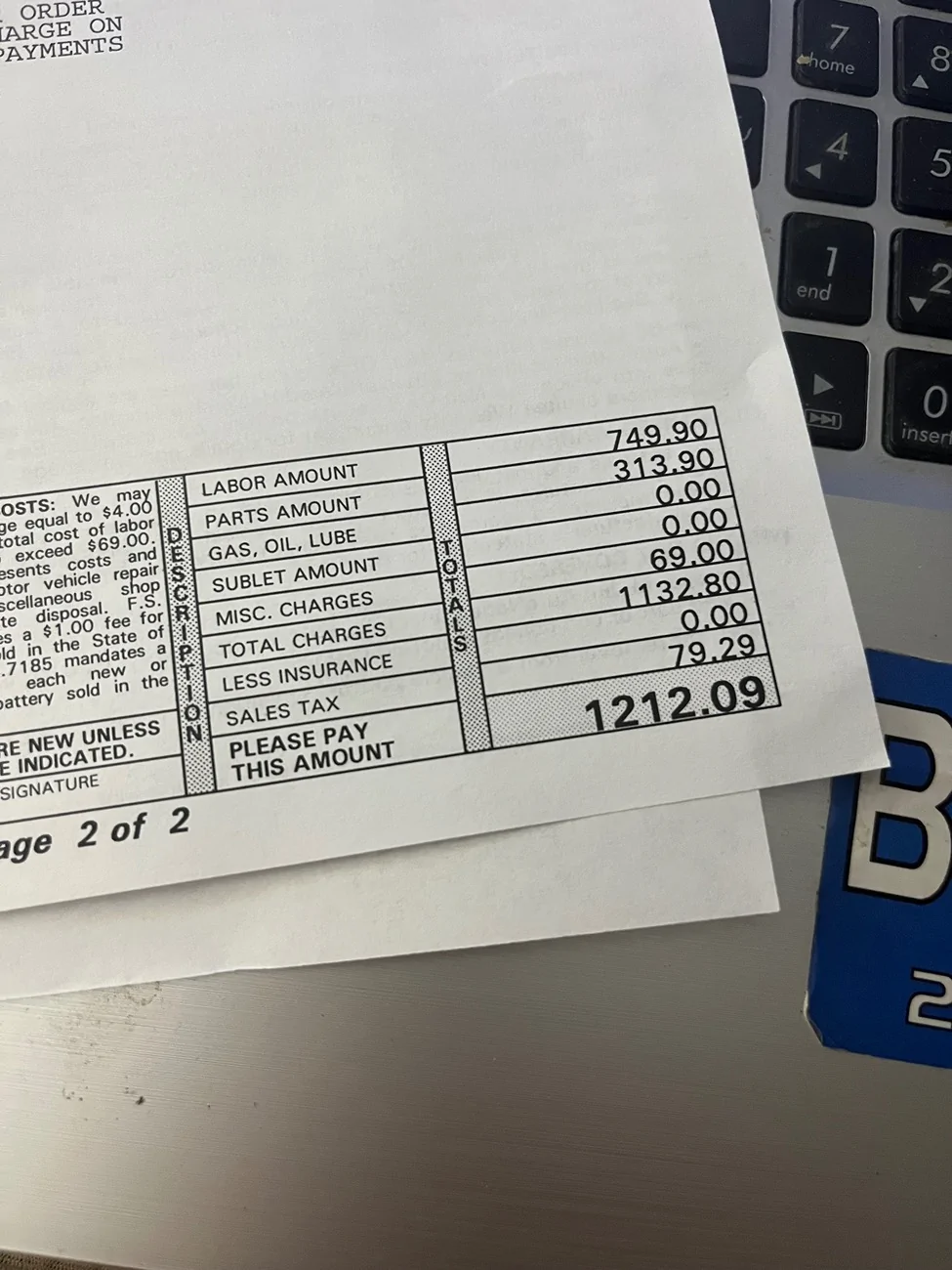

I took the maverick in on Monday and got it back on Wednesday. I still haven’t put any fuel in it yet. I will tomorrow. I’m driving it up to Indy in a week. I didn’t get the extended warranty and my 3 years was up last month and I’m
Ford Maverick CEL after over filling tank, anyone else? IMG_5350
Ford Maverick CEL after over filling tank, anyone else? IMG_5351
at 67k miles😕.

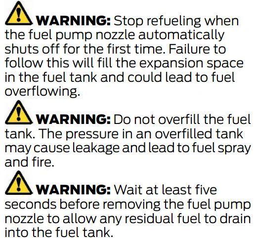

Just to add to this (old) thread - from the 2026 owners manual:
Ford Maverick CEL after over filling tank, anyone else? do not
