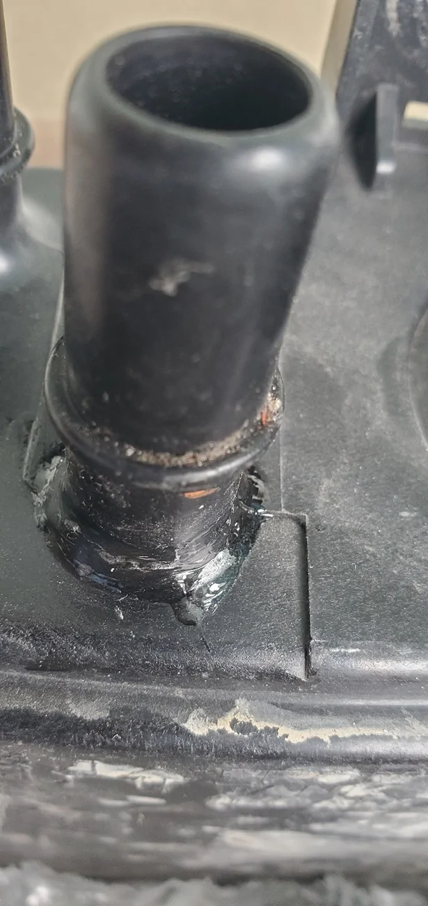

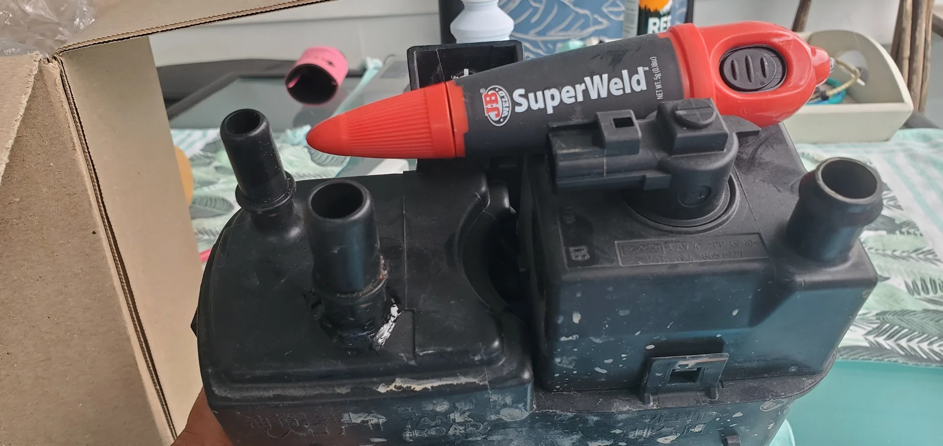

This was the cause of my CEL wouldn't reset. A broken line fitting on the charcoal cannister on a line to the tank. I repaired it with JB Superweld light activated the picture. 2800 psi light activated clear glue that you can buildup as thick as you want and sets instantly with the supplied UV light.
Ford Maverick CEL after over filling tank, anyone else? 20250912_134717
Ford Maverick CEL after over filling tank, anyone else? 20250912_134905

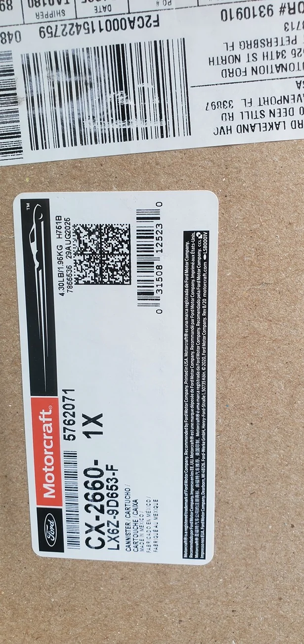

I kept this one for a spare, just in case
Ford Maverick CEL after over filling tank, anyone else? 20250912_151738

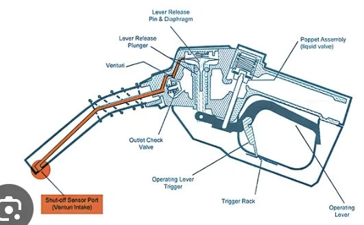

The pump’s shut off sensor (click) is near the bottom of pump spout. Not much space in the fuel tank’s filler neck to take more than a few ounces more. The gas left in the pump hose will go into the next vehicle’s tank. Hope they appreciate the bit of free 91 octane upgrade:)
Ford Maverick CEL after over filling tank, anyone else? IMG_9613
