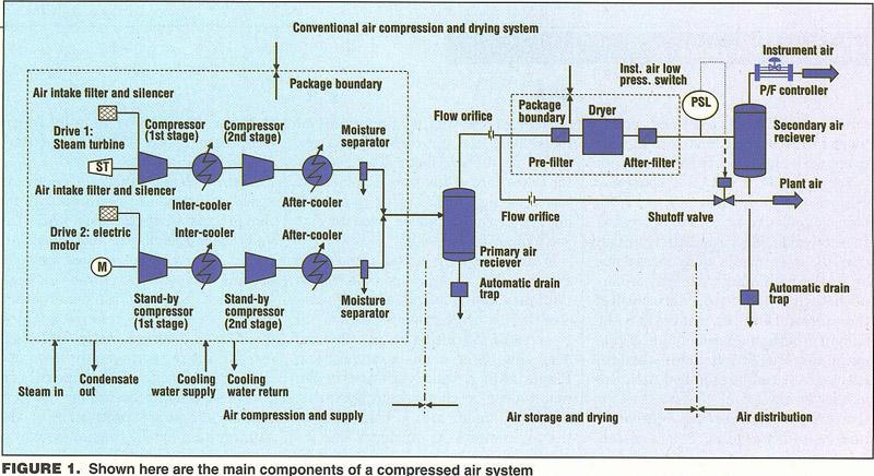

Why doesn’t this industry call them what they actually are?AFTERCOOLERS
INTERCOOLERS fit between two different stages of compression, to remove heat from the first stage before it is further compressed in the second stage
After coolers remove heat from the final compression stage so if you only have one turbocharger that cooler is not a intercooler.
And yes you can over cool compressed air by having a improperly sized cooler. In high humidity conditions, too big of cooler can condense moisture in the charged air that collects in the cooler and may slug feed water into the intake system….bad….this was a know problem in the first gen 3.5L ecoboost F-150. Fords fix was to block off part of the air flow thru the cooler to make it LESS efficient there fore raising the charge air temp above the condensation point.

Aren't aftercoolers typically air/water? At least the older diesel ones I used to see were called that.
You're thinking about it wrong. "Intercooler" is the standard name for charge air coolers that cool the air between the turbo and the engine (in between cooler), and it was only on some old aircraft where they added a second intercooler that they figured they should give it a different name to help distinguish which they were talking about and so called the second one the "afercooler" instead of "second intercooler"... less syllables I guess.
Since automotive applications don't have sequential turbos with two charge air coolers, they wouldn't have an aftercooler, and people will get confused if you call it that as it implies you have two.

Here's what might be a dumb question but I am not a mechanic:
Does this thing directly cool the compressed air from the turbo or is it full of coolant like the engine radiator?
It is an air-to-air heat exchanger. It cools the compressed air, by transferring the heat to ambient air.
35 years of working in large thermal coal power plants, I beg to differ. “Inter” means in between stages in this reference. You cool the charge from 1 stage only of compression….you aftercool…if you cool the charge between 2 separate stages of compression you Intercool. I have worked on 6 stage centrifugal compressors that multiple Intercoolers and an aftercooler located after compressor. Every P&ID of L* systems (IEEE) i have ever seen support this claim
