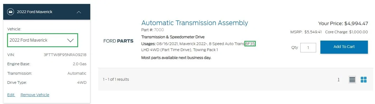

Any concerns on the transmission with the power gains? Everything out there says 8F35 which is borderline for stock power based on what Ford says it's rated for.
However there is one member on here who said 5 Star told him it's the same trans in the Edge ST which is the 8F57
I personally do not have concerns, however, this is out business, we modify, find the limits and correct them.
Is it possible the FX4 and 4K tow use the beefier 8F57 while the fwd 2.0 uses the 8F35?

I had my local dealer check the trans model in my truck and wrote it down, I can't find those notes.....I do remember the trans being the mid-grade option.
