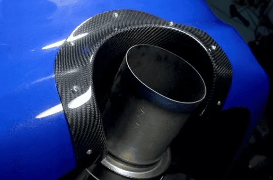

Any plans on having something that can be routed through the bumper with a heat shield as illustrated by this picture?
No plans for that. The majority of people are going to want to keep this an easy bolt on with better ground clearance than stock.

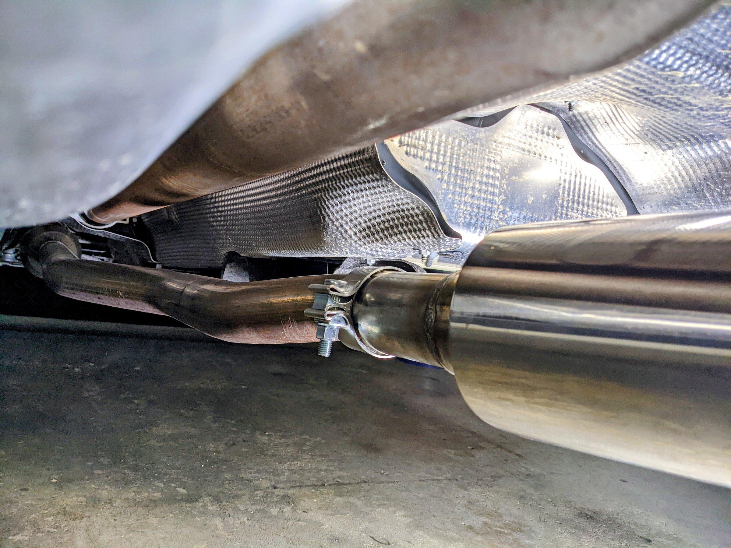

Same here 55! I installed another custom exhaust on my Maverick where I had to cut off the factory system at the very front of the mid muffler. If I order what were are discussing can I fit/install your exhaust? The pic shows the pipe cut location. The cut was 1/4" forward of the factory mid muffler. What you see here is a resonator in place of the mid muffler.

Our system is built with an integrated reducer, made to fit exactly to the factory sized exhaust tubing. So our system will also require the stock exhaust to be cut then ours slides over and is clamps, like in the pic you have here. Our system gets cut, if I remember right, about 3" behind the secondary cat. We will also offer it to cut closer to the front eliminating that secondary cat and then we can add just a straight pipe or a resonator there. My truck will use the resonator.
For reference, the mufflers we are using I used on my Mitsubishi EVO8. With a muffler and resonator the car put down 680 whp and ran 9.04 at 159.6 mph in the 1/4 mile, so the muffler/resonators we have and are using flow a lot. That's also a 2.0 four cylinder.

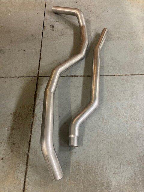

Do you have any pics of the variations?

This is the only pic I have that I haven't already posted pics of. This is the actual production exhaust, first one off the bender. All one piece, 304 grade stainless, SUPER LIGHT WEIGHT, with the reducer built right into the tubing to slide over the factory exhaust. I have to get an open bay to get the truck back in the door to build it all and check fitment. The hangers will be direct replacements and use the nice factory rubber hangers, hangers are also all 304 grade stainless. This system will out last the life of the truck, 304 does rot/rust. I have systems on cars that are over 20 years old.

Thank you!
