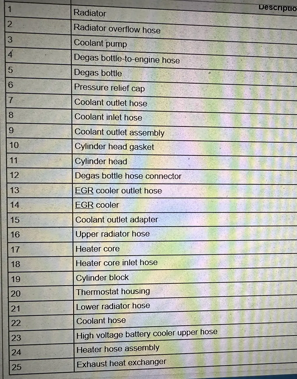

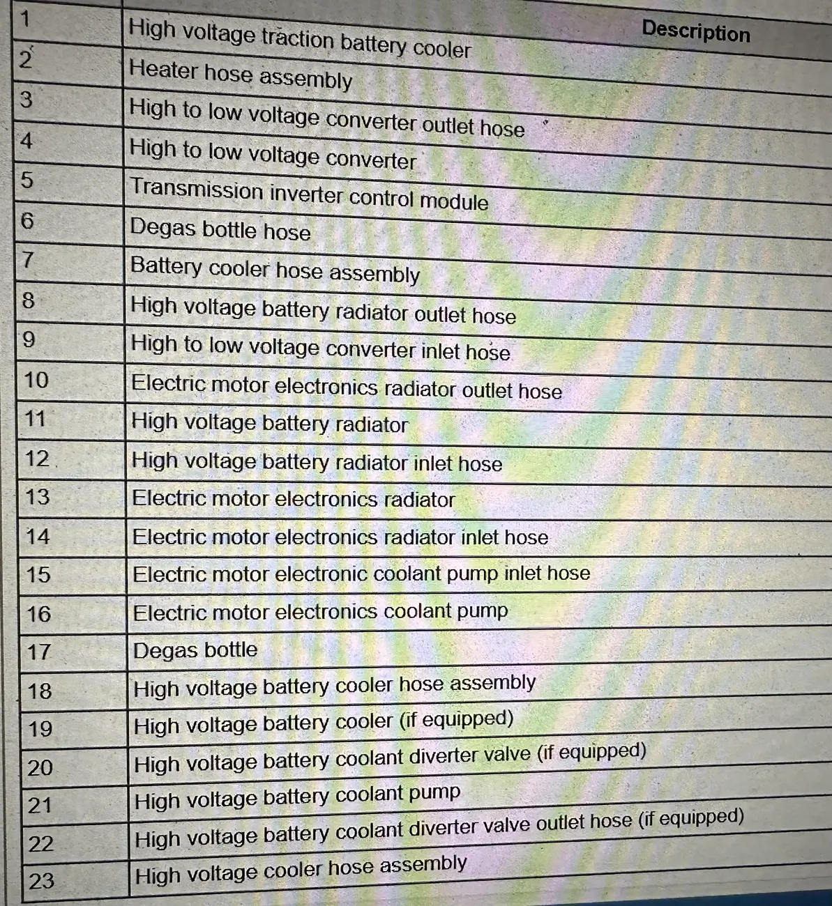

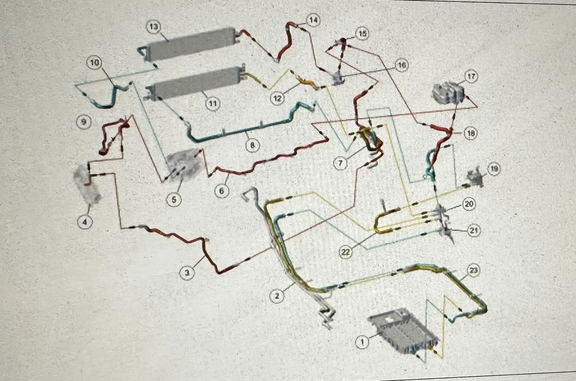

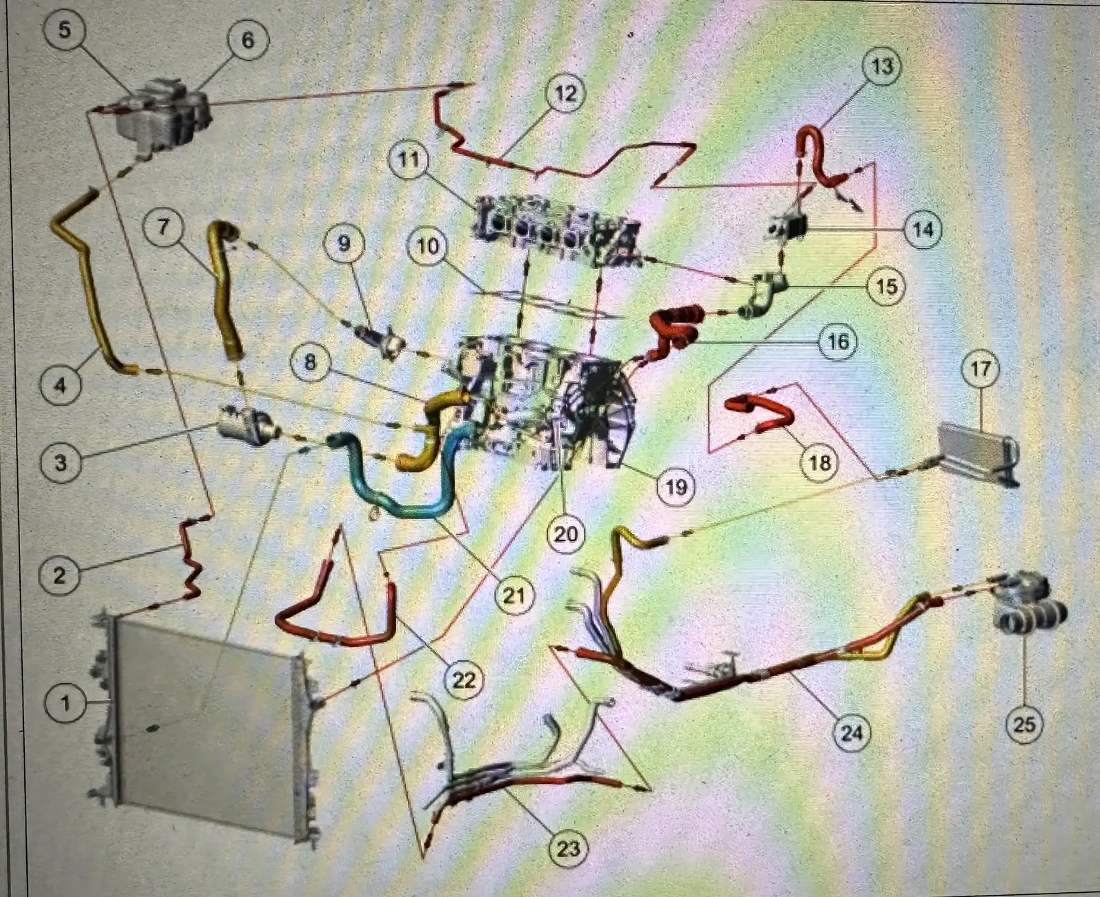

weird name for a radiator. The coolant system is all together even the engine and hybrid stuff shares coolant reservoirs . I don't think buying the eco boost would have prevented this according to what that dealer said. Their is no special radiator for the battery.Their is a main radiator and a heater core, then maybe a Aux radiator, and a AC condensor.
The two systems actually have separate reservoirs and don't mix fluids at all. The hybrid radiator is different as it maintains separate core lines for each fluid. I (personally) would need to know more specifics to know what (if any) damage would have been inflicted to an EB in this instance. Might have even been something immediately obvious and/or disabling.
That is true! i assumed they shared the systems. They do have 2 separate coolant reservoirs that are made as 1 unit to save cost so you are right. The smaller one is used for battery, ECU's and motor unit. The big ones engine only. I looked at the hybrid diagram before posting and did not see a separate radiator which made me assume it was one system. I was only looking at one of the diagrams! I will revise my wrong post.
"Both are independent of each other. Separate heat exchangers, pumps and reservoirs. They are not interconnected and operate at different design temperatures to accomplish different tasks"

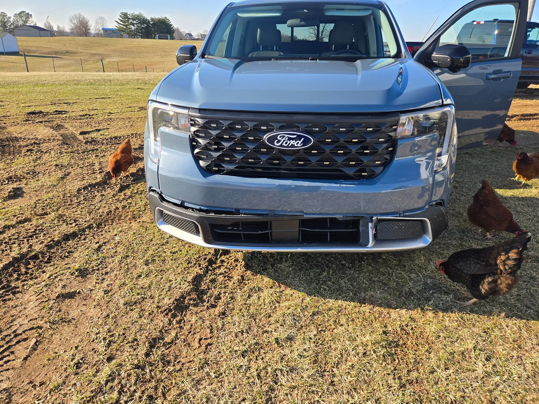

Five weeks ago, my wife had a minor collision with an SUV that caused some cosmetic damage to my left front bumper. (It caught the right rear bumper of the SUV in a glancing blow.) No dents, no major scratches, and the no air bags deployed. It cost all of $80 to buff away some rubber residue and apply some touch up paint. Fast forward to last week, when I noticed a small puddle on the garage floor, and later that day the truck stalled and was towed to the Ford dealer. They informed me that the high voltage radiator (it cools the high voltage battery) and some grill shutters have suffered impact damage, which will cost $3,258 to repair. I'm really surprised it took a month for the damage to manifest itself. And, if I had known the hybrid was so fragile, I would have opted for the Eco-boost.
I feel your pain. A seemingly minor collision with no air bag, no dented painted sheet metal, $10k and four months to repair.
