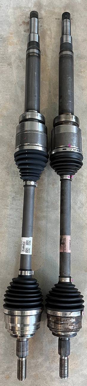

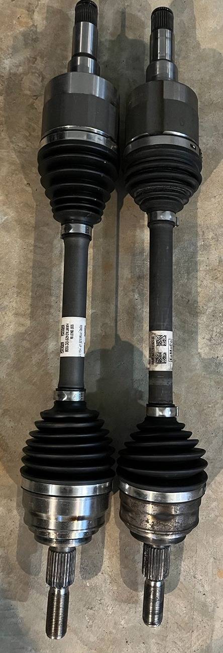

35,700 miles and I got the vibrations from stop to heavy acceleration, and again from 50-60mph, and a quick search through the forums suggested the axle was bad. The dealership was well aware of the situation having done numerous Maverick axles. It took three total days including ordering the parts and installing them. I asked for proof that they actually replaced the axles and didn't just replace the CV boots, and what I got were some pictures sent to my phone, but with no date details or EXIF data (underlying metadata) to prove when the pictures were taken. I have shared those as attached files.
I have driven the car about a hundred miles since the repair and none of the vibration issues remain. I assume they did in fact replace the axles, but I haven't pulled off the belly pan to physically inspect the parts.

Maybe I'm just paranoid. The likelyhood is that you're right and they did the service. Does the axle seen in the pics look like a Maverick axle to you?
Turn your front wheel.
Look at axle.
It'll be obvious if new or not.
Just to assure yourself.
Yes, they are Maverick axles. You would need to check the actual part numbers to see if they were replaced with the upgraded versions. I would guess they were since I would not expect the old version are still available. I just replaced a set on a 24 Hybrid. Pretty easy job.
