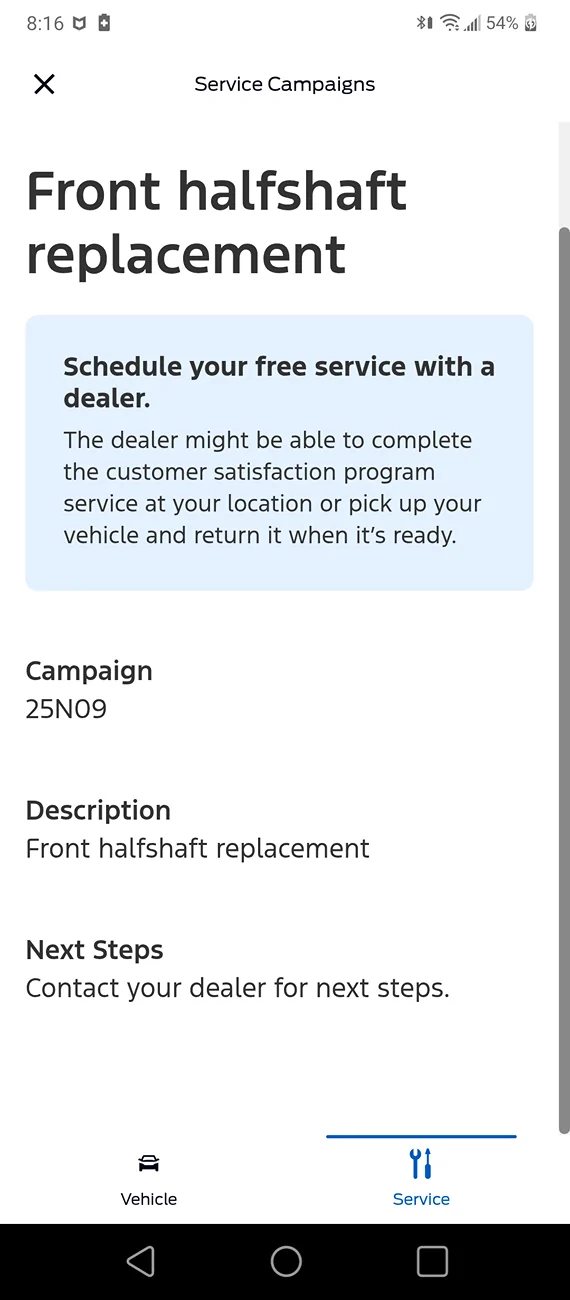

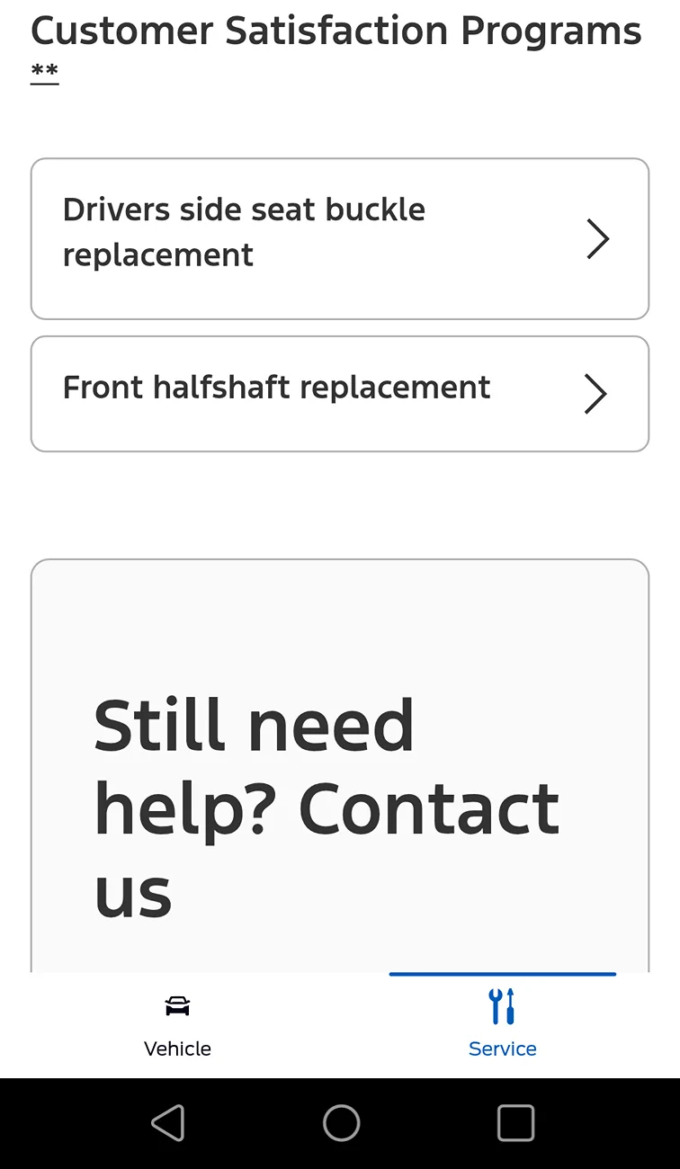

Ford sent out a notice extending the warranty to 150k miles regarding the cv axles..The original warranty was to 60k miles..You should see this in your ford pass app under service then customer satisfaction pr

im not sure but wouldnt they be covered under the 5K/100K powertrain warranty ???????
CV Axle replacement is now covered under a customer satisfaction program titled half shaft replacement...I found out this extends to 150k miles...It can be found in yoyr ford pass app under the service tab
Yep I knew about that for the MY22 builds, I got the memo from ford on mine but didn’t know the other posters year model

CV Axle replacement currently just for majority of 22MY is now covered under a customer satisfaction program titled half shaft replacement...I found out this extends to 150k miles...It can be found in yoyr ford pass app under the service tab
Fixed your post above to be accurate.
Many times those generalized statements that aren't correct lead to confusion.
