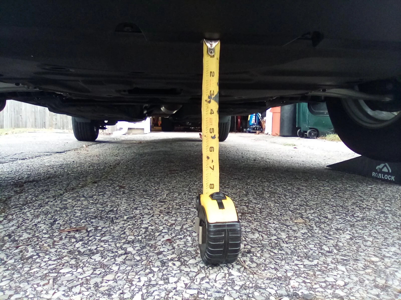

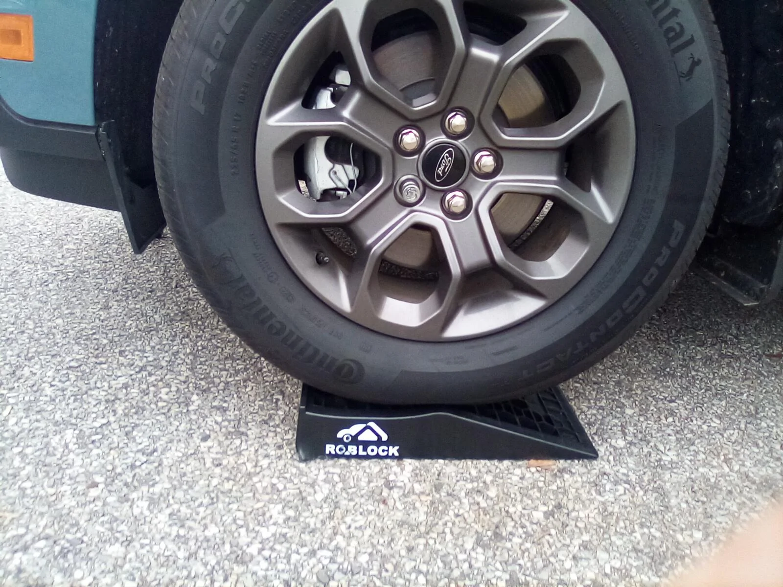

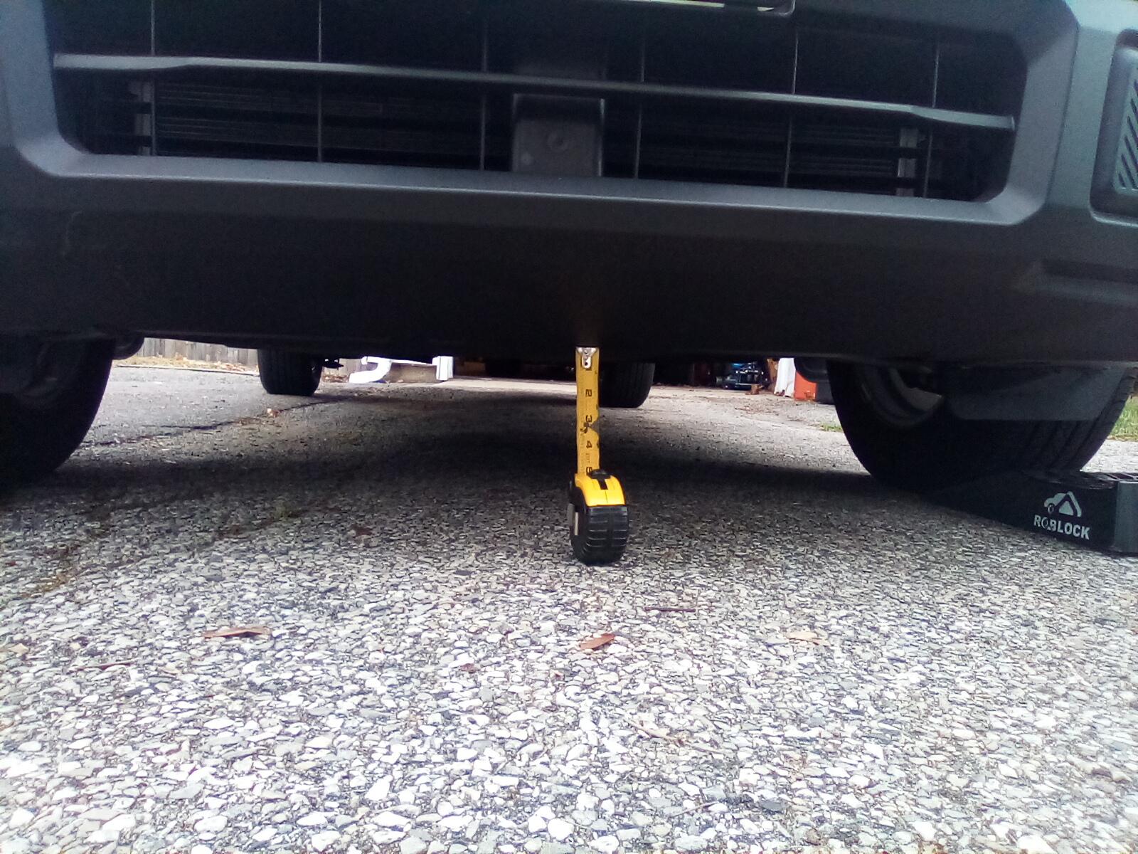

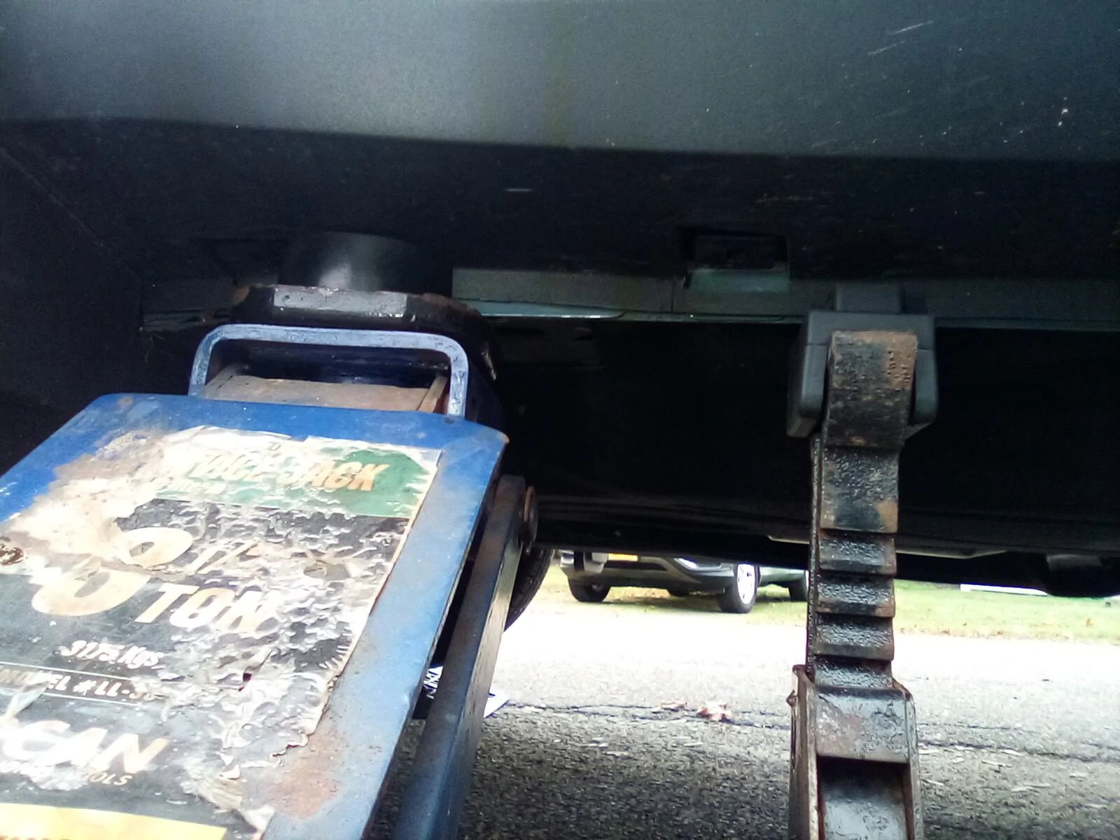

I bought these ramps, lifts the Mav a little under 3 inches. Should be enough room for oil change. If not I'll use my floor jack and jack stand.

Yea not enough space to crawl underneath.
That said, you can get to the tranny drain plug without the ramps and it's advisable since it would keep the truck level without having to jack the entire truck up. Simply turn the wheels to the left and there ya go. You will need an extension though...
I wouldn't even use that on a bicycle. ProjectFarm just did a good video on Jack Stands just did a good video on Jack Stands and it's pretty surprising how many cheap flimsy stands are sold now days.
For those interested here is the ProjectFarm video on Jack Stands:
Very cool, if they aren't too expensive. I tried crawling under my hybrid before changing the oil, and it was too low. I ended up rolling up on a couple of 2x6s, which was barely enough. This seems like the perfect height, and more professional than 2x6s.
$40 from EBay for the ramps.
And some chock blocks hopefully.

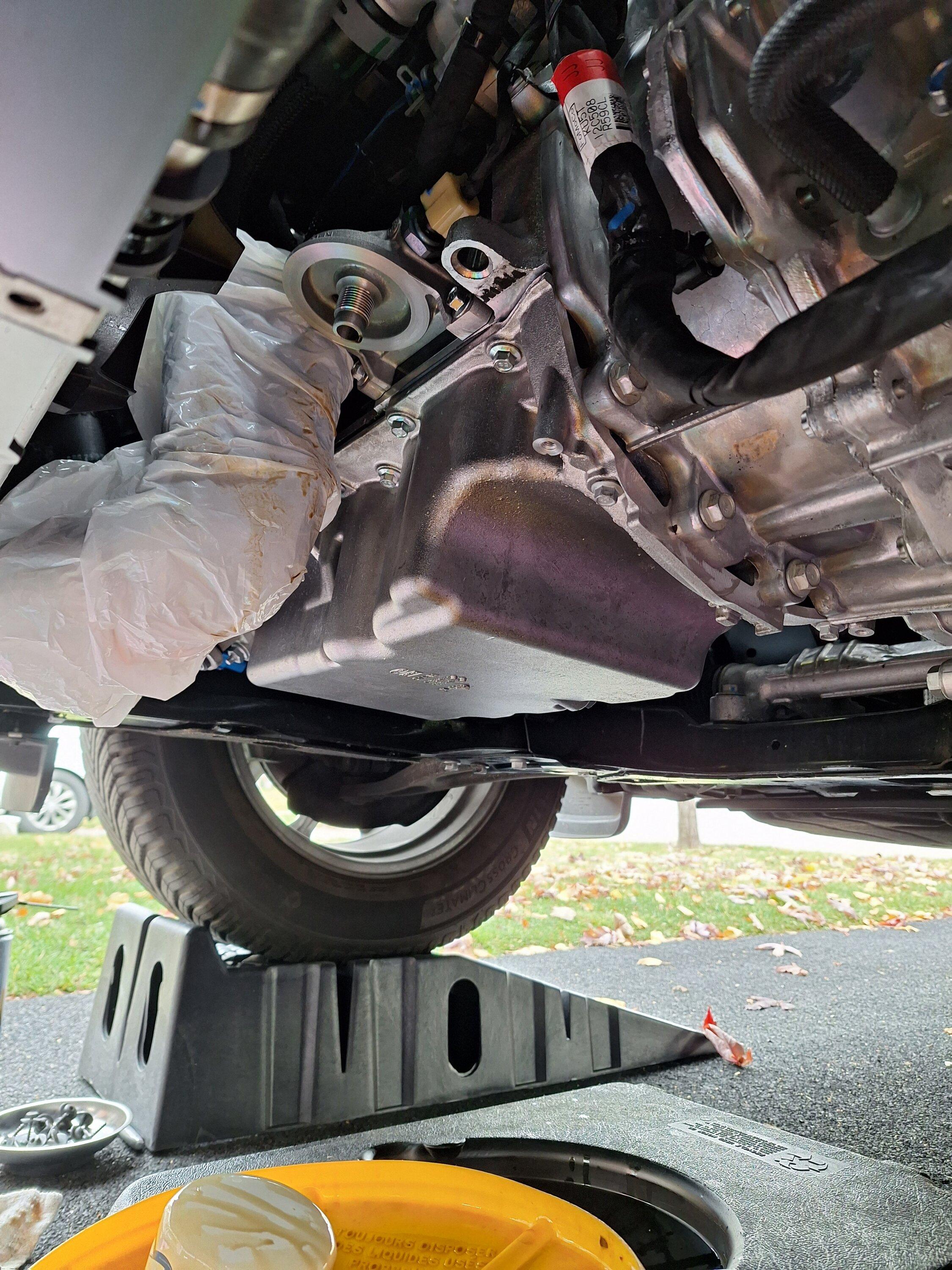

Don't think I could have changed the oil/filter without ramps.
- there are a boat load of torx screws holding the bottom baffle thing on. The screws toward the rear would be particularly challenging to remove without [safely] lifting the vehicle a bit, imo.
- the factory oil filter seems to have been installed by Thor... so I appreciated the extra space to wrestle it off
- free tip: I covered the lower coolant hoses with a plastic bag (pictured) to shield against drips coming out of the filter housing when spinning the old filter off.
Not sure it will be easy on Maverick but try punching hole in filter first.

I prefer jackstands over ramps. Easier to store, less hassle driving off the ramps.

Good idea. I'll give it a go next time. Thank you!
I tried that. It helped a bit, but enough oil still spilled out upon removal that it didn't matter.
