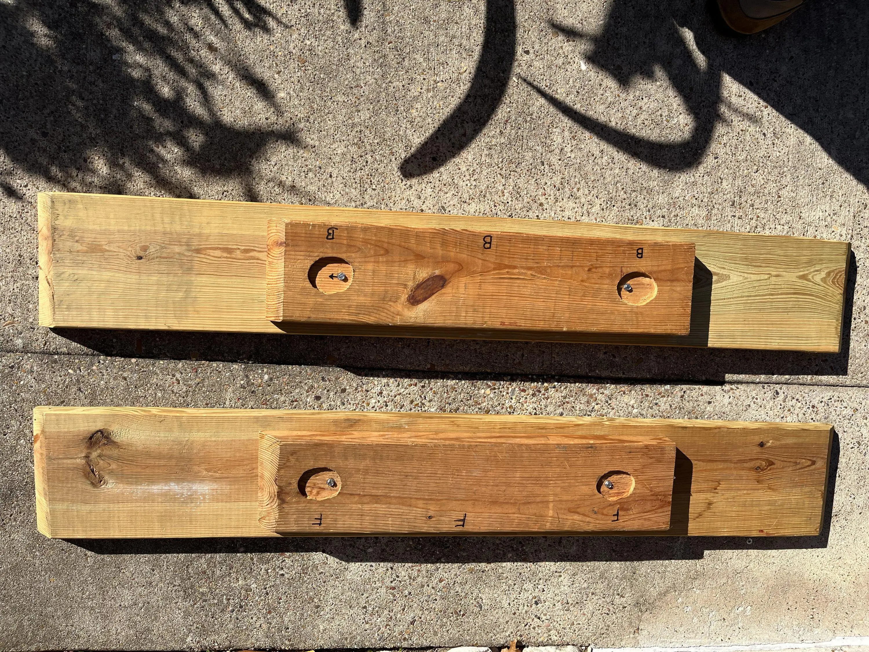

Have the Rhino plastic ramps I used with Ranger and cars. Will use them with the Maverick.
Out in the garage today and saw my wood risers I used when I had a 3500 and didn't trust it the plastic ramps.
