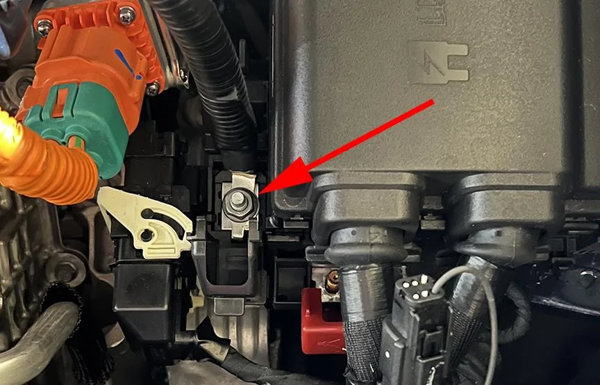

I just went out and hooked up my volt meter and shook the living hell out of that cable and the voltage remained at 12.33 volts. If there were a bad joint, the voltage would have bounce between 12.33 and 0 volts.
This connection, correct?
Not my first rodeo. Yes, that connection.

You are in great shape. I still would wiggle the cable shown is earlier post while someone watches the meter to see if the voltage bounces around. At home of course.
Also, the meter just pulls out if you only want to use it to see how the battery and charging system are operating.
That is not a bad ground. that's a hot wire from the battery also connected to the cigarette lighter socket. Those points are at 12 volts even with the truck off for about 5 minutes.
