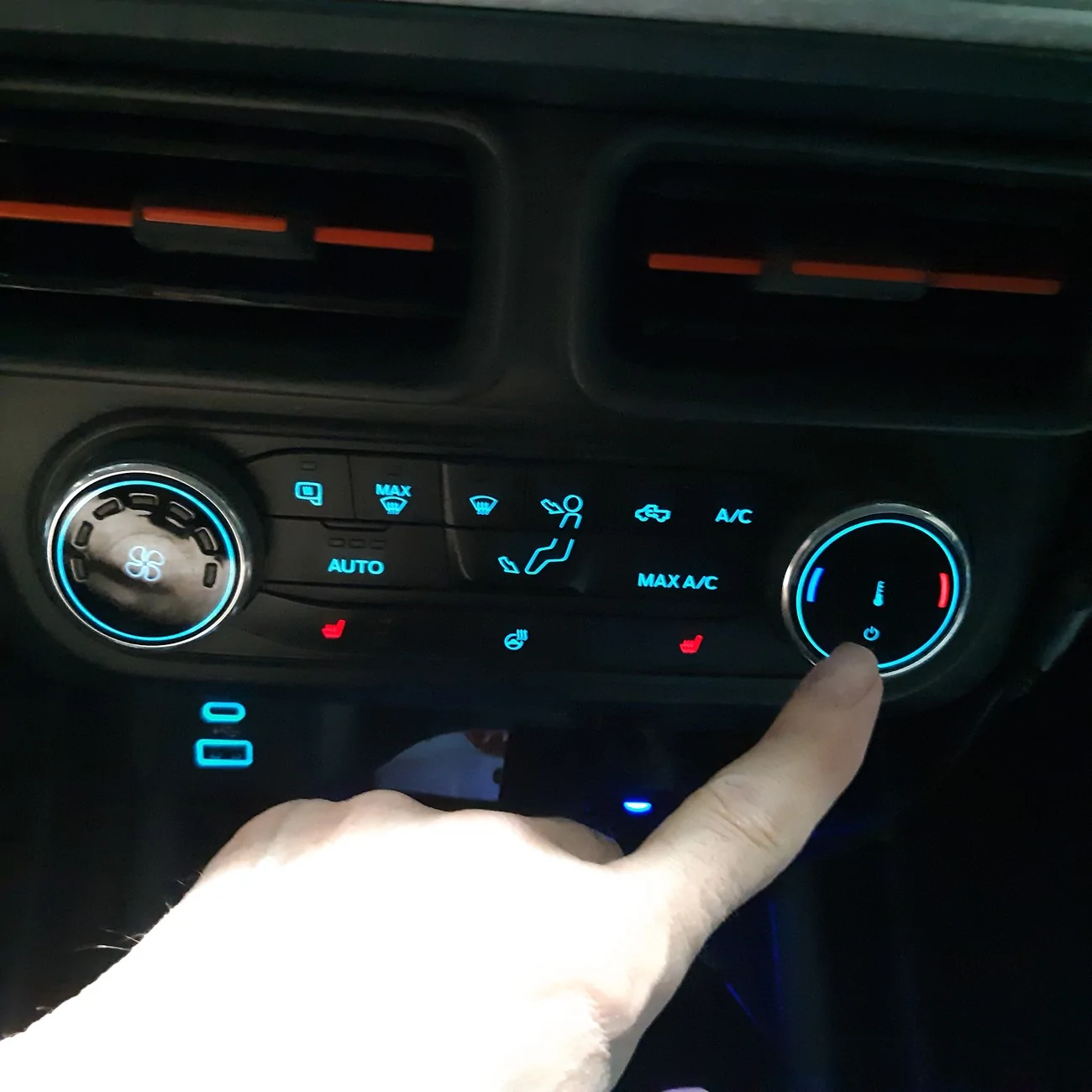

On our older models 22-24 that have buttons and knobs. I don't know if folks realize that the temperature selection button is actually the on and off button too.
I knew that on my 24 since day one, how you ask, I read the β€œManual”! πŸ˜‰

What "button" or indicator are you using to turn your climate control totally off?
The big button you show in your videos that turns off all the lights for fan and vent selection and AC.
The only big button that pushes for Single zone control.

Do you have this button
Do you have a picture of your button?
That is the only big button that pushes I referenced from your video - not taking a picture as it's exactly the same.
On/Off icon on it.
Yours is off since no fan speed showing.

SWITCHING CLIMATE CONTROL ON AND OFF
Ford Maverick AC always come on at startup? imagen2
Press the button.
