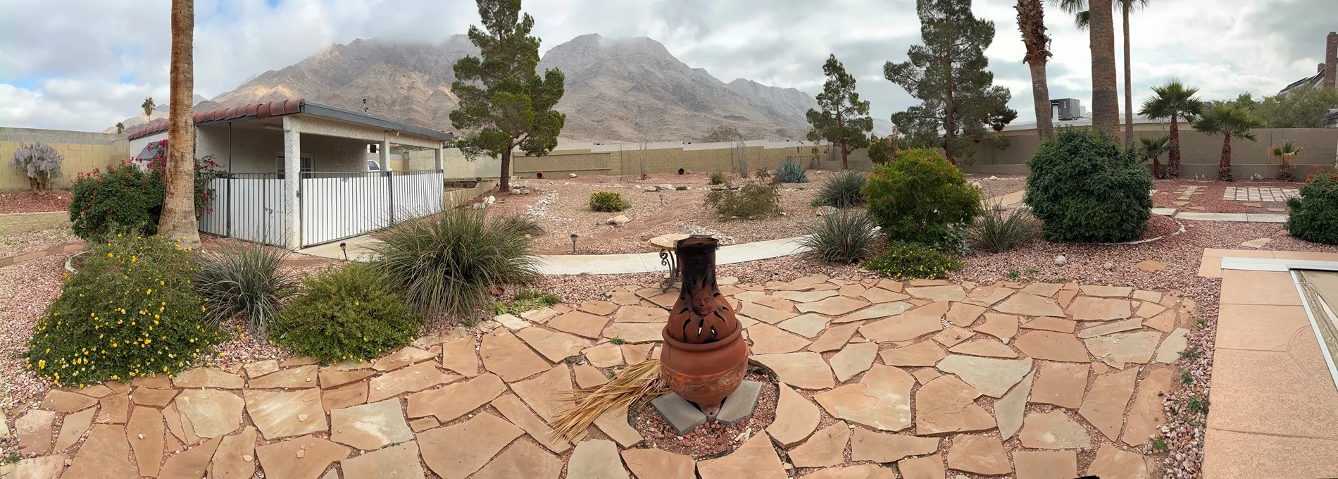

Here in the Mojave Desert, we have Virga, rain that falls but evaporates before it hits the ground.
But we do sometimes get enough fog to notice.
A couple of weeks ago, I looked out my back window and my mountain was missing!
Ford Maverick How to stop automatic AC on at startup? IMG_0805
I think it's a quarter or half mile past my back fence. (view is panoramic).
Here's more normal, but still with some fog:
Ford Maverick How to stop automatic AC on at startup? IMG_0816
Oh, and on the ground, we don't normally get even close to 100% humidity when it's raining!
