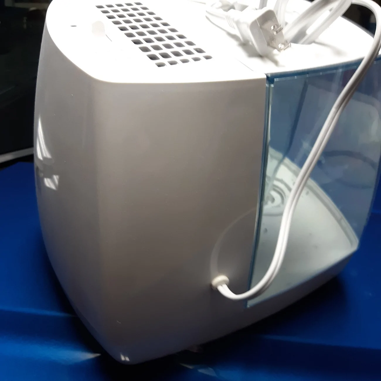

I'm in the Mojave Desert too.
I tend to agree with you it's tough to get humidity here.
Therefore to test the humidity Theory. I'm going to run a small humidifier in my truck to boost the humidity and see if it automatically activates the AC.
