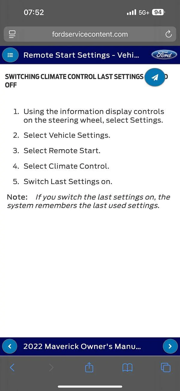

Maybe try this.

This states it's "Remote Start" settings. Will this then apply to just standard starting with the key? I guess I will try it and see. If it works, then poorly written instructions. If it doesn't, then still sloppy coding.
Sometimes settings are shared. It’s worth a try.

On mine, when parking I turn the AC off and then the fan off. This keeps my 25 XLT from being on at start up.
