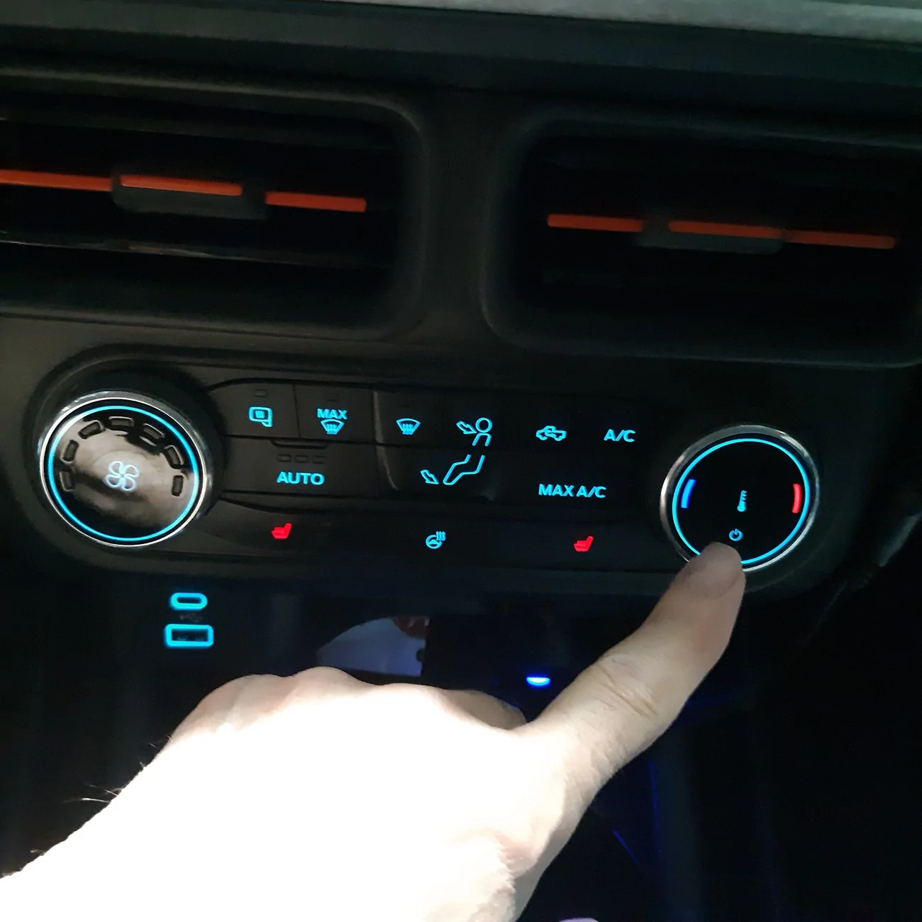

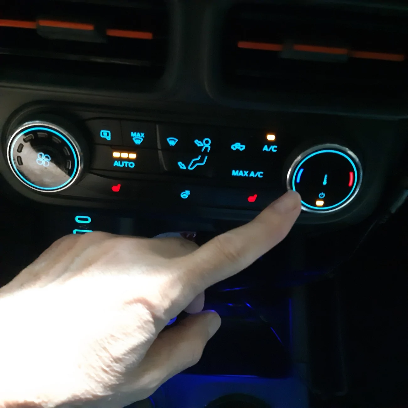

Mike, @MikeS1942 You're turning this button off prior to turning your truck off. Is that correct?
Ford Maverick AC always come on at startup? 20260518_070328
And it's turning back on when you start your truck?
