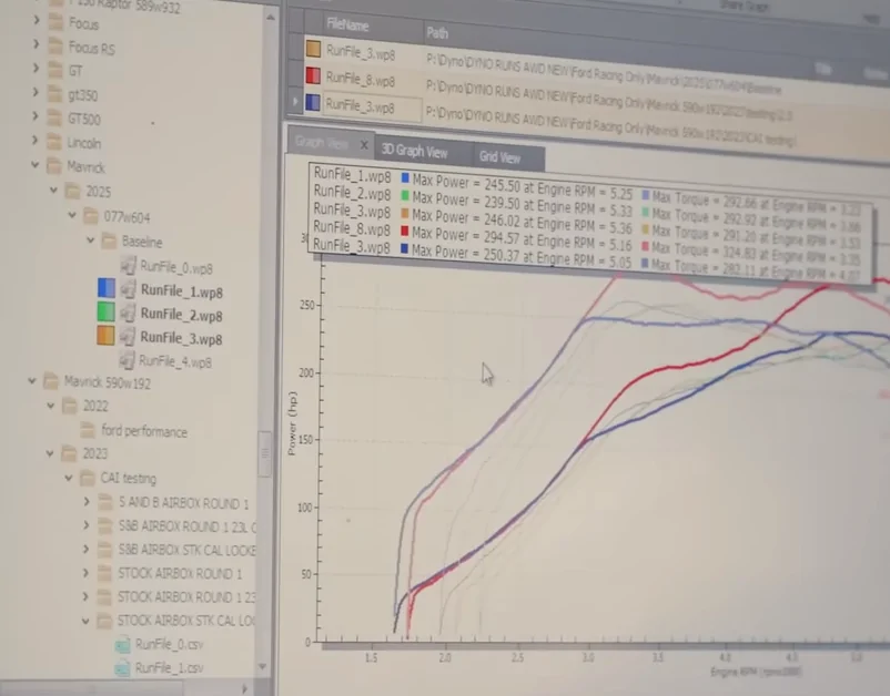

I understand that the benefits of this intercooler are largely about being able to run more boost or to have better sustained performance under hot racing/working conditions, but it would have been nice to see the actual dyno test numbers. Grabbing the screen shot below, it looks like maybe baseline was around 239-246 HP, which is what tuned Mavericks get @ the tire, so IDK what's going on there. I see one dyno result in the 290s. Would definitely like to know more about that!

Isn't the chief benefit of a larger, more efficient intercooler allowing longer sustained runs without getting heat soak and boost reduction? I'd see this as a good thing for towing in somewhat hilly terrain where you may have 3 or 4 mile climb with 4000 pounds in tow and hot weather - you don't want the engine to be backing down in such a situation.
I'm not convinced that it would initially add HP though it would help in successive runs on a hot day, no doubt.

IMO one of the problems is the factory shutters rarely let air over the intercooler in the first place for efficiency reasons. It will definitely help retain peak horsepower in conditions where it's allowed to work, however (like towing as you mentioned). Looks like a very nice unit.
I think though for most Maverick owners, a mod like this would never be noticed. Most people can't even notice going up to 91 octane fuel, so good luck noticing a more efficient intercooler. This is more for the people trying to push the limits of the platform.

I have used a CVF Titan on my F150 for over 5 years now. Generally ICs will not add power, not intended to, rather they keep temperatures under the ECU threshold of knock detection. This allows the best spark timing available. In my F150 the temperature is 115 degrees F inside the intake manifold after the throttle, IAT2. A higher IAT2 will reduce the spark advance and cost as much as 35 HP loss in my 2.7. Extra flow and volume only affect after tuning. The additional cooling from aftermarket ICs is mostly at higher throttle openings when air flow thru the IC is high. At highway cruising the throttle is not open enough to produce much temperature drop. The CVF Titan I have drops the IAT2 temp by near 30 degrees. I have logged this several times to compare with stock IC.
