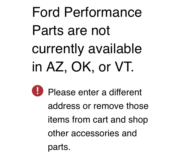

Excellent! I had to buy mine from eBay at full pop - because AZ has a law against Arizonans purchasing direct from Ford.
Anyway, my radiator is being replaced by Ford under warranty. I’ll have them swap out the OEM intercooler for the Mishimoto at minimal charge (or no charge).
Going to go from the normal radiator/fan/intercooler to the 4K Tow radiator/fan/Mishimoto:)
