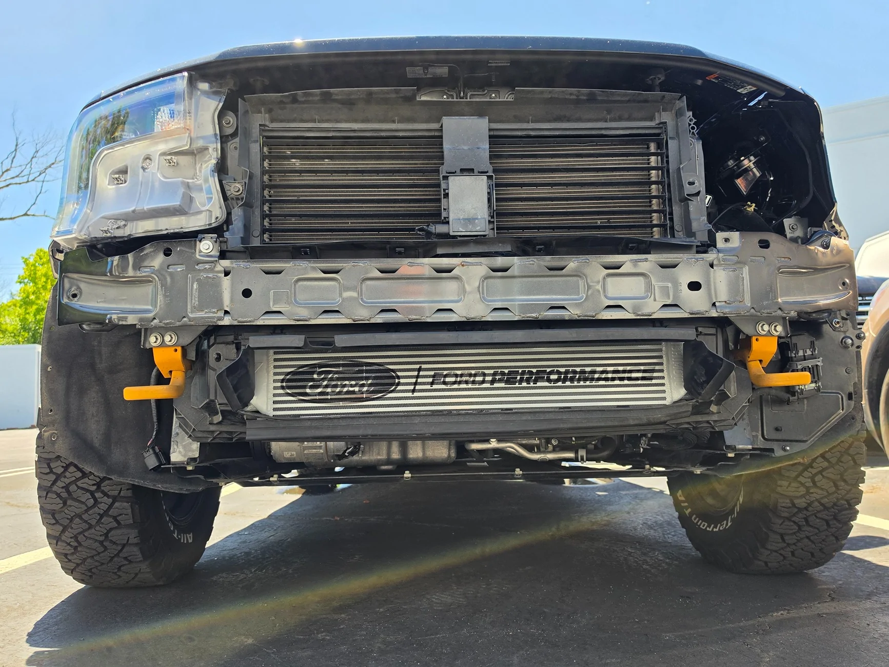

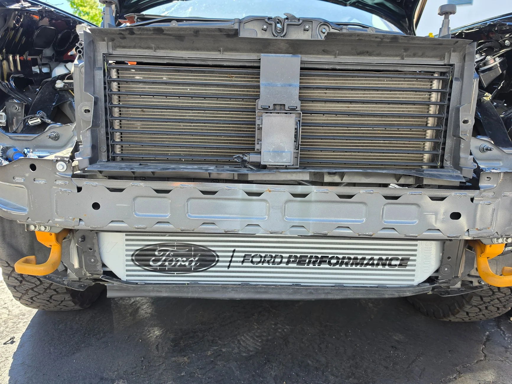

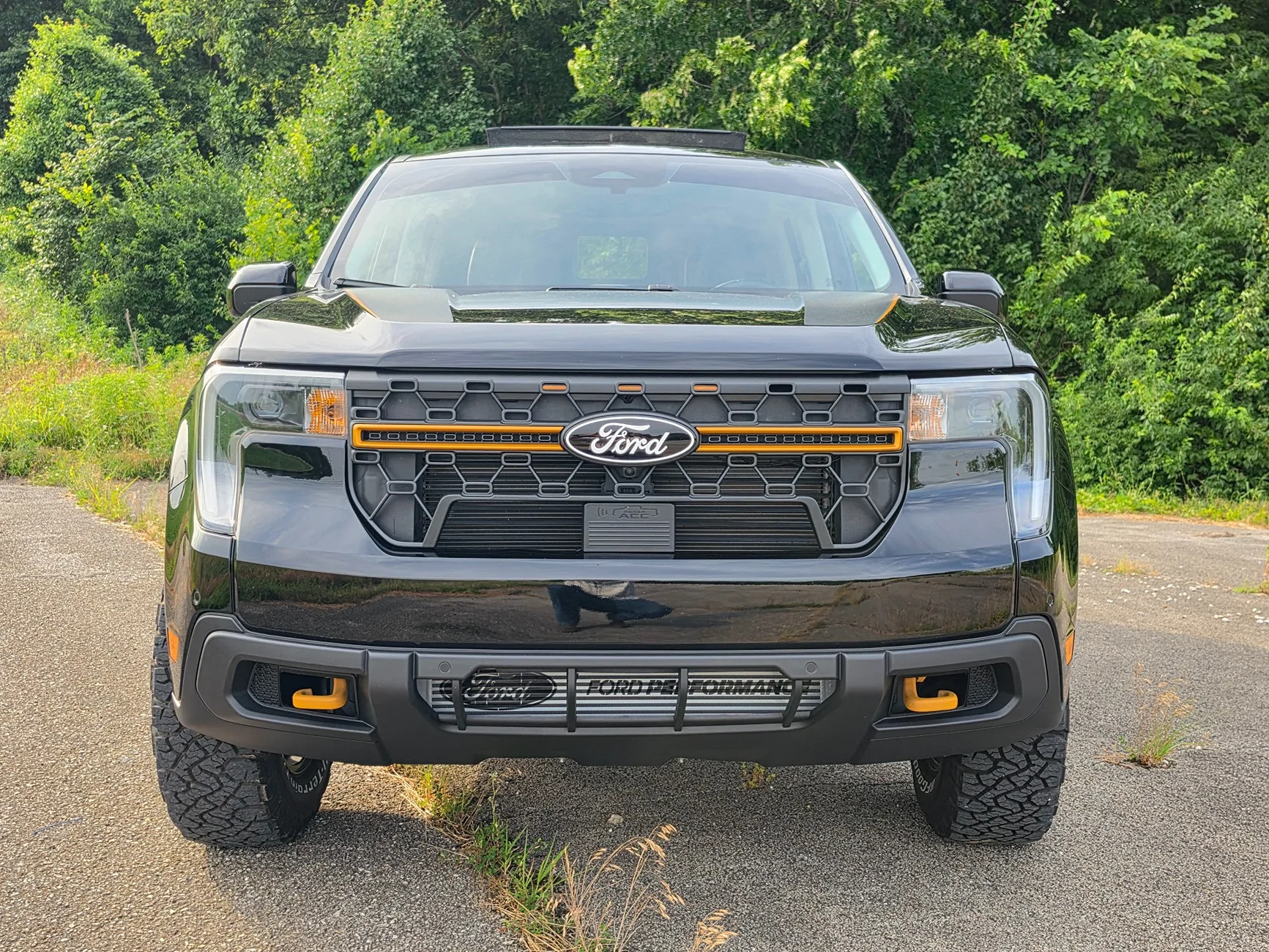

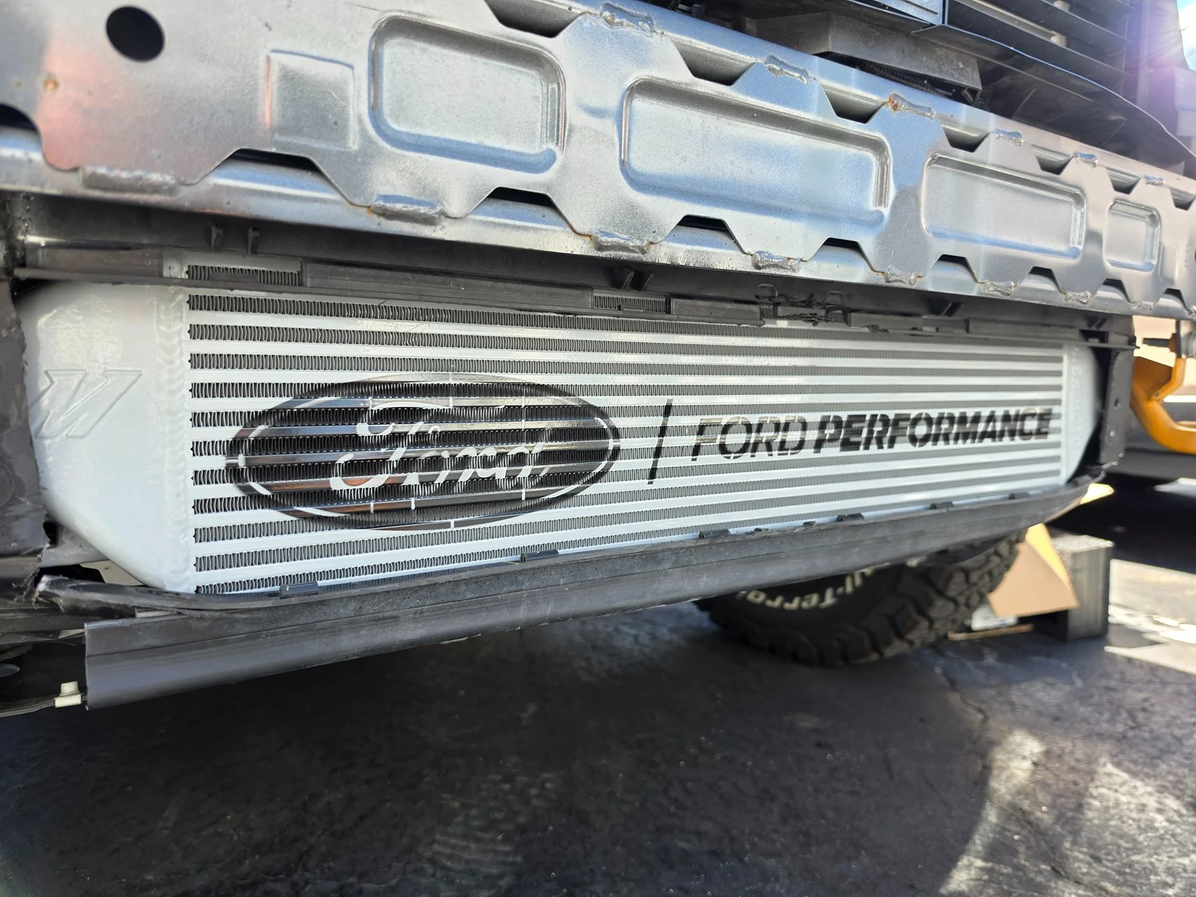

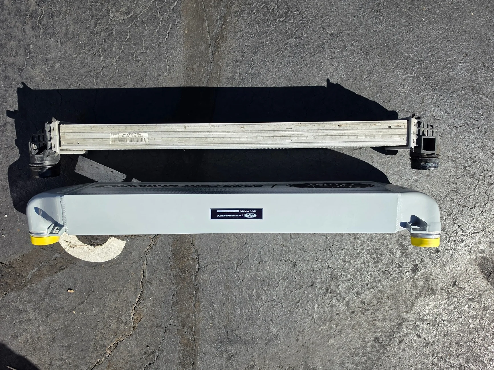

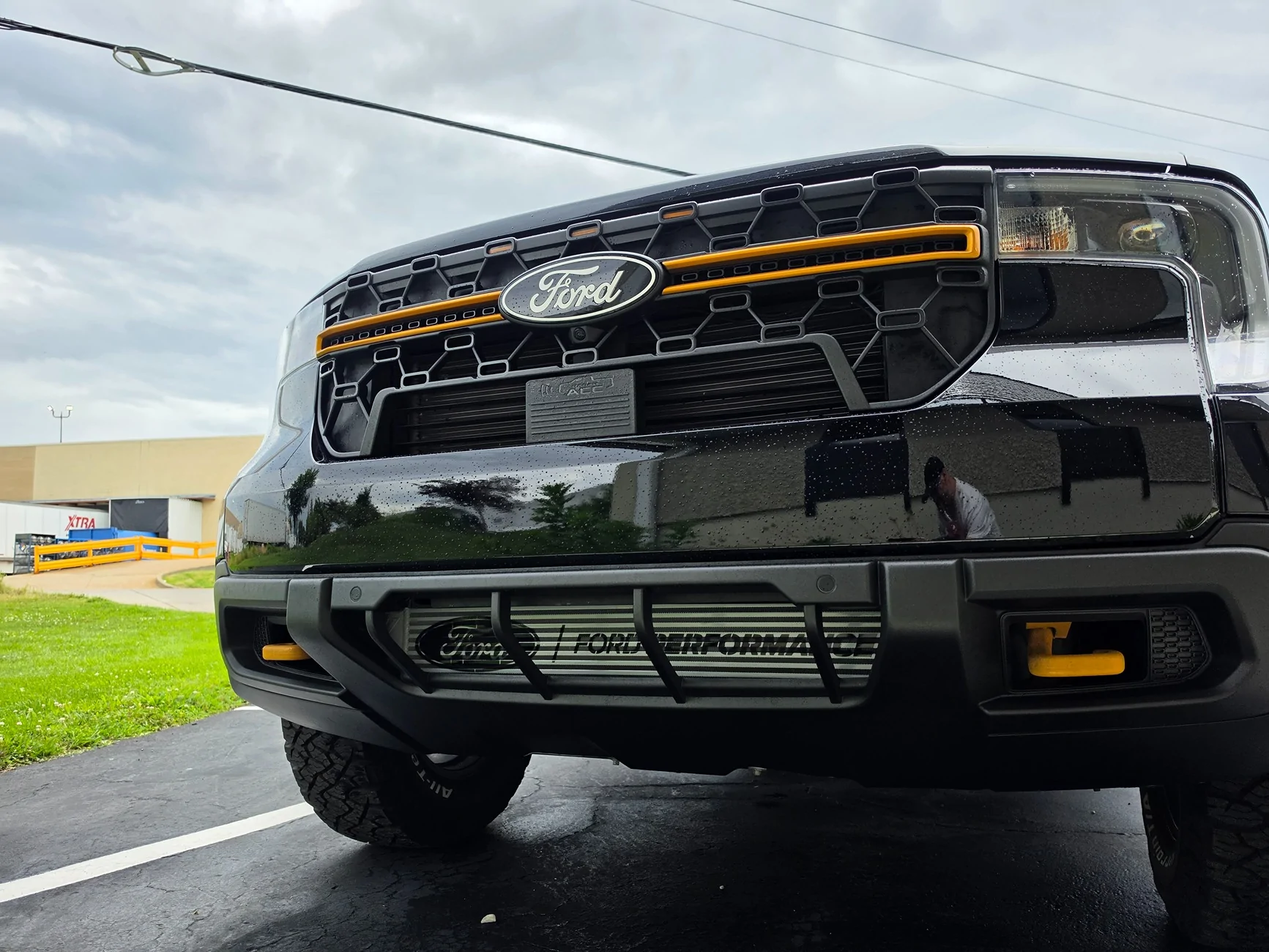

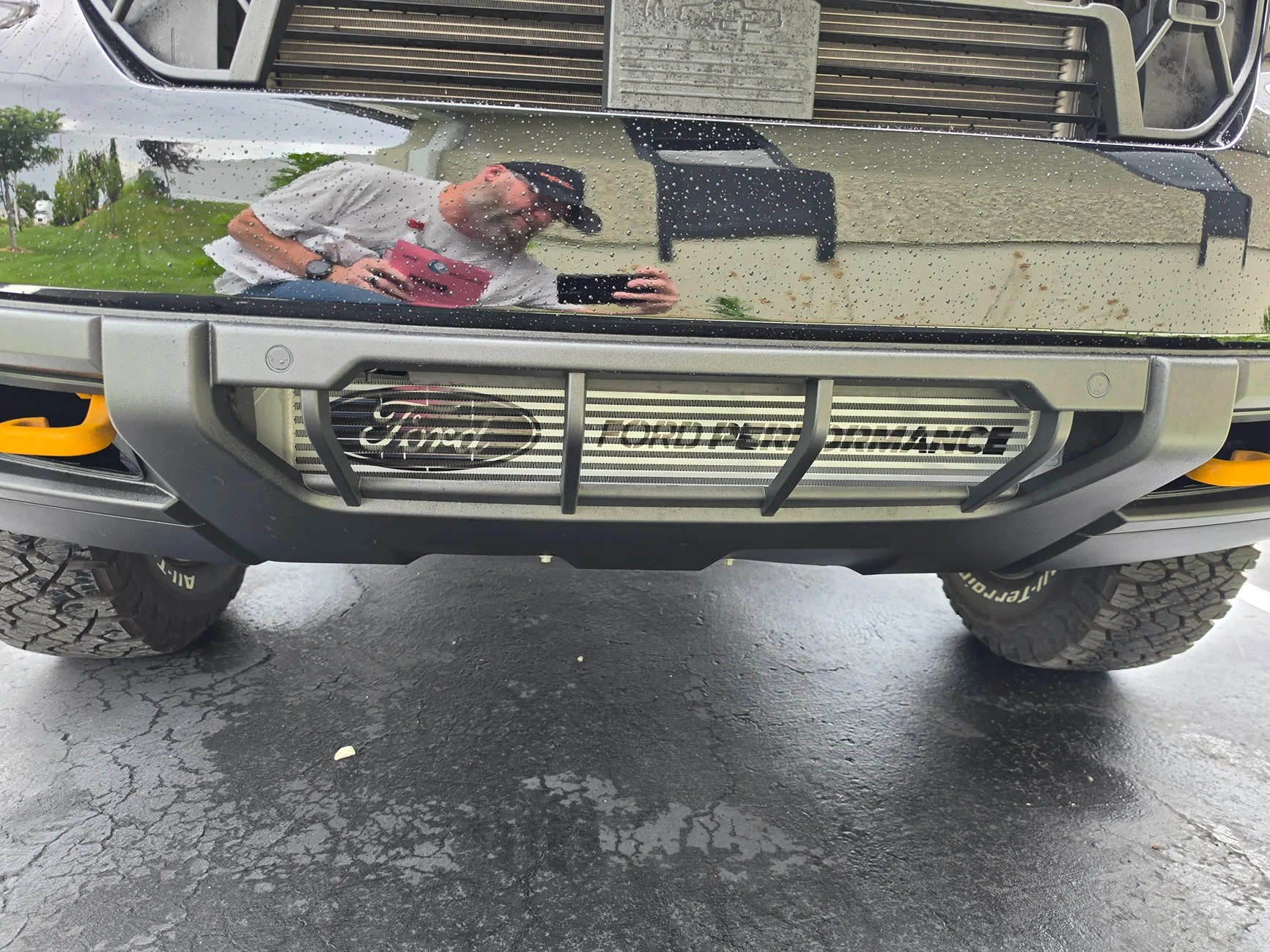

They claim it's due the the high approach angle on the lower in . The tremor uses a smaller intercooler then the rest of the models. Also the radiator is different the intercooler mounts are recessed where the intercooler hangs/mounts but it's totally doable to make it work the shutter removed and trimmed and a few band ties its works.

Do you have the dimensions of the Ford Performance inter-cooler. I've been looking for some numbers.
FORD/MISHIMOTO CORE IS 3X6
CVF CORE 6X6
Thats the only specs i have i called them when i was doing measuring for fitment , because i didnt want to cut my lower fascia and have the entire intercooler exposed , and i like things to look like they came that way , or semi factory
