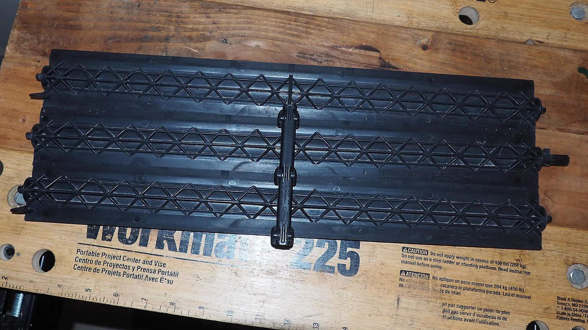

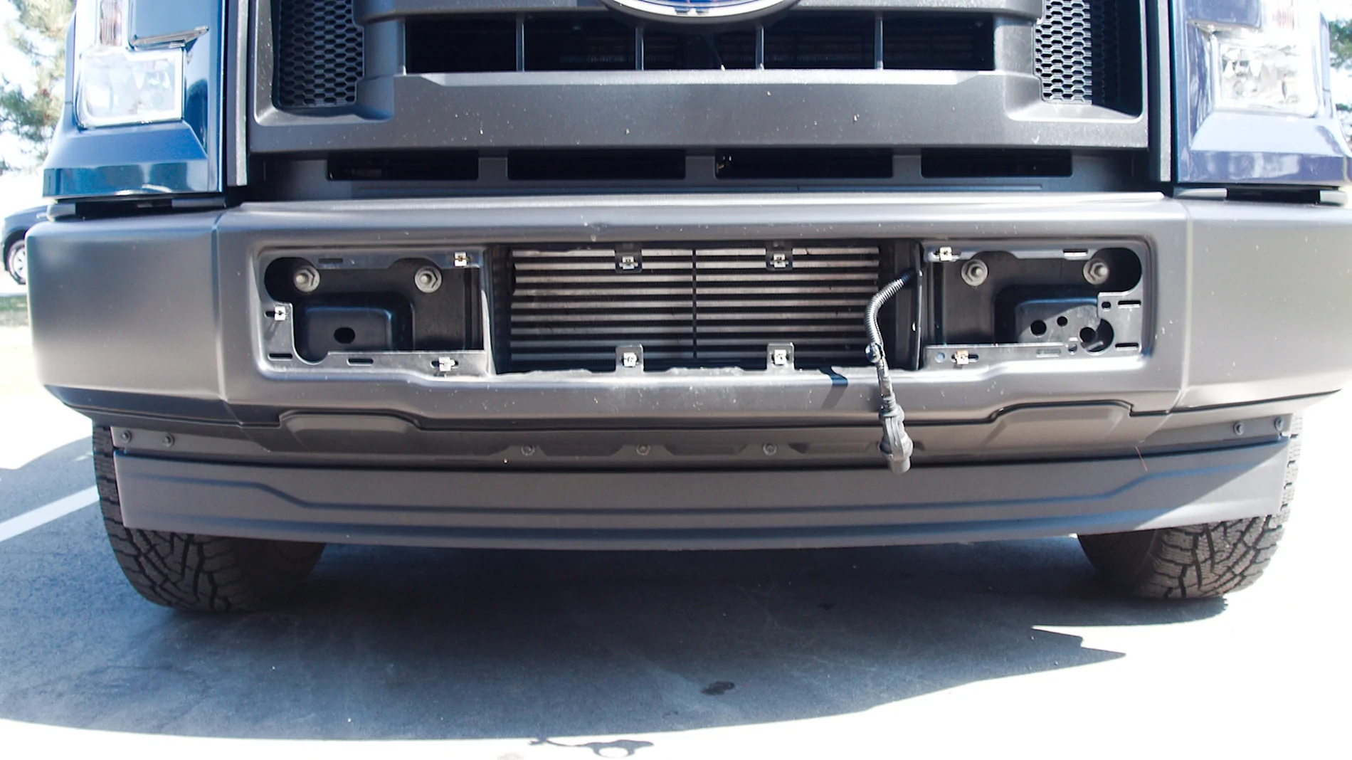

On my F150 they made, no difference, I could find in IAT2 coolant temps. I pulled them after recording a bunch of readings and on or off no change.

They have been off for years. I live in WI so yeah winter and it is not garaged. Starts fine heats up quick, no problem. This F150 peaks above 22 PSI and shows no leaks. It is nowhere near the air conditioning, and the Maverick installs seem straight forward just less room more parts in the way.
