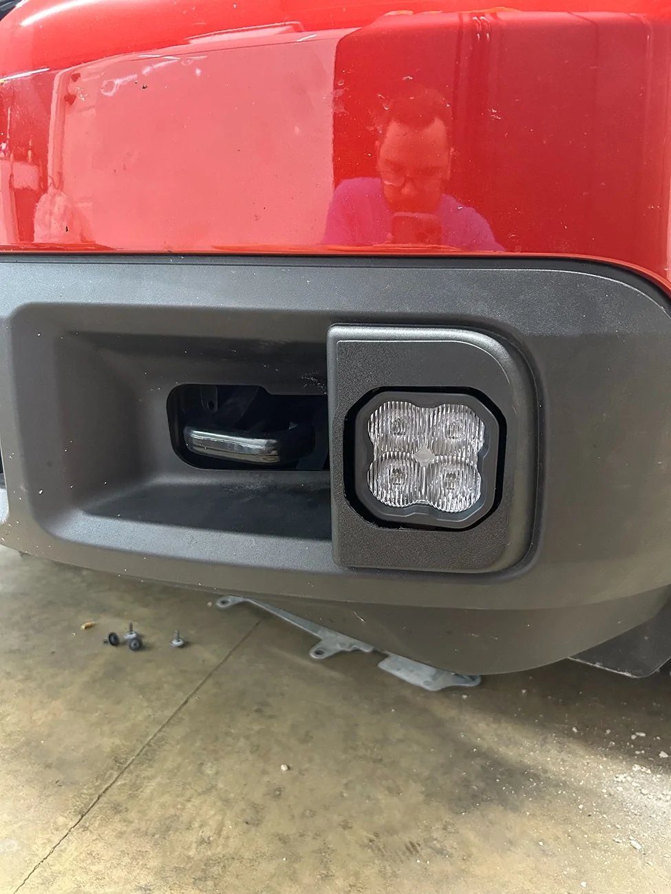

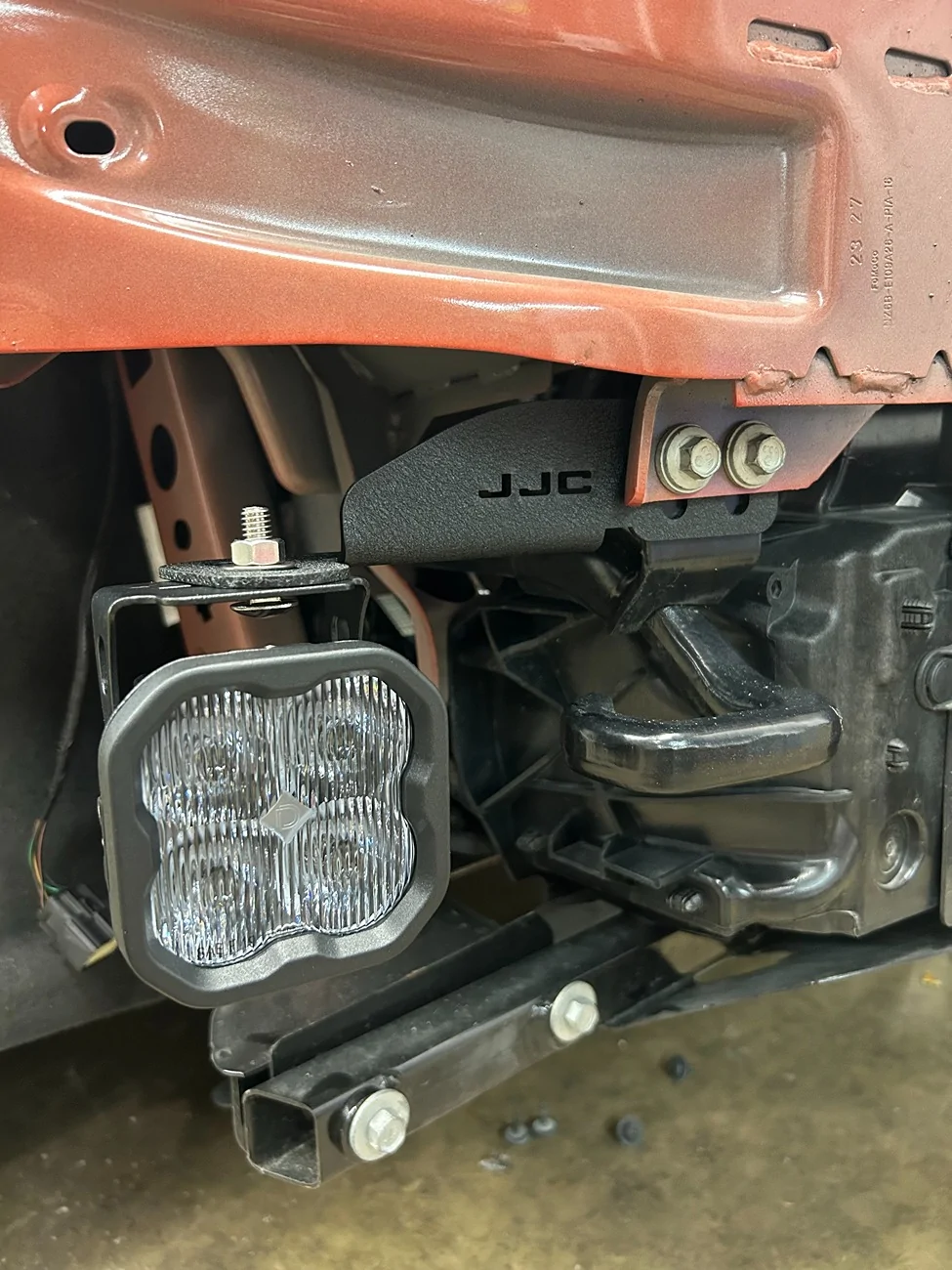

Tons of adjustment in these brackets, so it takes a bit to get them exactly how you want it. I left mine angled out a little to match the curve of the bumper.
Ford Maverick FX4 Fog Lights Detailed Install, Diode Dynamics SS3, JJC Brackets Photo Sep 13 2024, 8 03 35 PM

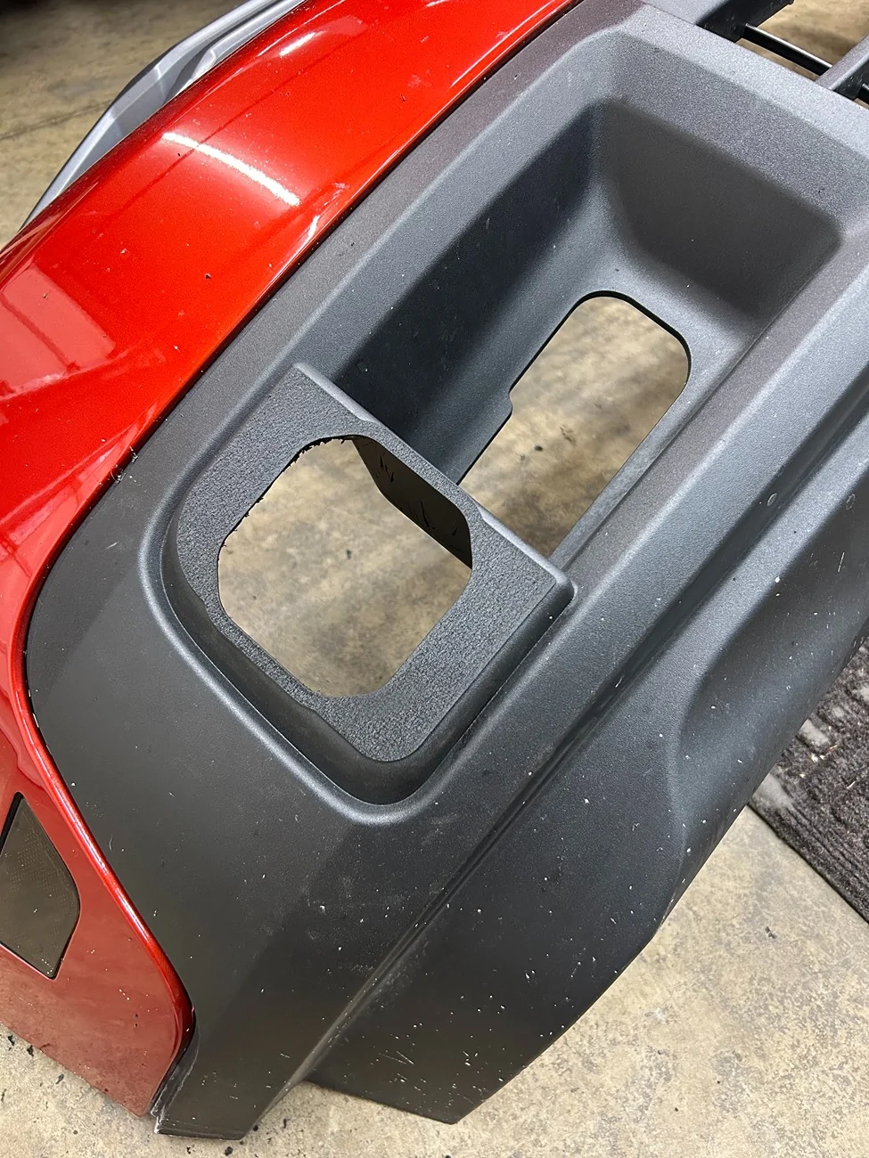

Cutting the bumper made me a little nervous but the JJC bezels give you some room to work with. A dremel works perfect for this. The bezels have 4 bolts that get secured from the back side.

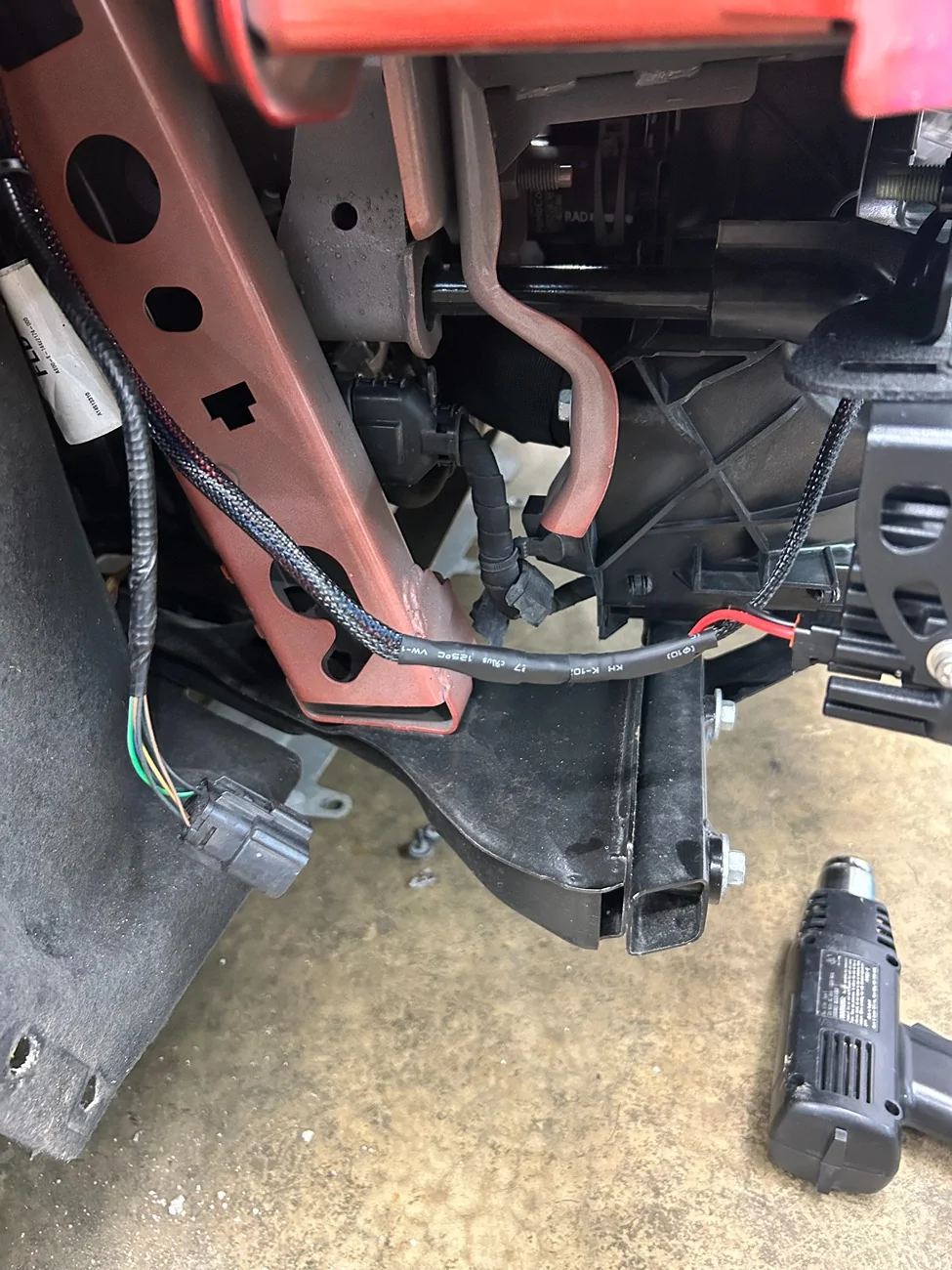

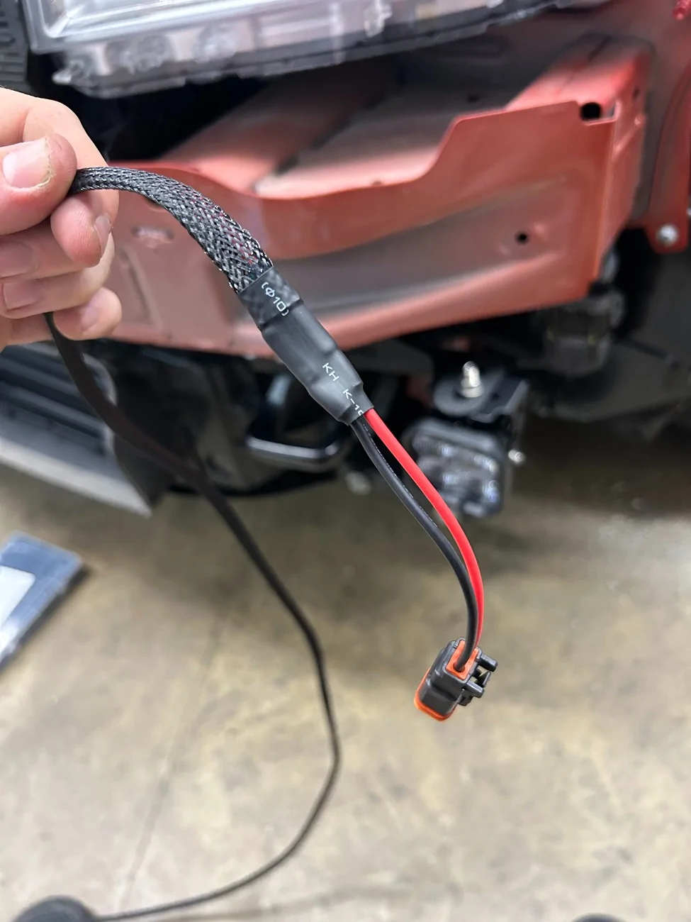

Made the harness myself. It was pretty straight forward. Since the brackets attach to the frame you can tie up the harness to the other wires without having to have slack for removing the bumper.
Ford Maverick FX4 Fog Lights Detailed Install, Diode Dynamics SS3, JJC Brackets Photo Sep 13 2024, 11 30 52 PM

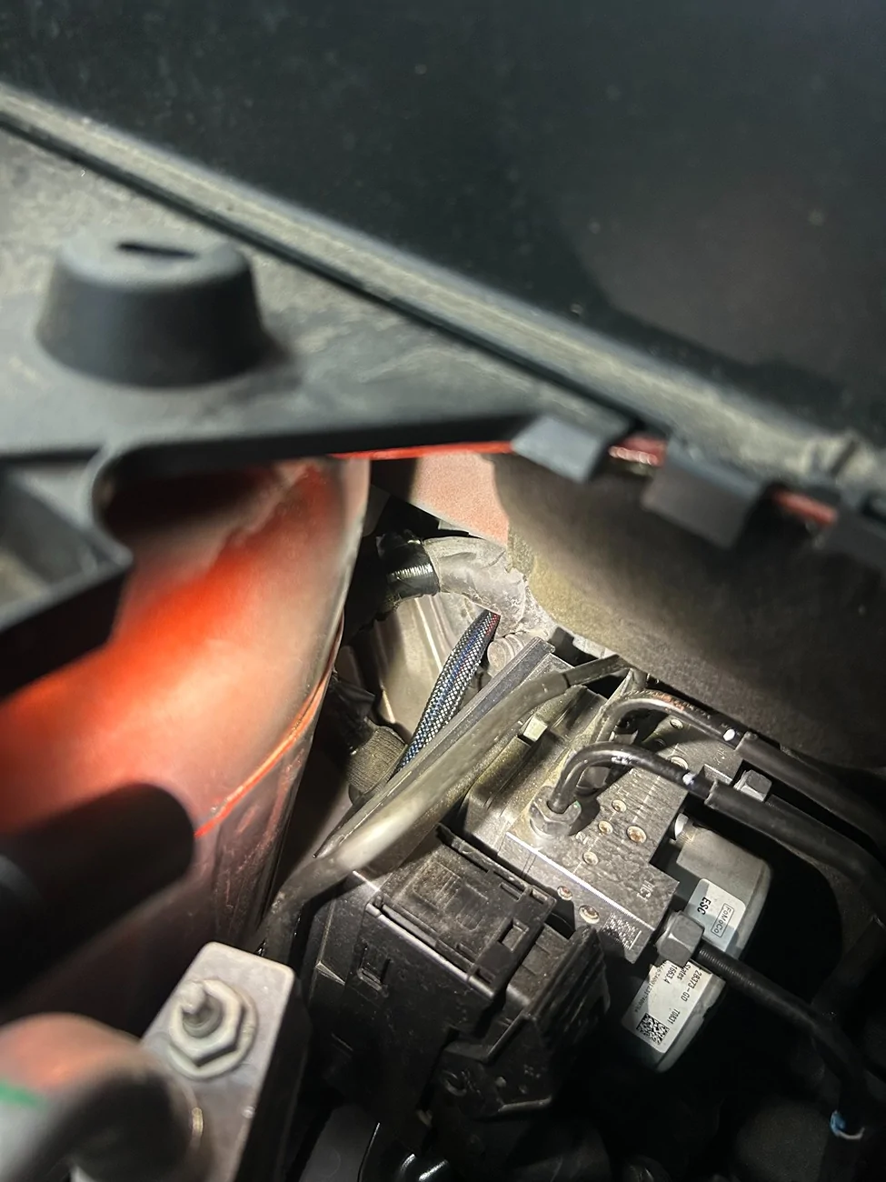

Ran the wire harness through the grommet on the passenger side and down to the BCM

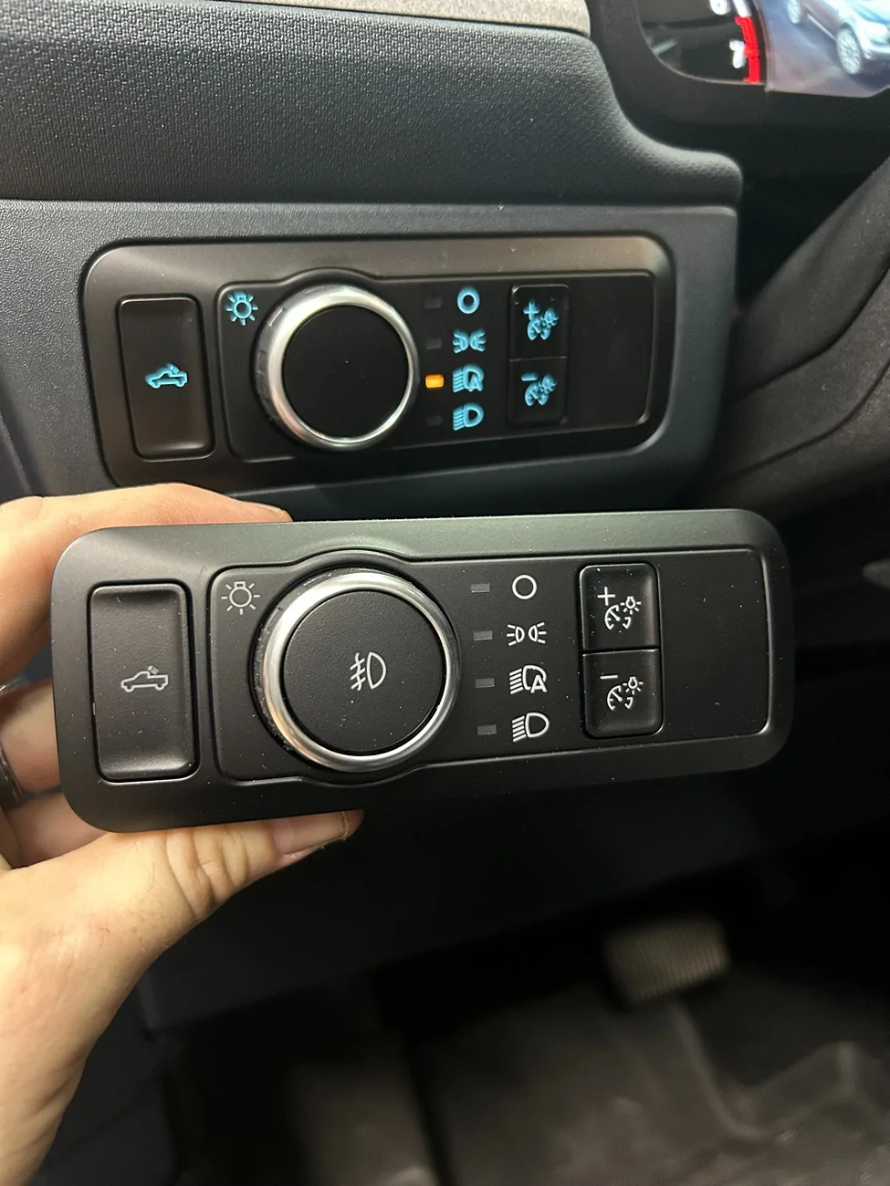

Next swapped the headlight switch for the F150 one so I can have the fog light button, with an oem look. Simple as popping the old one out and plugging the new one in.

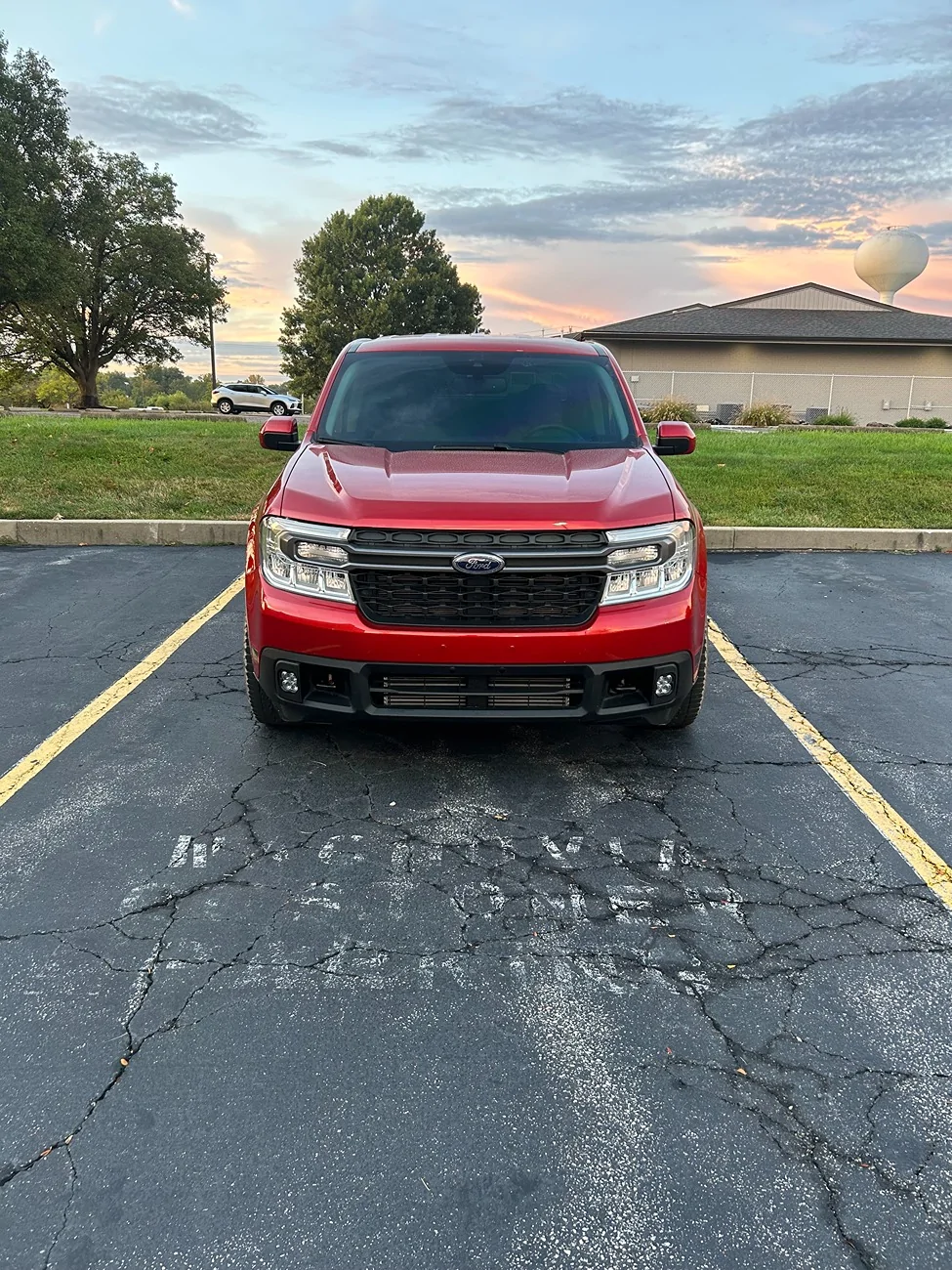

Finished product
