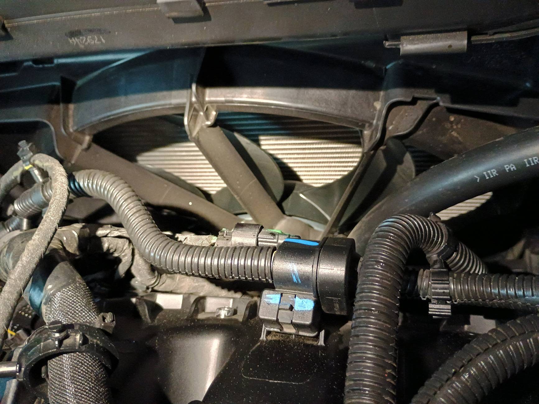

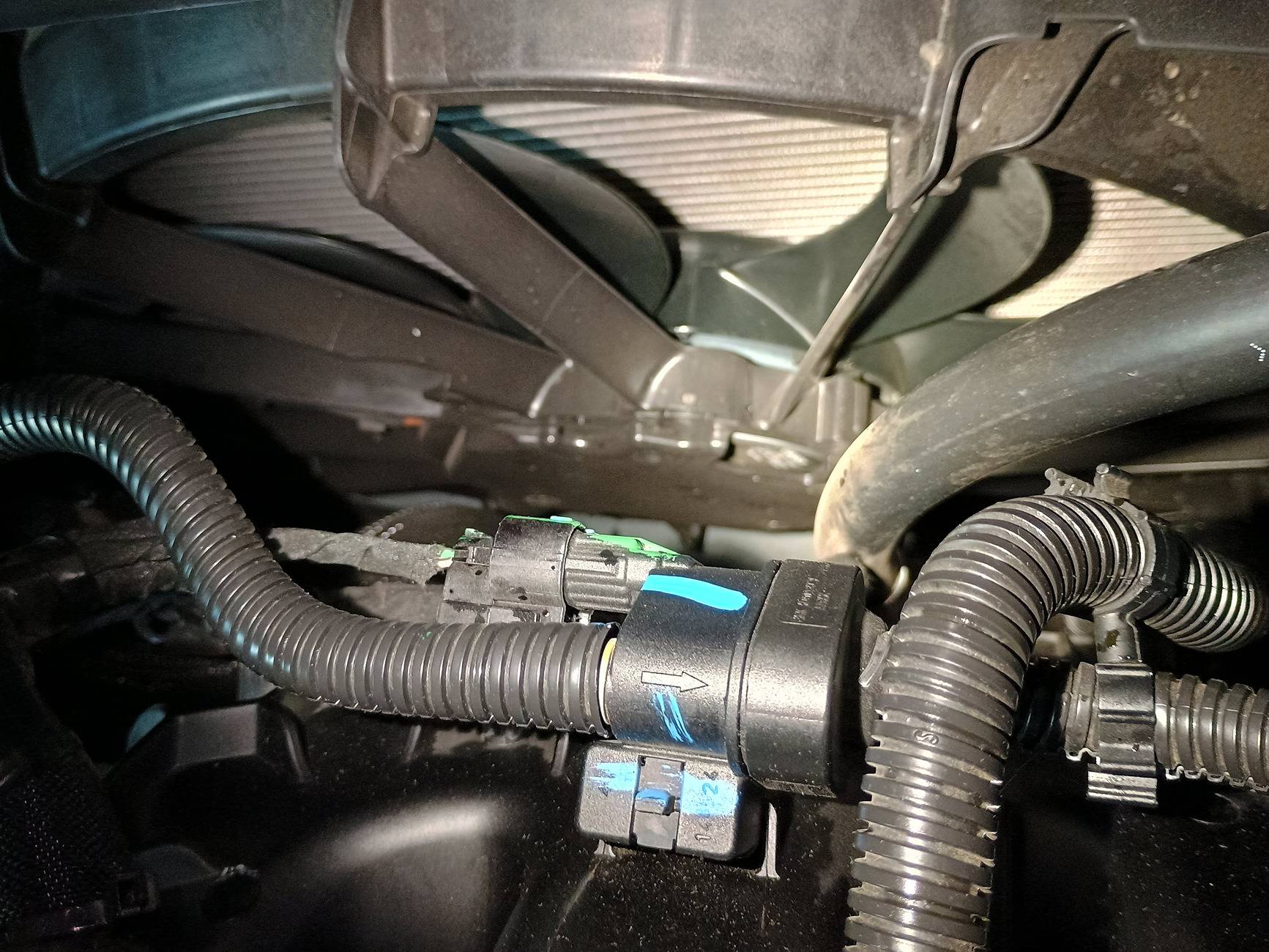

Here are pics of the EB 4K tow fan and supplemental cooler line attachments that I promised. I kept waiting for a better natural light pic but the sun hasn't cooperated lately so these will have to do for now.
Ford Maverick 4k tow package Drive ratio, cooling and radiator fan percent difference recource/discussion IMG_20250428_181802933_HDR
Ford Maverick 4k tow package Drive ratio, cooling and radiator fan percent difference recource/discussion IMG_20250428_181954773_HDR
Ford Maverick 4k tow package Drive ratio, cooling and radiator fan percent difference recource/discussion 1746471824770-j2
