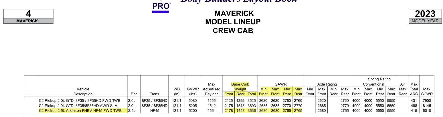

I've been trying to find the front and rear axle loading for a Maverick hybrid. I've searched for the ratio as well as the actual weights to no avail. Can anyone help me out?
FWD Hybrid
2300 Front
1400 Rear
so... 62% Front and 38% rear.

Thanks, exactly what I was looking for.

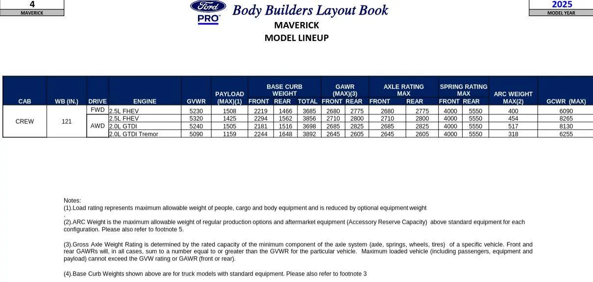

I searched but could not find the same information, front & rear base curb weight, for a 2025 hybrid AWD. Could you provide it?
We were just talking about this today in another thread, so I went looking for the 2025 BBLB:
Ford Maverick Axle loading (ratio / weights) for hybrid Maverick? Screenshot_20250612_193939
Base AWD FHEV Curb Weights F: 2,294 R: 1,562 Total: 3,856. Options like moonroof, tow package, XLT/Lariat Trim options will increase the curb weight over the base number.

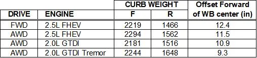

Thanks for your research. It's interesting to see how the center of mass changes, and that the Tremor has the most even weight distribution. For fun, I ran a quick calculation on where to put your floor jack when lifting one side of the truck, expressed in inches forward of the midpoint between the axles.

HUGE THANK YOU!!!
Sorry for the delay. Just getting back to ā€˜normal’ after a little anniversary road trip.
TONS of great information in this document! Would be great if all years were available as a sticky post for reference.
