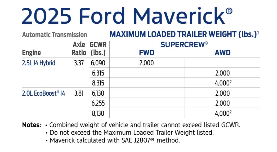

im assuming ur Mav is an ecoboost from ur account flair you will be gettting 238hp
Also here is the graph for the 2025s
ur Mav should be the 8,130 one
Check the driver side door jam when you get it, it will give u ur towing specs.
Then subtract the 4000 tow capacity and the maverick dry weight and that will give you how much weight you have left for fuel, people and cargo.
Down graded HP and torque nubers wont happen till after June or so if they do. 2025 eco's have 250 hp now

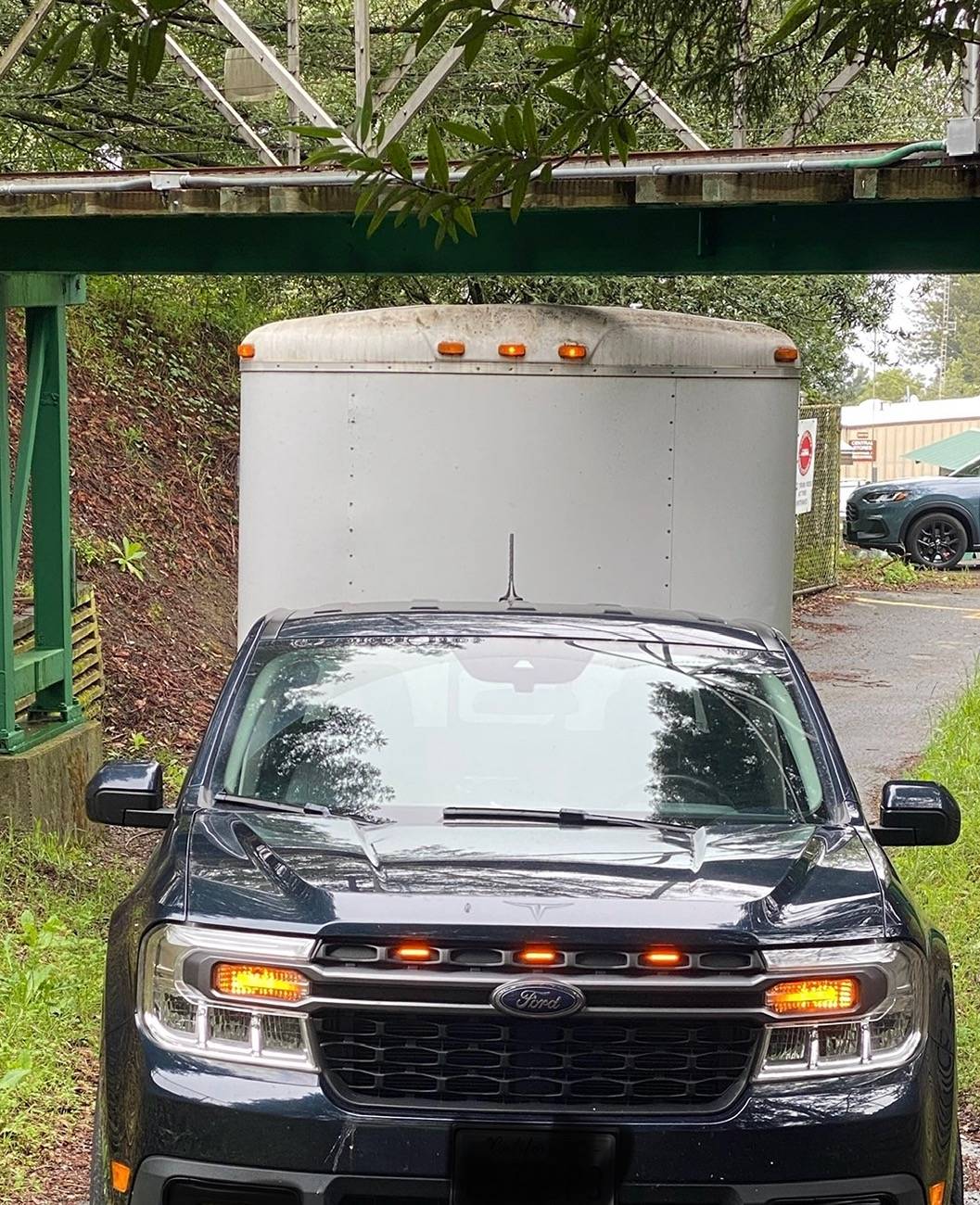

I have a 1500 lb side by side OHV in this 1500 lb trailer, add in a couple of spare tires and accessories and I'm 3200 lbs all in.
I have electric brakes and an after market brake controller in my HYBRID.
Wind resistance is a killer to gas milage. But with a parachute like this, I hardly need to brake at highway speeds. I don't exceed 65 MPH.
Nets 18-20 MPG depending on conditions.
The heavy weight is most apparent at slow speeds because regen is less and engine brake is less at lower speeds so trailer brake is essential.
Barely made it under this bridge in a park.
Yeah, the vehicle I’m looking at is the Eco boost version all-wheel-drive with the 4K tow package. My trailer is open galvanized steel 14 foot long with a with a spare tire mounted to it. my Can-Am weighs 1700 pounds. I don’t know how much the trailer weighs.
It sounds like it won’t have any issues handling it. I know when I tow with my current vehicle the Jeep Cherokee Trailhawk I swear I could just watch the gas gauge continuously drop.
