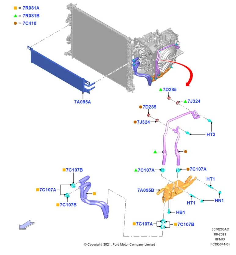

Here's a diagram showing the 4K water to oil trans cooler in yellow and the air to oil trans cooler in dark blue. I believe the front cooler mounts between the radiator and the condensor (pictured) and the only part of it you can easily see under hood are the hoses and the inlet/outlet connections.
Interesting, there is a diagram for the 2.0L which you showed, but there isn't a diagram for the 1.5L cooler. All i see is an error
I also find it interesting that the trans oil cooler radiator covers about 1:4 of the engine radiator. Maybe its all evened out with the dual 25” cooling fan assembly on the opposing side.
That's pretty normal. I've added aftermarket transmission coolers to a several vehicles, and this is a very typical size, even for a full-size vehicle. The transmission doesn't generate nearly as much heat as an engine, so it doesn't need the full surface area of the radiator. The smaller the trans cooler is, the better the flow for the radiator and condenser. And of course in this case it's only supplementing the water to oil cooler anyway.

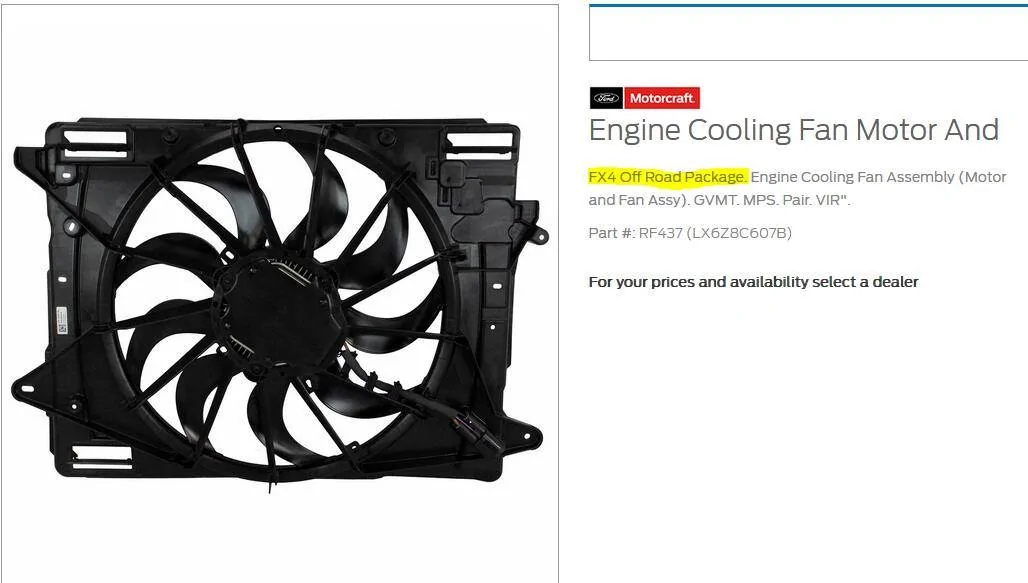

Anyway, the reason why i say dual is because the non 4k has a 43” Lengthwise fan assembly while the 4k, and tremor have one that is 25”. Which didn't make sense to me. If you go back to my original comment there should be a link to both. You can see the dimensions on one of the dropdown bars below it.
oh wait hold on there are three i think this one is the non 4k
Here
the 45in is the fx4

Oh, I see. I think you have the links reversed. They are both single fans. Note that the one you have linked for 2K says "FX4 package". The FX4 has the same cooling fan as the 4K tow package. Both of these fans have the same size shroud, so you can tell the difference in the size if you assume it's a single fan. This one looks like my FX4/4K tow fan. The other one you linked is definitely smaller.
ah ok i edited my original first comment. And listed all 3. The Tremor has a weird one though its taller than it is wide which now makes me think there is two of them on the tremor.
