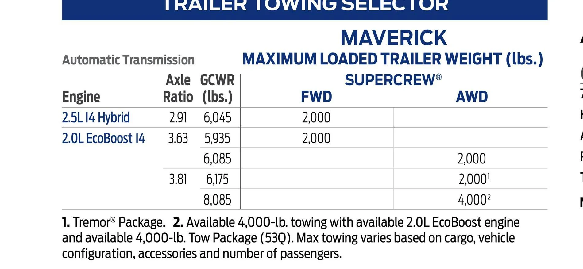

Yes, GCWR is very important to understand when towing. Eco fwd have the least payload amounts. This is the best resource for it before you get ur maverick. All ur personal towing info is in ur doorjam. On a sticker.
This is for 2022-24 mavericks

Ok so the 4k tow offers 3.81:1 rather than the standard 3.61:1.
But the difference is less than 5 percent (4.96)

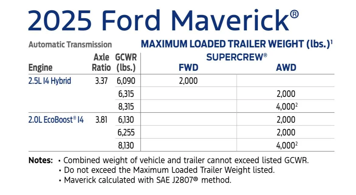

I looked this Trailer Towing Selector up for the 2025 Maverick and it shows only the 3.81:1 Axle Ratio for the 2.0 Eco Boost and AWD and No 3.63:1 Axle Ratio?
Tbone289
Terry
Jul 18, 2024
2,099
3,594
MO
That's correct. For 2025, the 3.81:1 final drive ratio has been standardized for all Ecoboost models.

It is odd that you cant get a fwd Ecoboost anymore too.
And now the hybrid has a 3.37:1 and almost 200 more lbs GCVR capacity than the eco with 4k.
